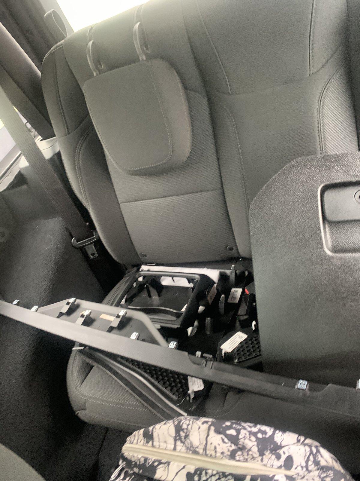

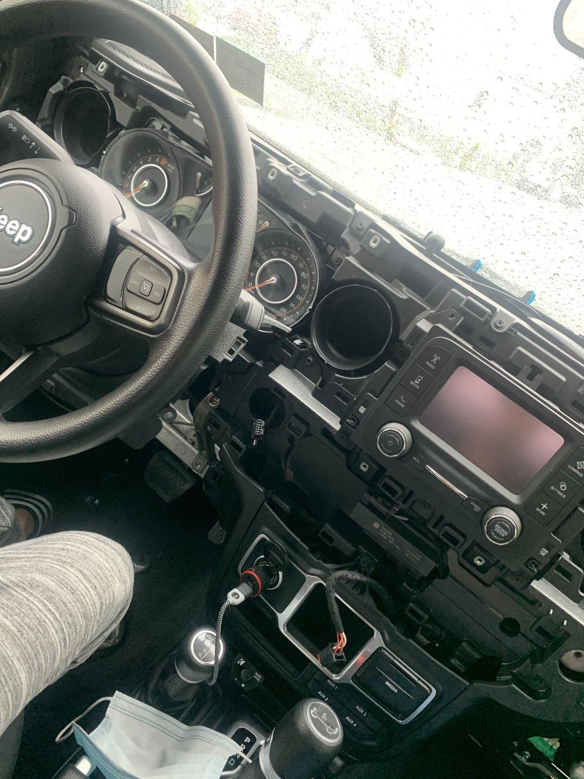

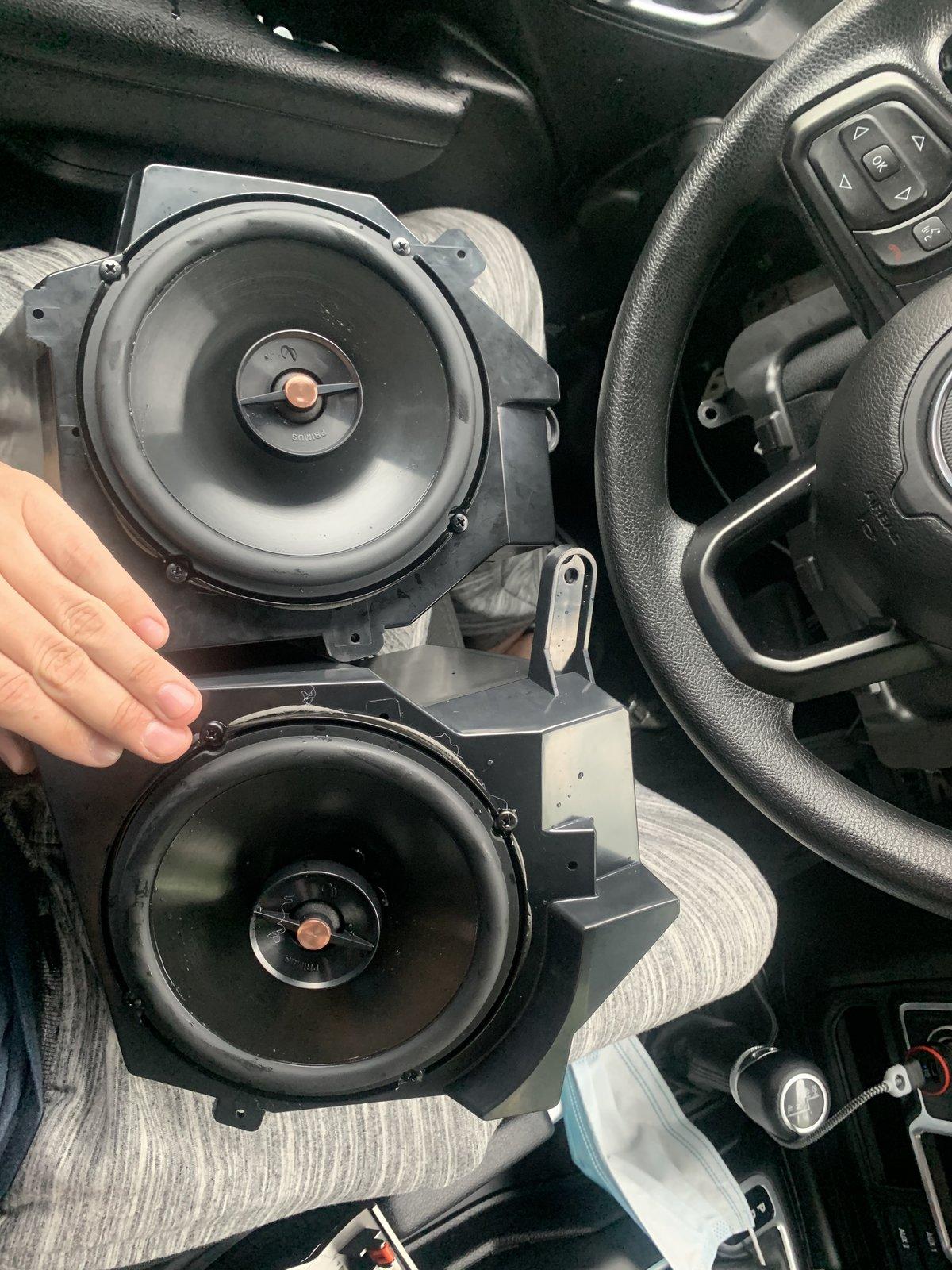

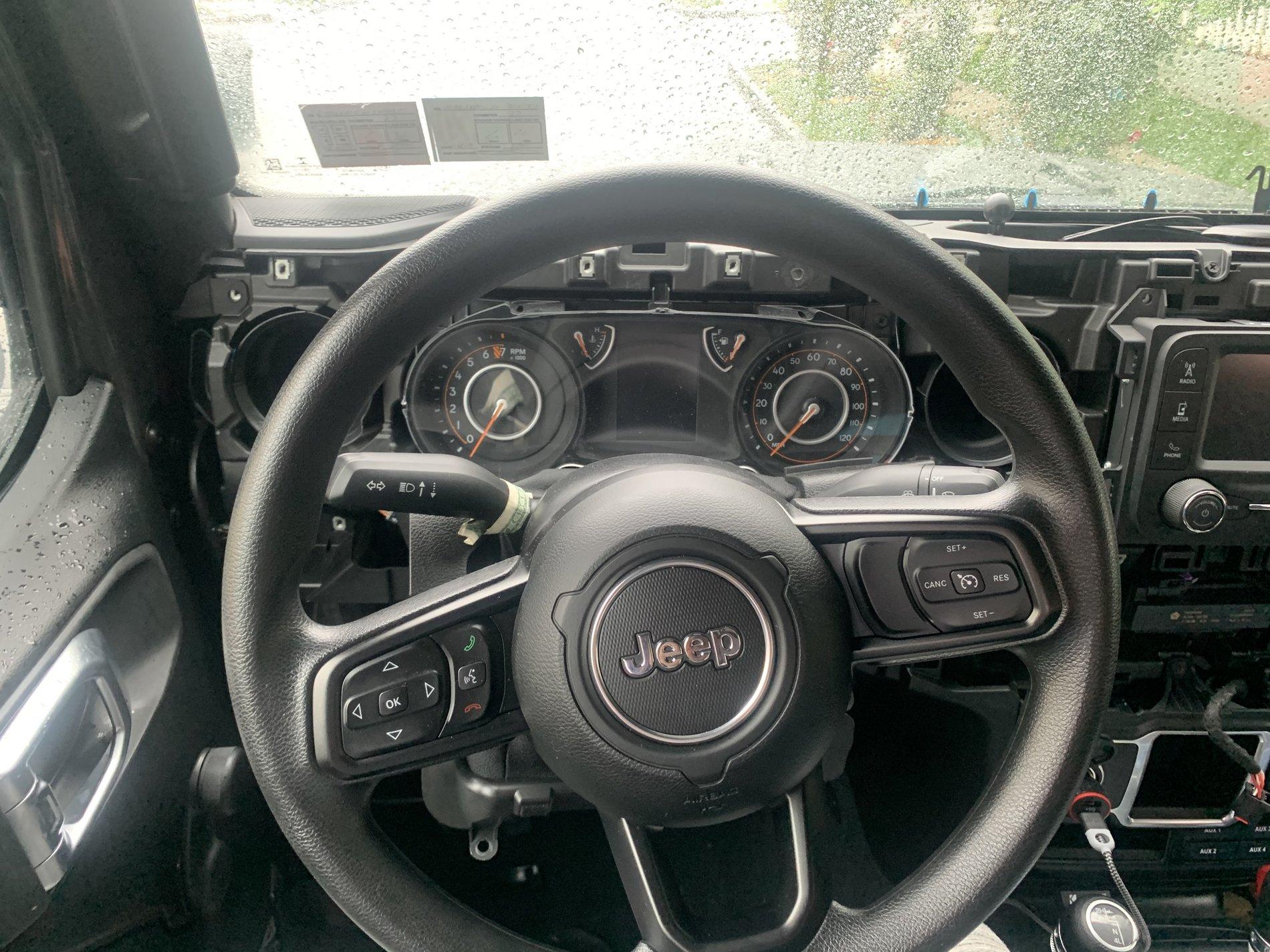

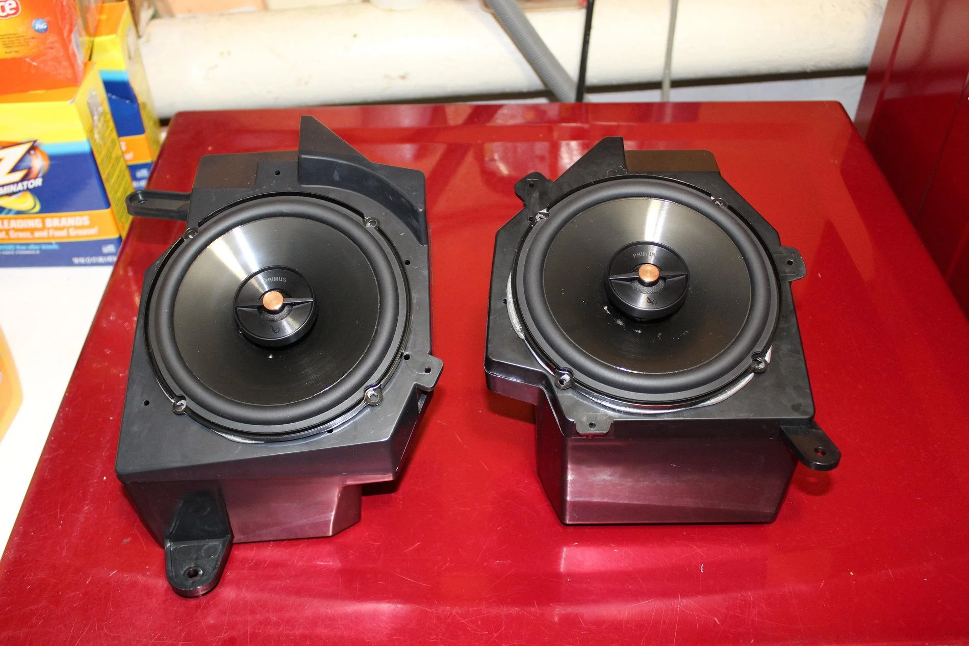

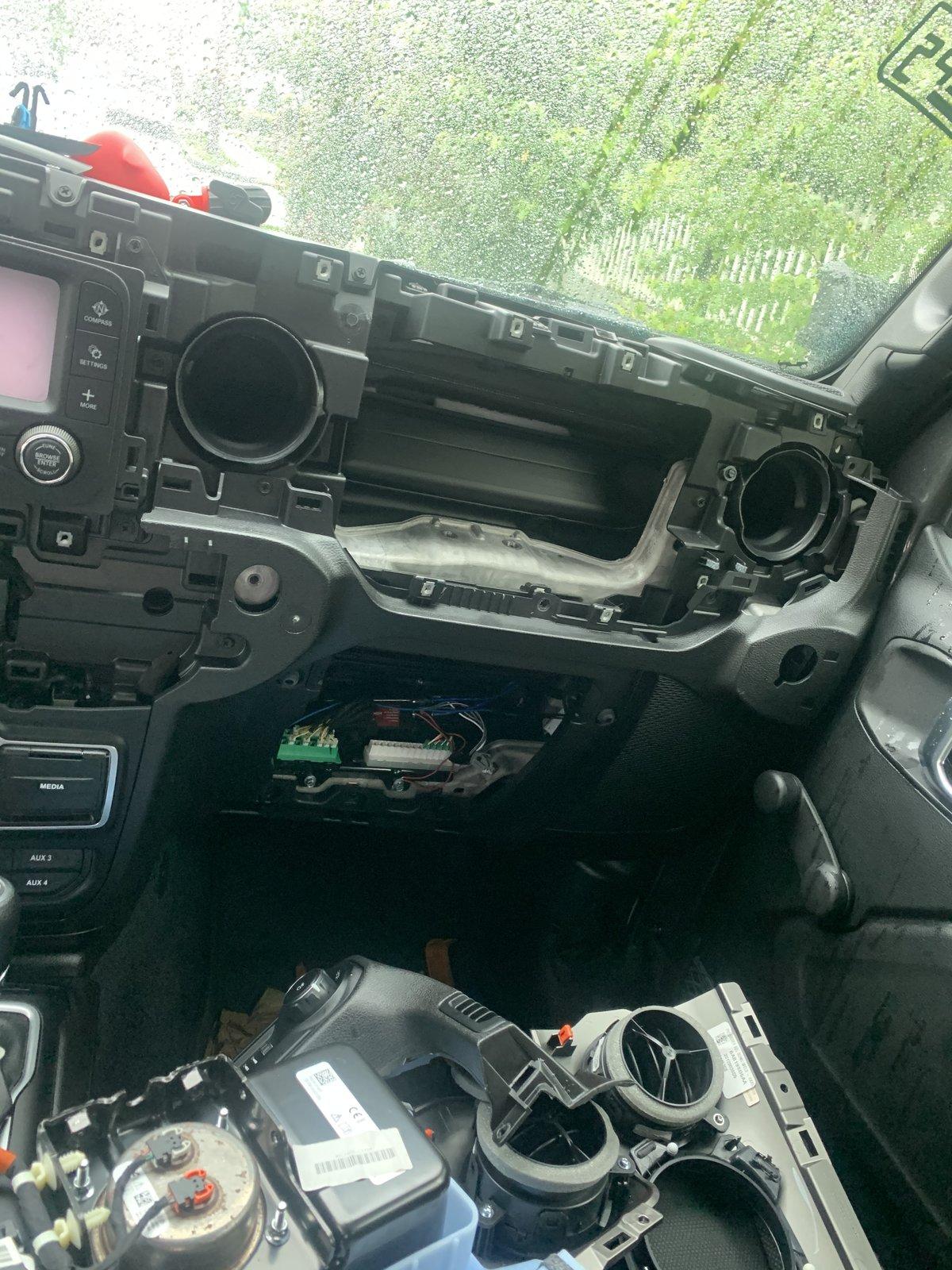

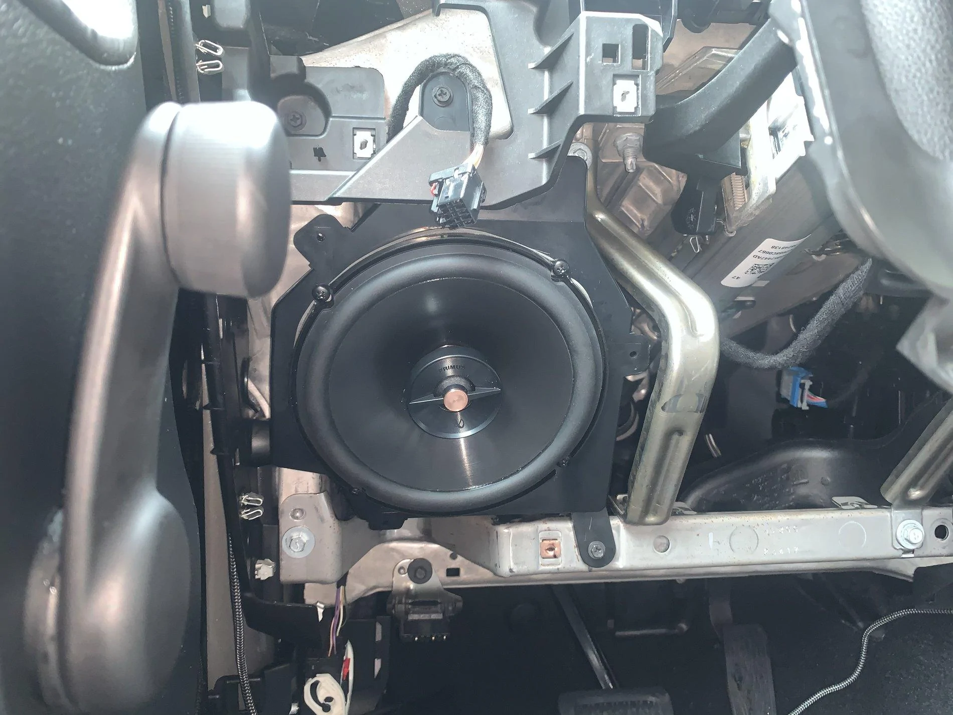

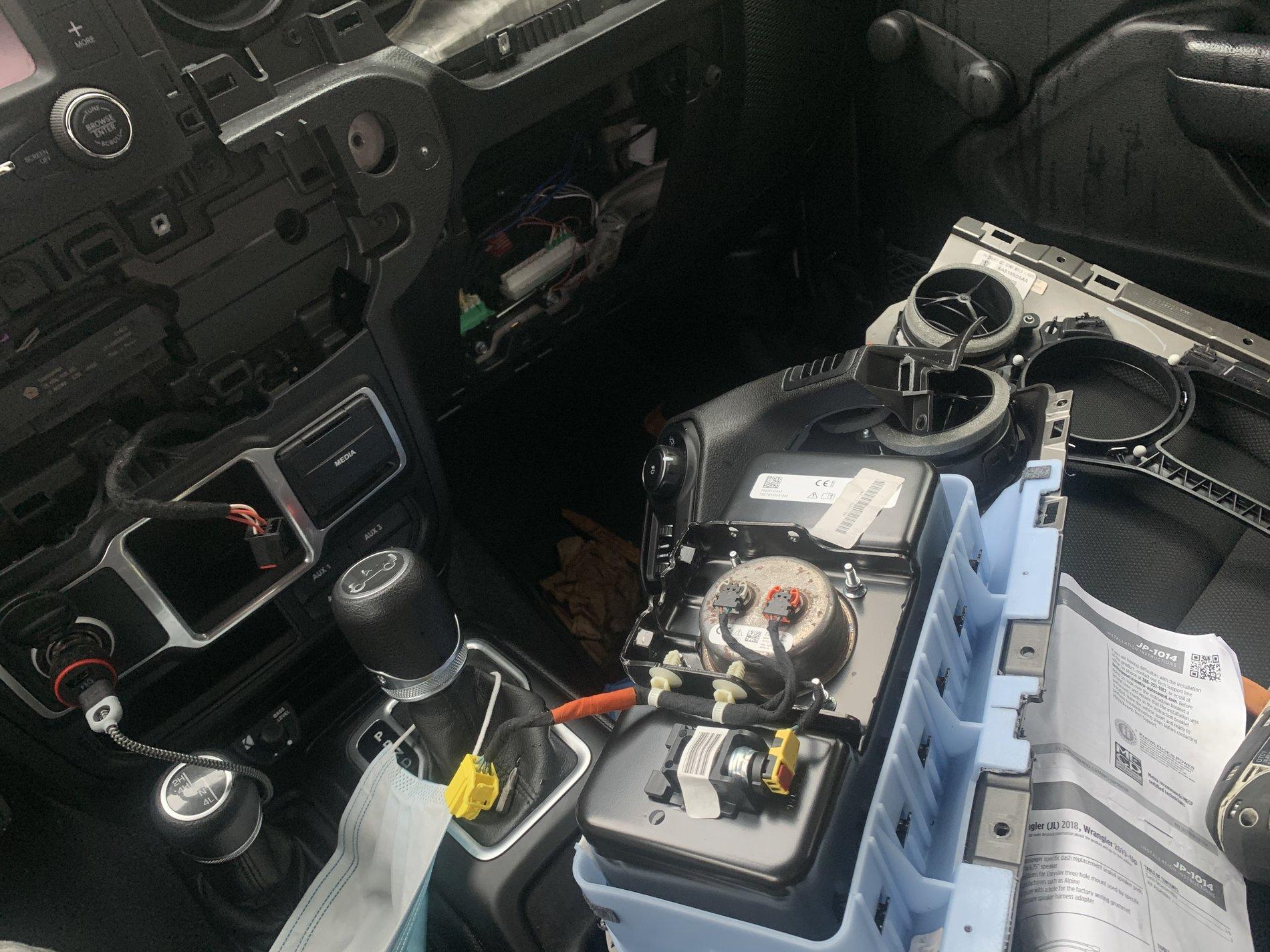

I gotta say it’s a huge difference and idk why alpine doesn’t switch those knee panels out from the video I saw but what a difference. I put infinity primus 6.5” speakers in and I could turn my factory radio all the way. Sounds like a full sound stage. Process was time consuming but not hard at all. Any rookie can do it. this was easy and well worth it. Metra gives you the instructions and a plug and play harness. If your considering it or want to do it I highly recommend it. I replaced 4 speakers so far all dash and the sound stage is really great!

Honestly. I’m 23. Never worked on a Jeep. Only Honda’s. This is easier to pull apart and do. I do recommend a open end 7mm wrench. There’s 4 philips style bolts that where a pain in the ass to get out simply because there in a tight spot. There’s one on each side panel/ bottom of dash and one right next to the obd2 port. Same for passenger side. Would be the only way I found to remove those 3-4 bolts. Other then that a 8mm socket short. 10mm socket short. 13mm socket with about a 6 inch extension. 2 pry tools and about an hour of time and enough space to open both doors. Make sure you polyfill the enclosure as it does make a slight difference. Other then that it sounds great. With an amp even better. Think you’ll be happy. It’s really easy to do just time consuming. It’s not hard at all it took me 2 hours to do cause it was raining and I had to keep stopping untill it slowed. If not I’d give it an hour max. And once you have the speakers in you can always just run an amp to it easily after the wires extend pretty far out
