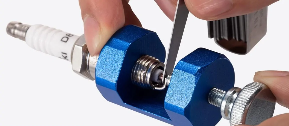

T.T.T. always check the gap and if you have to bend the Ground Electrode use this type of spark plug tool so you won't damage the Central Electrode.
Jeep Wrangler JL Spark plug specs help? Spark Plug Tool

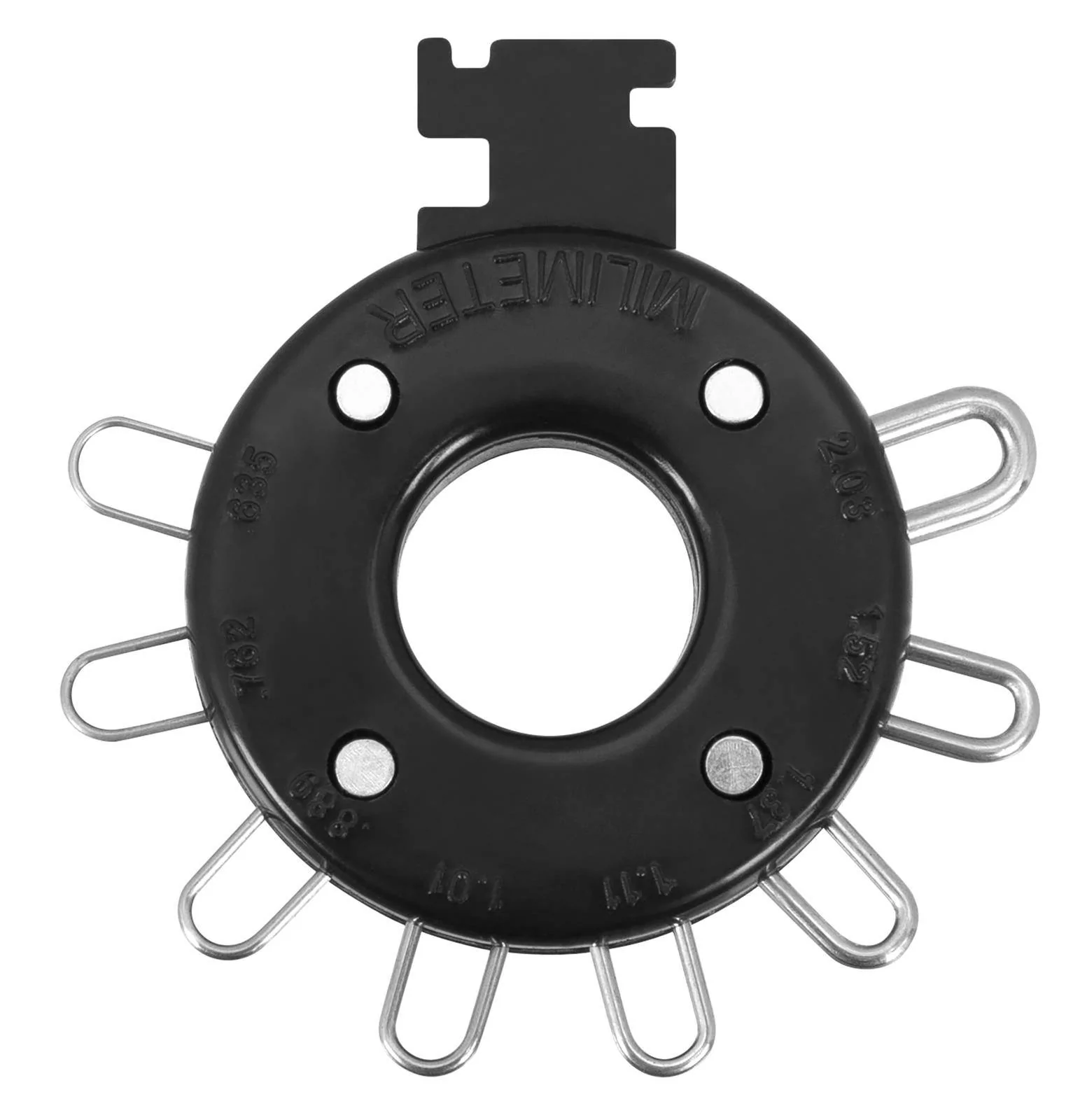

I like a screw type adjuster. Gives more control so you don't overshoot the gap you wanted.
This one is a Amazon cheapo. But there are as many types of these as there are spark plugs
Jeep Wrangler JL Spark plug specs help? gapper
