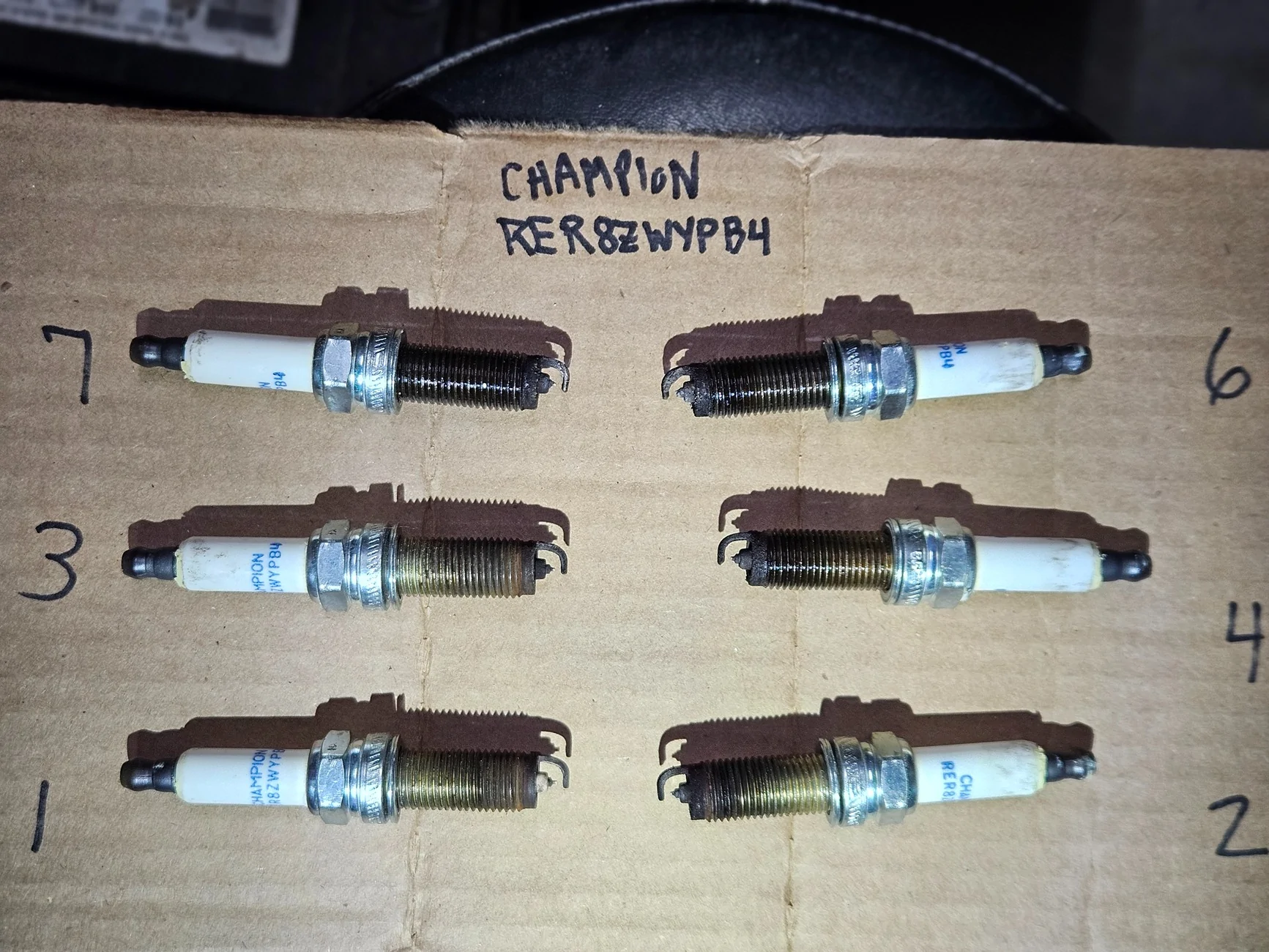

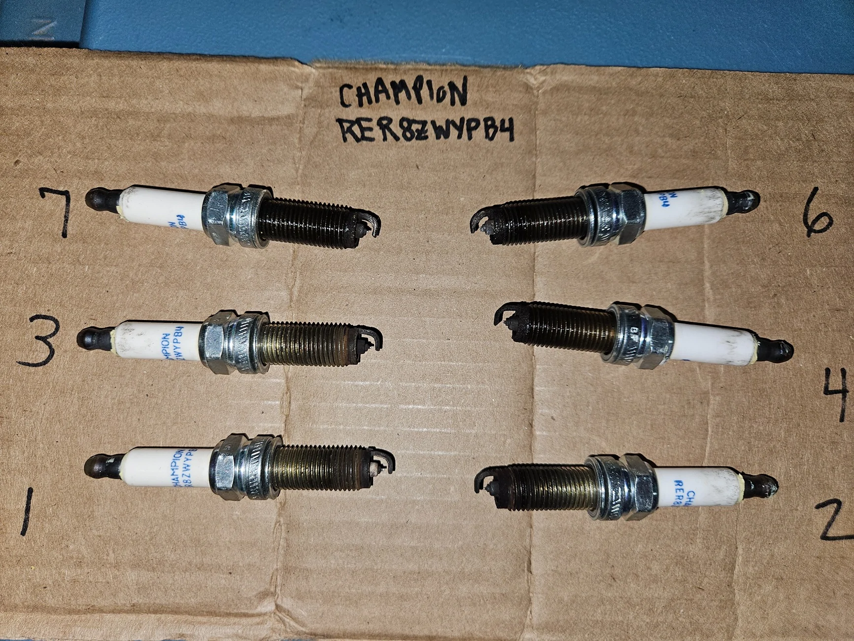

So now I had the CEL for misfire Cylinder 1, experienced rough idle at startup, and had coolant disappearing with no external leaks. I am in the process of taking the heads off to replace head gaskets. I took the passenger side spark plugs out a few weeks ago, did not like the oil on rear cylinder. Yesterday I finally looked at the drivers side and they are worse.
Any thoughts on these plugs and the story they tell? I plan to replace PCV valve during reassembly. Maybe I'll know more when i get the heads off.

I just noticed I marked the rear passenger side cylinder like a V8, hmm lol.

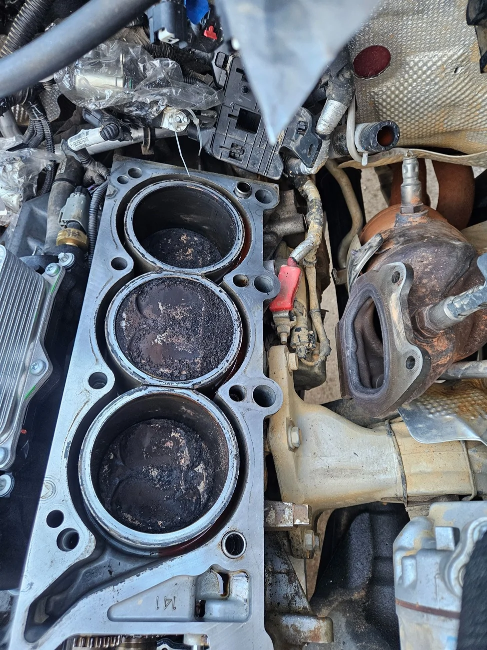

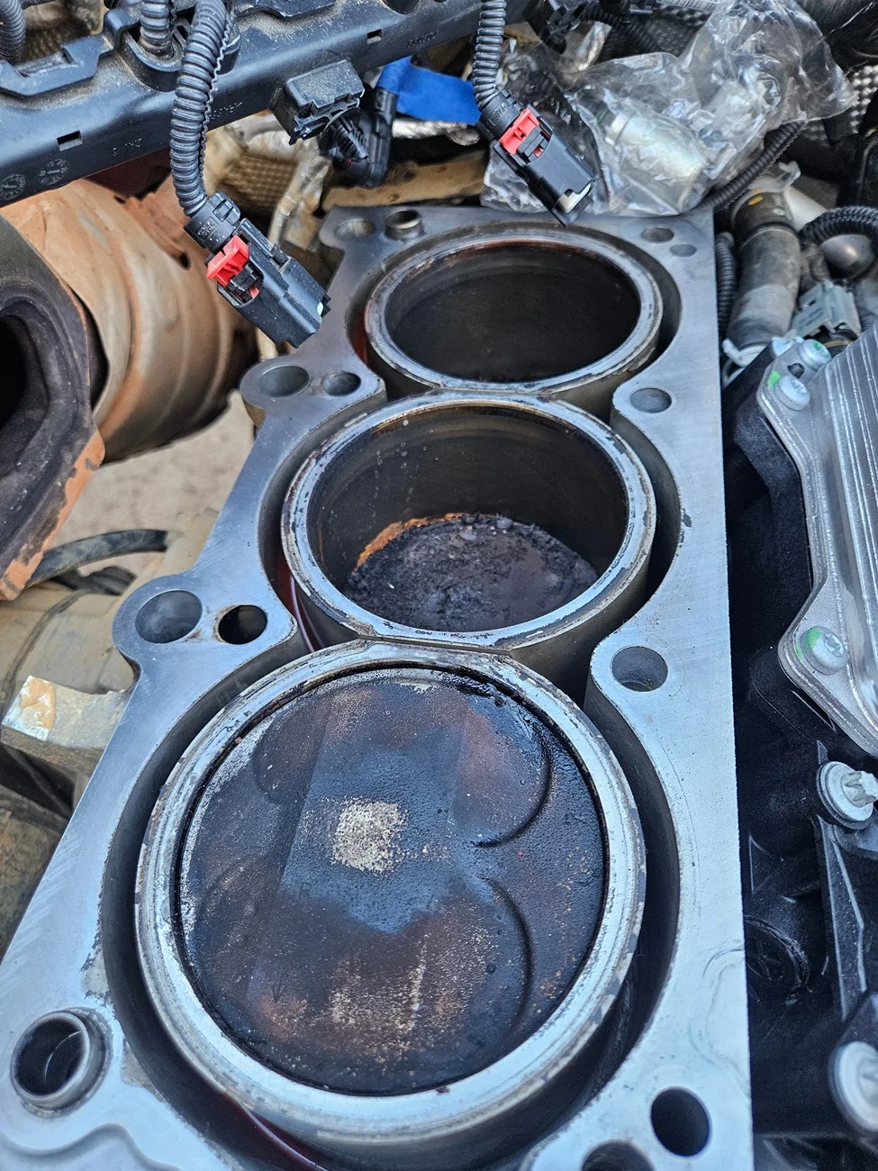

So when i pulled the heads off, I wasn't terribly surprised to find lots of carbon on the pistons tops. I soaked with WD40 scrubbed with a green scotch brite pad. #1 where the misfire code and head gasket leak occurred cleaned.up real well; been steam cleaned with coolant for a bit.
The drivers side seemed worse..
EGR cooler right there maybe sending more heat to the head. No exhaust manifolds on these engines, just a cast collector in the cylinder heads? Seems crazy to me.
I showed the pics to the guy that machined my heads. He just said something generic like "sh!t gas nowadays, they all look like that." . Not quite what I expected, maybe this is normal.
I still find it hard to believe a good clean running engine will leave this much carbon in the cylinder. Thinking about running higher octane gas and decreased oil change intervals. Also have a new PCV valve to install, will compare the old/new part numbers i have and look for online discussion.
