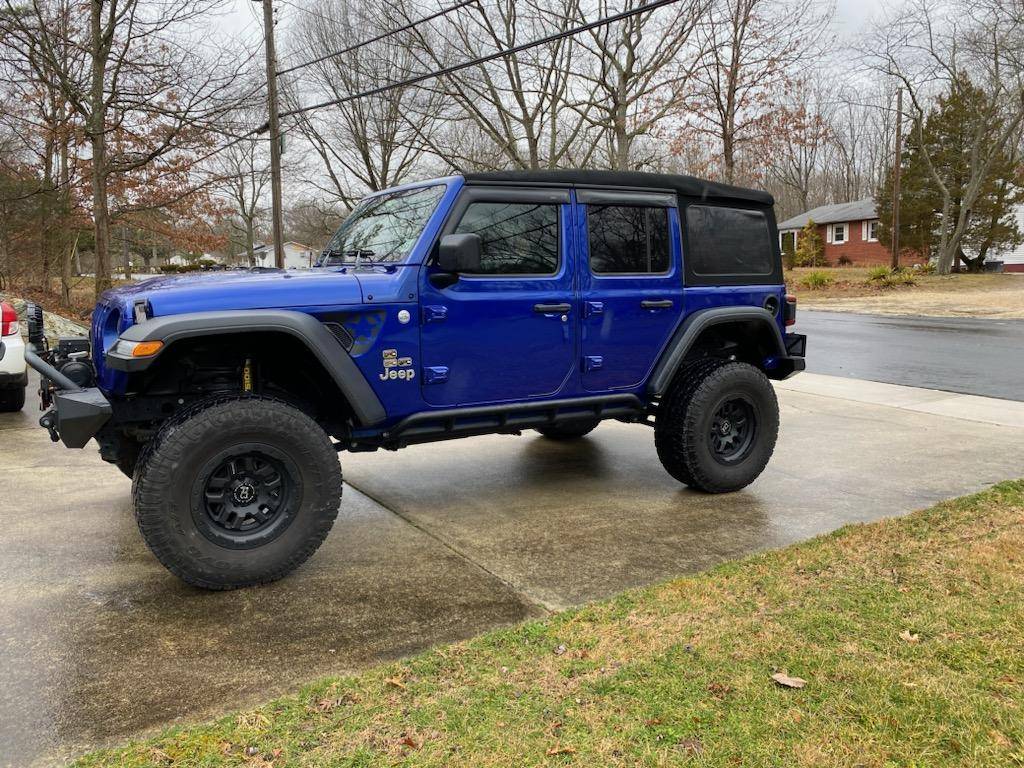

So I was running the 2.5” RC spacer kit for the last 3 years. I had an opportunity to buy a set of 2.5” AEV diesel springs and the bilstein shocks for dirt cheap. Had the springs and shocks put on this morning. Got a 2” lift over the spacer kit that was on it. So in essence this was a 4” lift. Hoping the springs will settle some over the coming weeks. Both my front and rear need track bar brackets as both are off about 3/4”. Ordered the teraflex brackets and those will go on when they arrive. Other than the brackets drives better than stock. Also recommend getting the Clayton front brake line brackets to give the lines a little more flex. It was tight at full droop. 35”s look small now. ?

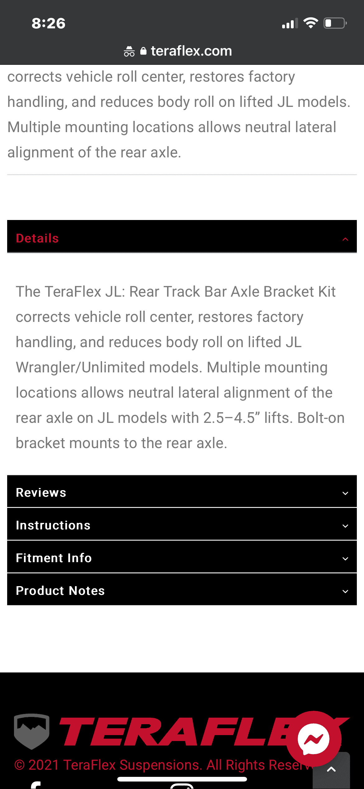

I checked the Teraflex product page, and their description of that particular bracket raises more questions than it answers. The claim what it does, without explaining why or how. They don't even provide more than that one pic. Most reputable companies explain exactly what a part does and how it does it, along with a pic of it installed on a Jeep. I'd also ask them what the benefit is of a track bar not being parallel with the drag link.
