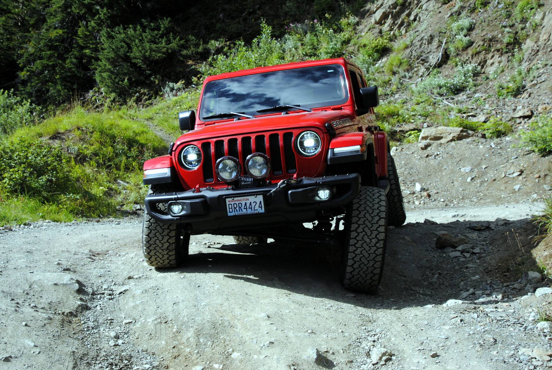

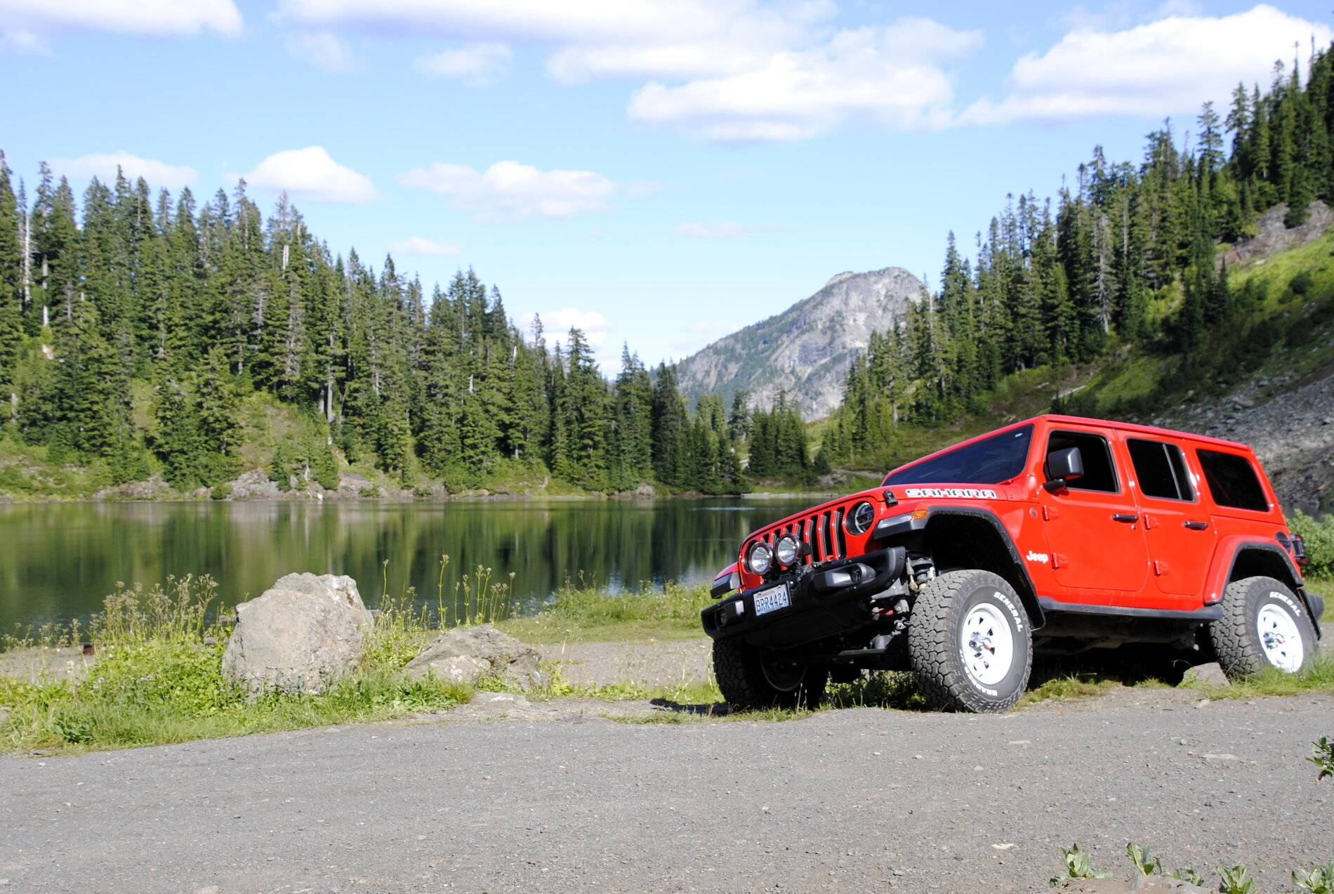

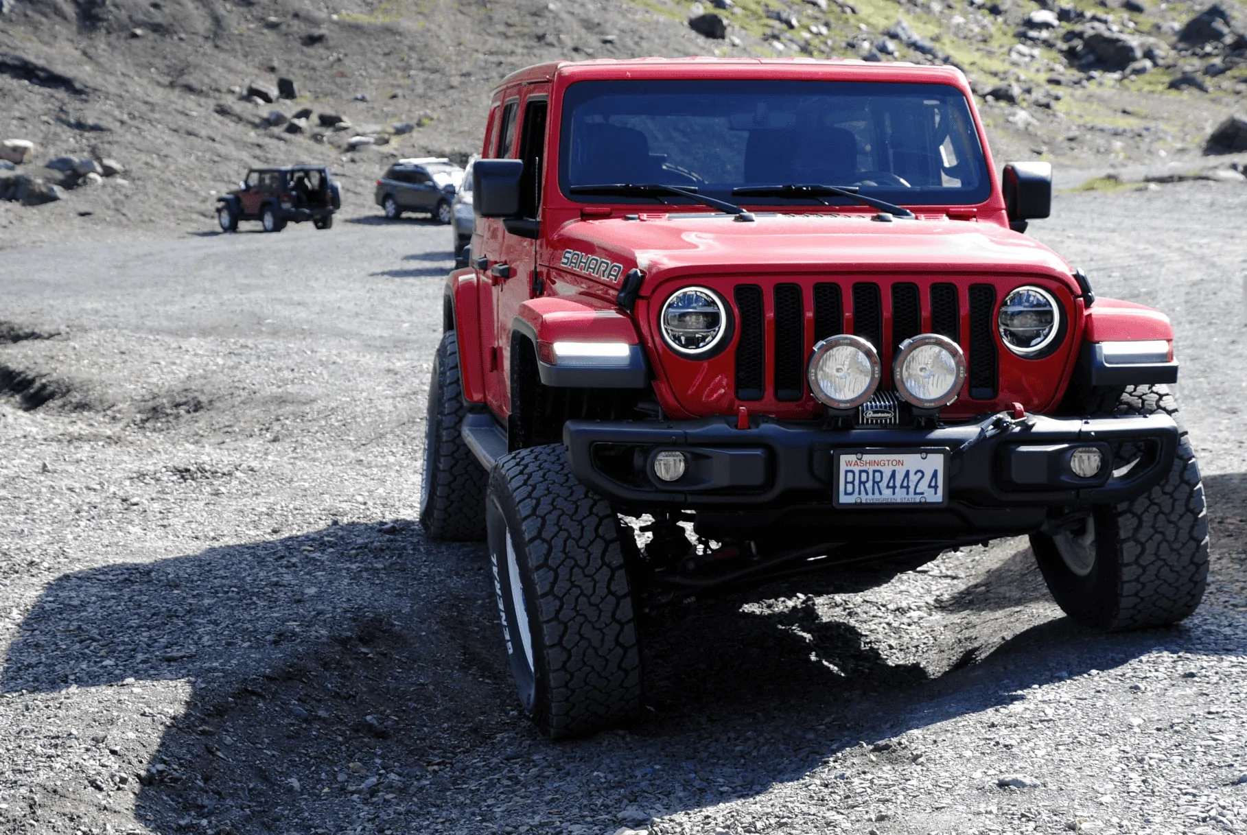

I’d do a Mopar lift and resell the Rubicon parts. That will minimize some of the financial blow.
I got the Mopar lift on my Sahara and 35-inch tires: I’m super happy with it.
Took these fully disconnected —got the JKS quick disconnects
