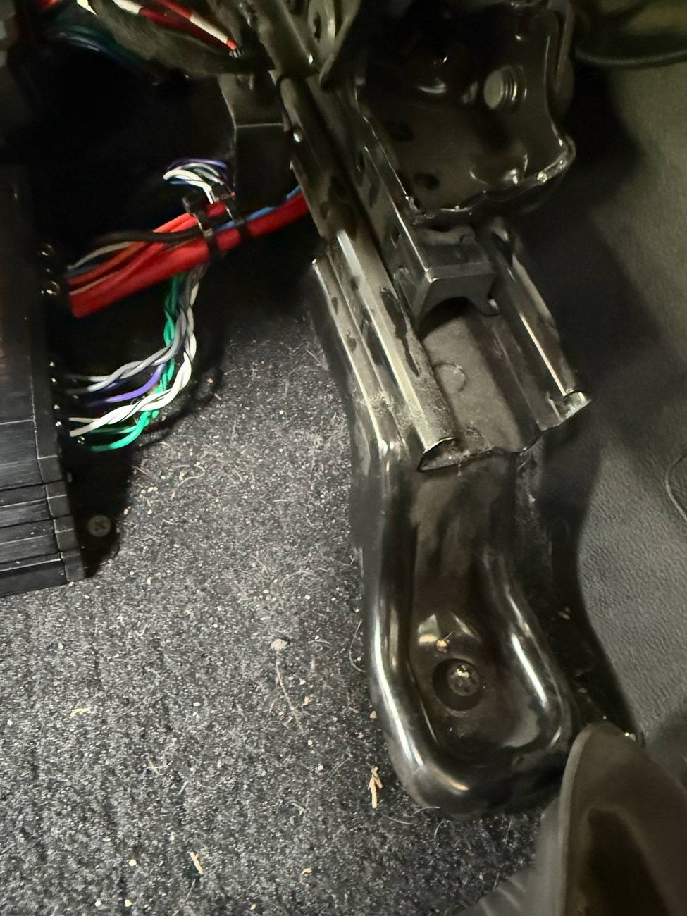

Maybe recheck the quality of the amp grounding. Also, your amp ground goes to something solid and not other wires, right? Keep the ground cable short too.

you might be onto something they used the seat bolt for the ground… I feel like it might be off though… would this be causing the issue?
Bare metal
Ground
Carpet
Seat

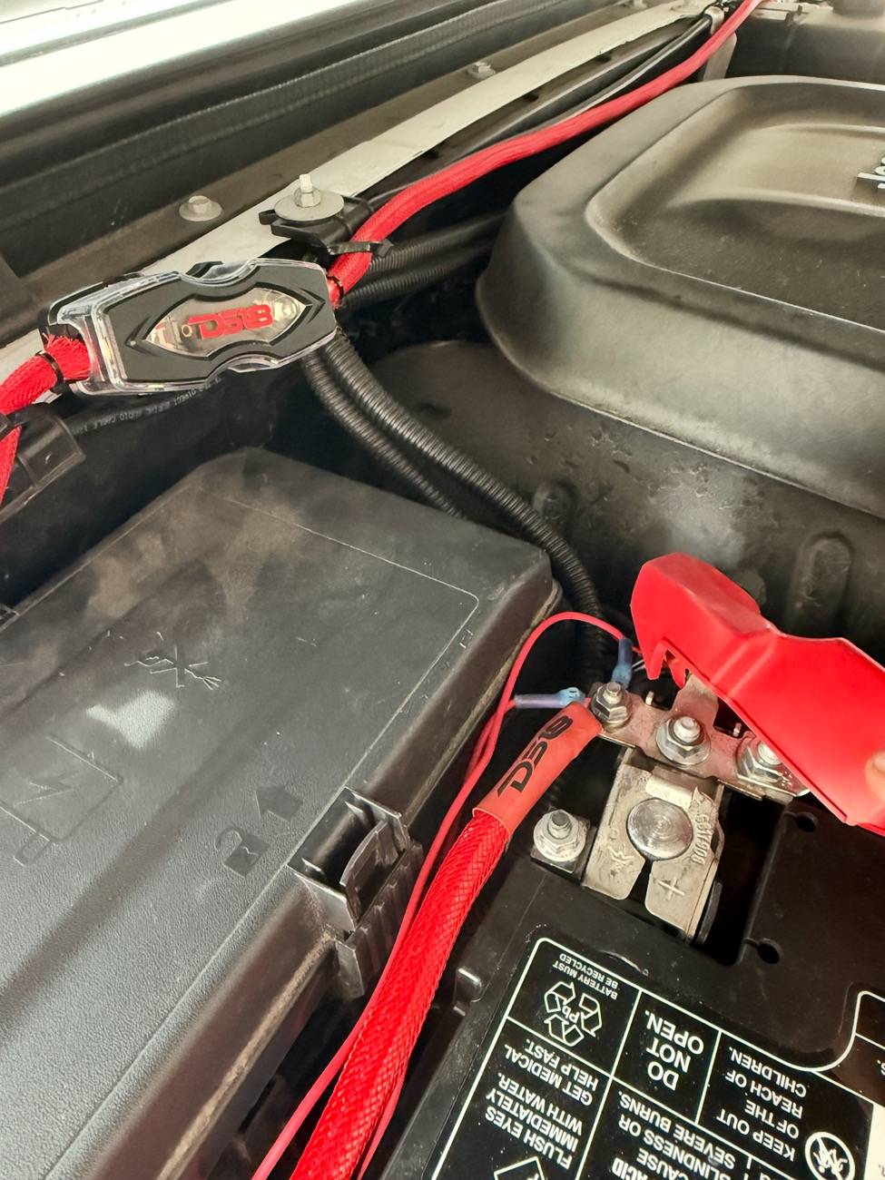

Did they wire the amp to the battery?

IF you are experiencing a hum, a bad ground loop has to be considered. Find a way to have a dedicated ground point for the amp. Something else to consider is the source of power for the amp. Not all 12v power is good for audio. As mentioned above, wiring direct to the battery will provide a clean 12v power source.

I would probably ground that direct to the battery.
