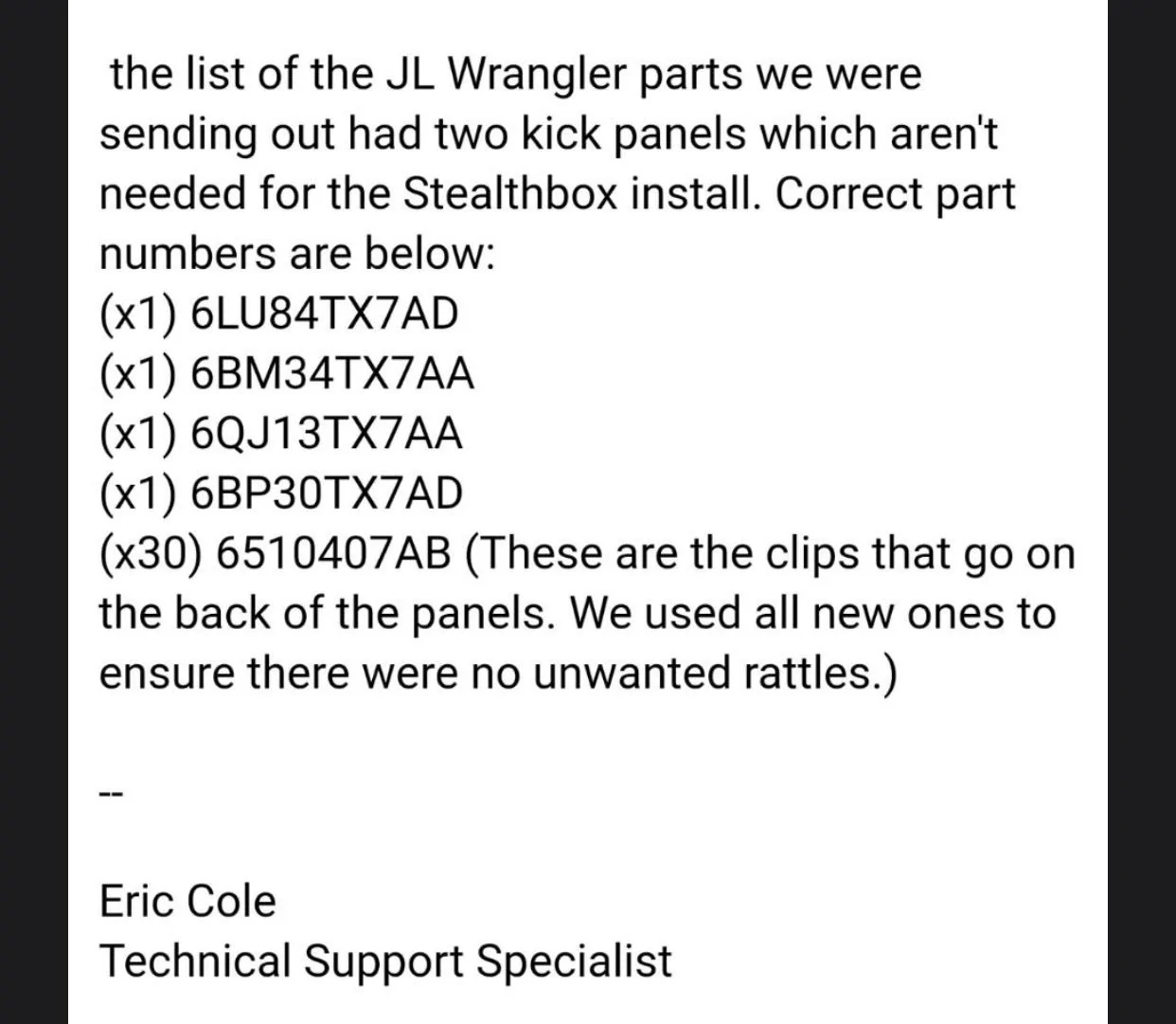

So I had the factory alpine sub. I've replaced with 2 JL stealthboxes. The trim on the drive side is fine. The trim on the passenger side is a problem. I need the plastic trim piece (may be more than one part not sure) part numbers from Mopar. I went to dealer and they dont know chit. Anyone put a stealthbox and dealt with this? any help appreciated. 2019 JLUR with blindspot monitoring is what i have.

Here's a video from YouTube, already cued up to the part you need, and I think the part number you're looking for.
