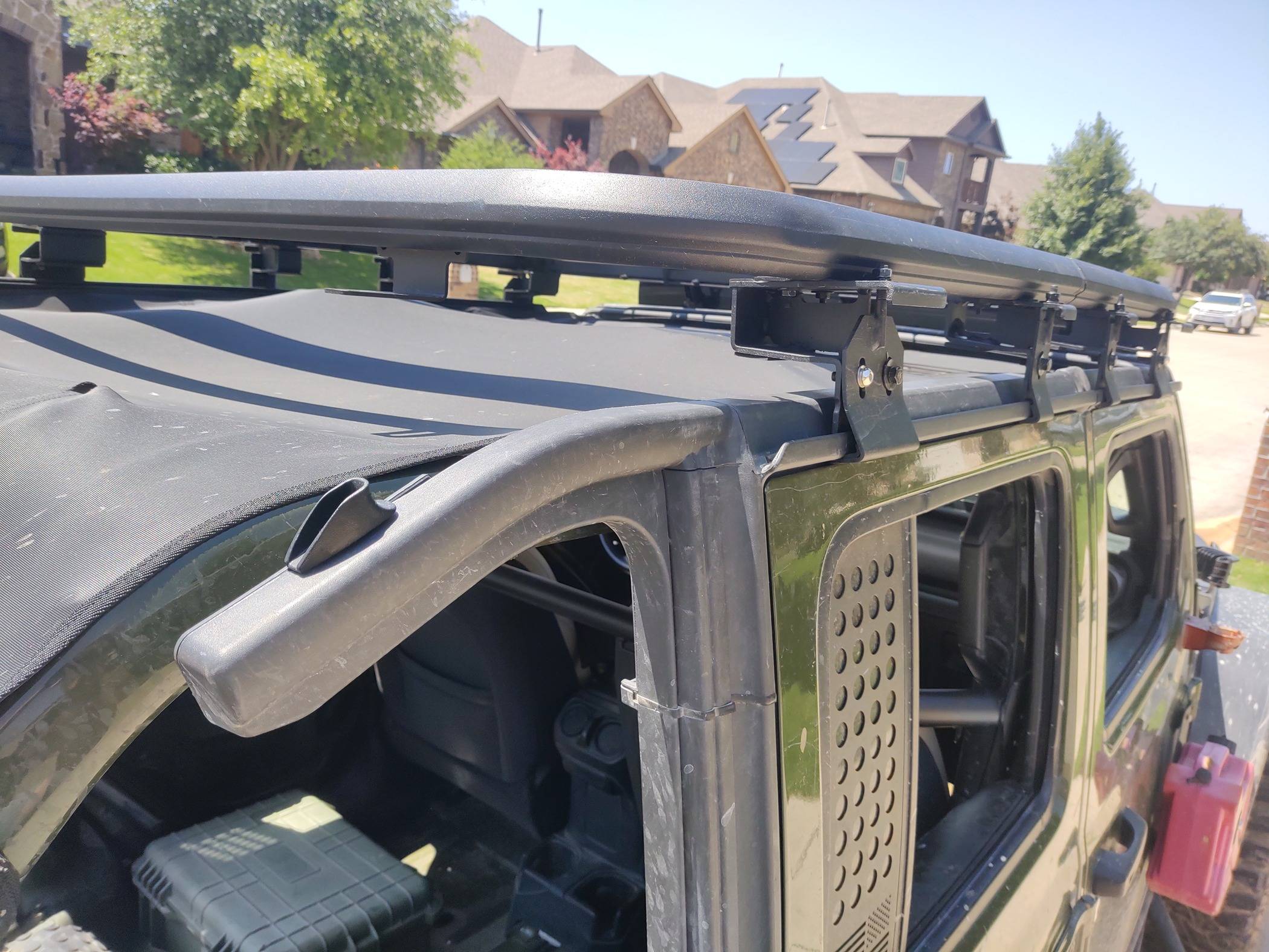

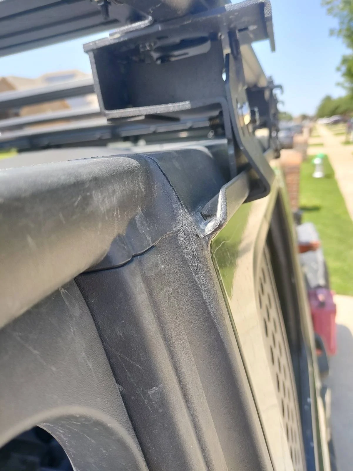

You got a photo of your SOT?
Namely this section...
Jeep Wrangler JL SOT & Hardtop Together? IMG_20240527_145317875_HDR
The channel on the edge.
Because if hardtops have that channel for the flow of rainwater away from the vehicle, and soft tops have it to use as a channel for the soft top to sit in, I wonder if the SOT has a channel as well?
If you do, I don't see any reason you can't run a roof rack just as I do on my soft top channel.
Jeep Wrangler JL SOT & Hardtop Together? IMG_20240527_145325811
I wouldn't necessarily trust 600 lb up there, but as long as you evenly distribute it, it seems to hold a spare tire and my high lift jack with zero issues, which in total comes to about 200 lb that I've put up there.
