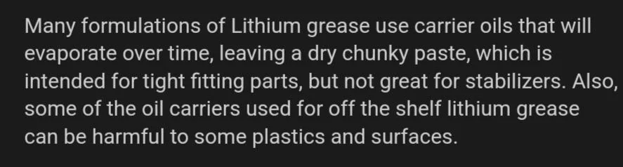

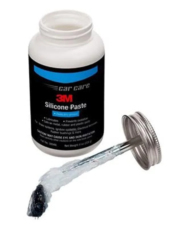

White lithium grease might be part of the reason why you have to grease it up each year.
White lithium Greece is great initially, but when it does eventually dry out, and it will eventually dry out, it becomes a friction enhancer. I wiped out a window channel a good number of years ago on my wife's Honda Accord hybrid at the time. Everyone on the internet recommended white lithium grease in the window channel, bad idea!
It's better to use something like silicone paste. It'll last 10 times as long, you can use it on pretty much everything from door hinges around the house, to spark plugs. Best part is, if it does wear down, it will never act as a friction enhancer like white lithium grease.
Jeep Wrangler JL Sky One Touch (SOT) stuck open 1000003153
Jeep Wrangler JL Sky One Touch (SOT) stuck open 1000003155
This guy right here is the cure-all! I have one 16 oz jar, exact same as one picture above. It's lasted me about 3 years now, and I use it all the time. I wouldn't recommend anything but!
