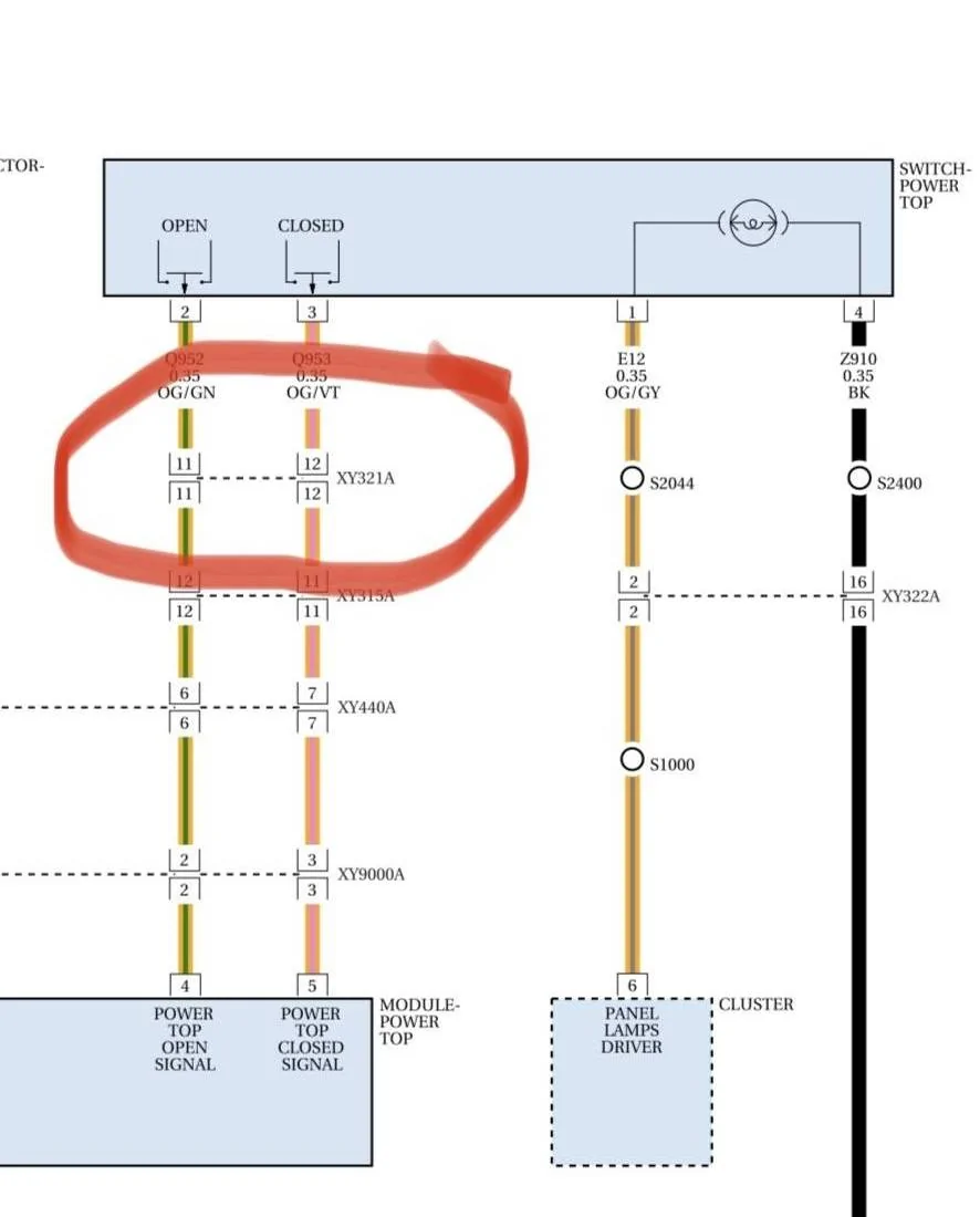

  2. Swap the wiring over to the new header panel from your SOT panel

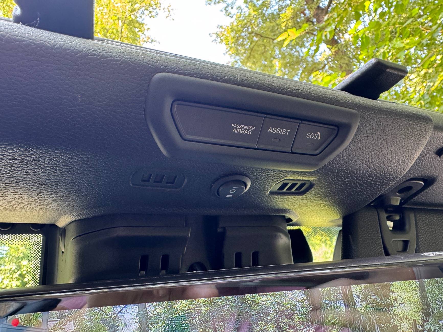

  3. Drill a 5/8 hole in the center of the header panel between the two mics and shove the switch in there
  4. Cut the wiring for the SOT switch and wire it into the new smaller momentary switch
    • Black goes in the center prong, then orang/green & orange/violet on the other two. Orange/gray is the constant power for backlighting which you will not need.

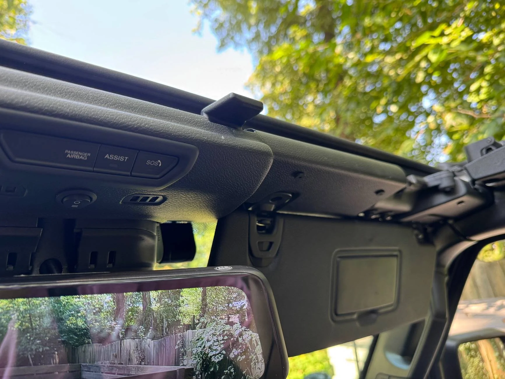

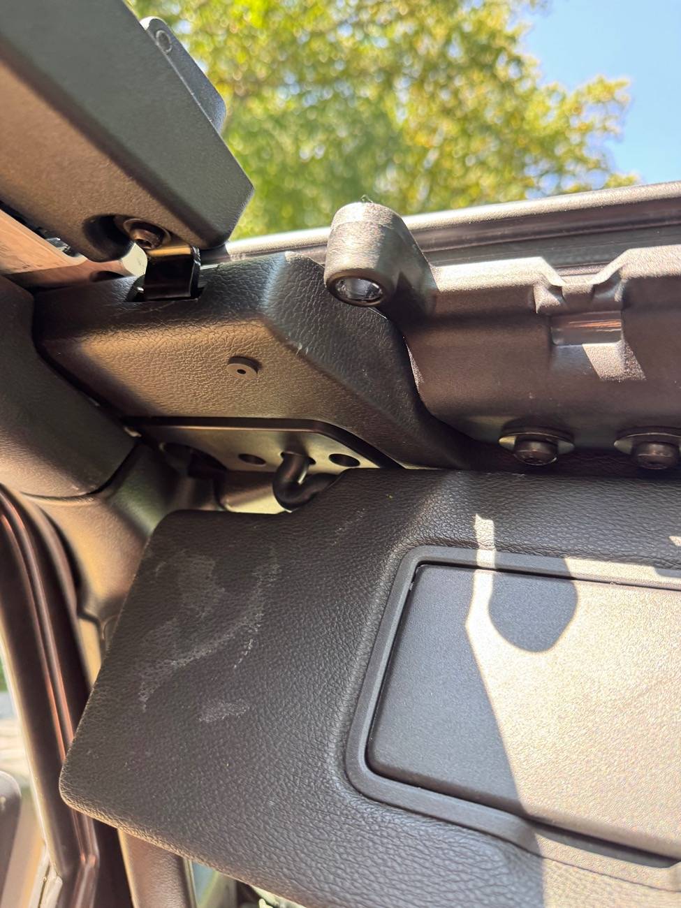

  5. Cut out two sections on the end of the panel to accommodate the SOT bolts on the left and right sides
  6. Install the header latches and hard top mount brackets from DV8.
  7. Snap the header panel back into place and connect all the wire harnesses!
Now whenever I swap tops all I have to do is remove or install the two mounting spikes at the front of my top that are for the SOT top. I'll need to drill two holes under the areas I cut to make removing the bolts easier, but I'm leaving that for another day. Thanks to @Gregj for all the info. Here's how mine looks:
