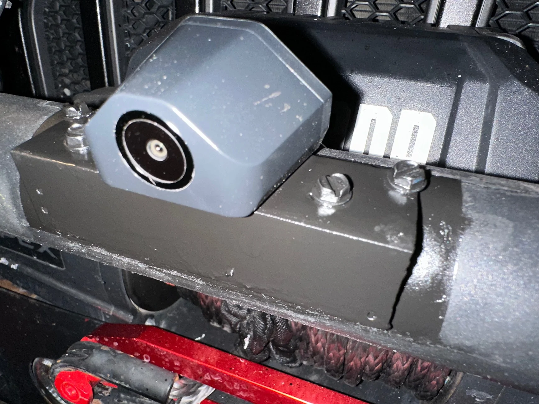

I found my solution for mounting the bumper cam on the bull bar. @WOLFBOX CAR LIFE, I am tagging you so you can forward my results and conclusions to your engineering team.
First, zip ties do work - IF you completely close the hinged mounting plate and tighten the hinge screws as tight as possible.. Just thread the zip ties through the slots - one in each of the outer pre-cut grooves, then around the bull bar - and then one down the middle, over the base plate, through the hinge gap, then around the bull bar.
As previously stated, elevating the camera by opening the hinges results in an unusable view/video, due to everything the camera sees waving and shaking madly on the screen, starting at very low vehicle speeds.
I tried to dampen whatever vibrations were causing the image sensor to go nuts, by placing rubber shims in the hinge gap, under the base plate, and between the base and camera plate, but I was totally unsuccessful.
Here is my simple solution to mount the camera on the bull bar: a short piece of angled aluminum, painted (except where the 3M tape attaches), screwed into the bull bar. I used Tapcon screws after drilling pilot holes. Four screws on the top of the aluminum (where the camera mounts) is quite sufficient to hold it on the bull bar permanently. Then, simply 3M your camera to the top, flat surface.
I have extremely stable video at all speeds, no matter how bumpy the road or trail is. See photo below. Please note the paint is still wet in spots, reflecting brightly back at my iPhone camera. I also will have to hit the front plate with fine grit sandpaper or steel wool, then add another coat of paint - because right now it looks like crap.🤣

WOLFBOX OFFICIAL
Nice work! I'll send this to my engineering team.
