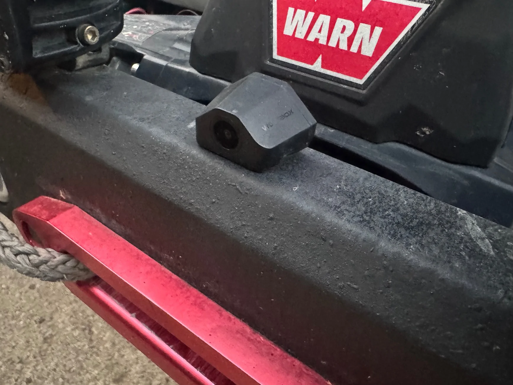

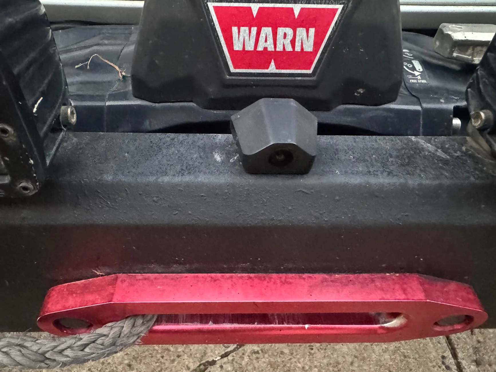

I skipped the hinge on the front bumper cam and used 3m VHB tape to mount in directly to the bumper. The only anomaly I had was when I first competed the install and was in the garage with a bunch of ceiling mounted fluorescent lights. Are you saying image waviness or is it shakiness from the hinge which is not very robust in my opinion? I used this hinge and 3m VHB tape in the rear to mount the camera to the flat part of hinged bracket then some more substantial hardware to mount the hinge through the slotted part of the hingesd bracket to the license relocation bracket. I understand this is a universal kit and they can’t account for every mounting possibility, but hinges and small hardware could be improved on in my opinion.

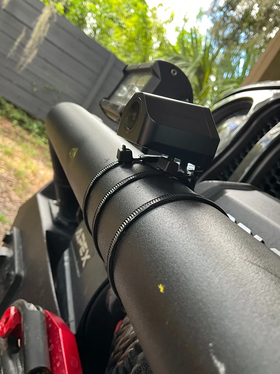

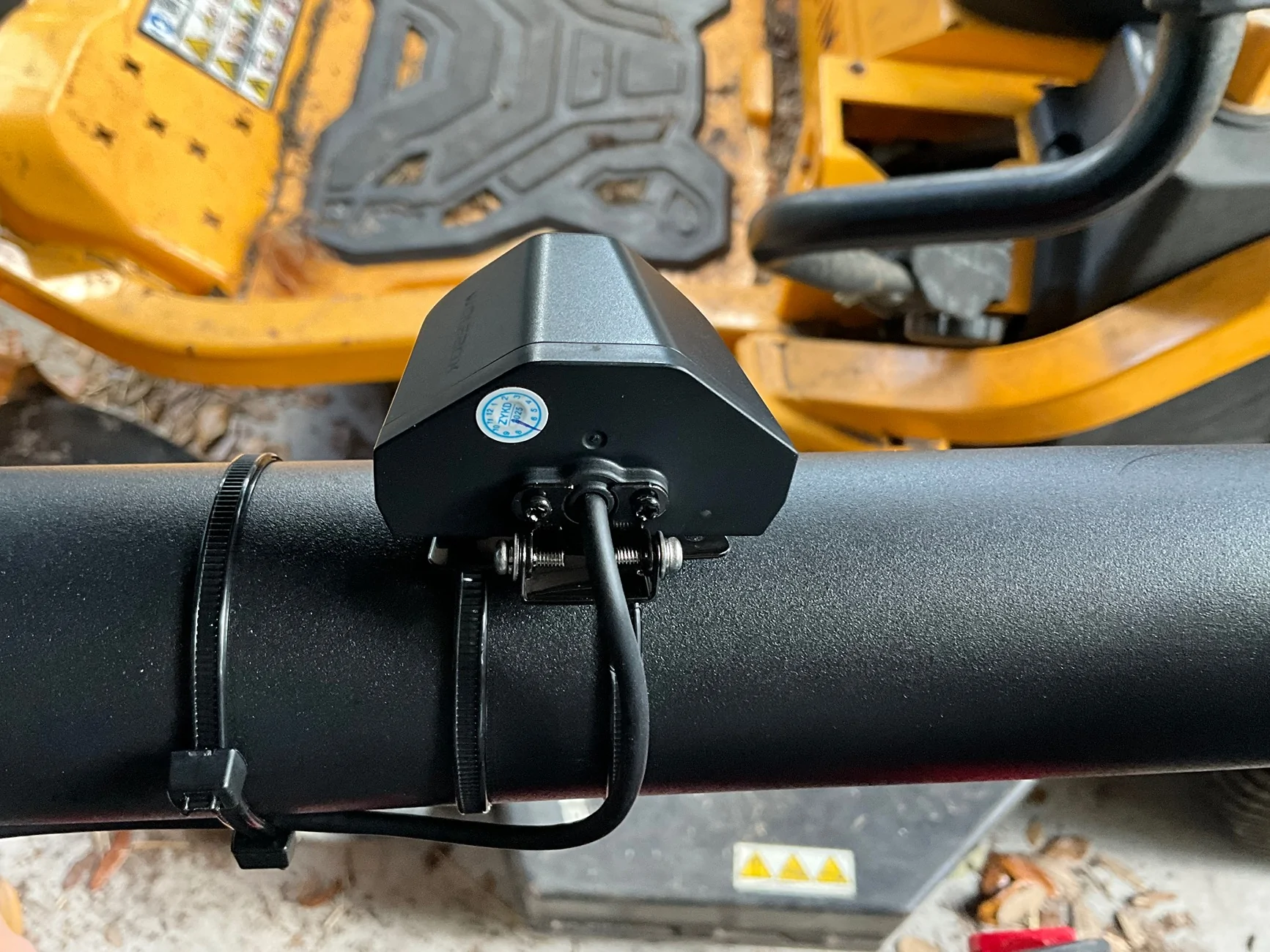

Ted, how exactly did you mount it? Mine is currently mounted on my bumper too, without the waviness. Only a very, very minor difference causes the shakiness. The below photos show how it’s mounted; by simply elevating the camera by unfolding the mount at the hinge, just a tiny bit, causes MASSIVE wavering of the image, at 1-2 MPH on a very smooth surface.
I’ve got the mounting plate closed as far as it will go in these photos.

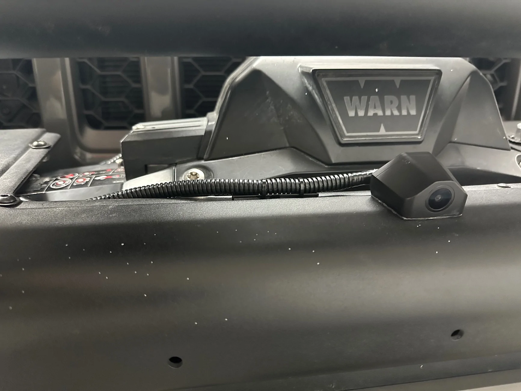

The front and rear hinges that came with the external cameras are completely removed. In the front I used my own 3m VHB tape and mounted the bottom of the camera directly to the bumper. There’s enough adjustability of the image up,and down on the rear view mirror display that this spot works for me. Let me know if you have more questions or want different pics

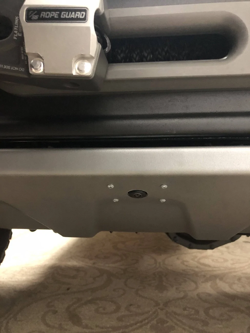

My OEM front trail camera is mounted here and I can see the leading edge of my front tires and any terrain about 4 feet in front of them. My intent is to use it if I’m going really slow and struggling on an obstacle but usually forget to use it. This also allowed me to install the Bolt hood lock. I got the idea from @BDinTX who does actually have some good ideas from time to time 🤓

@BDinTX and @Terrymo Ted and Terry, that explains the difference. I don’t have a flat area to 3M it to. I had to use the hinged bracket and zip-tie it to the bull bar. There is no other place on my bumper to center-mount it. I could tape it to the control box of my winch, but the bull bar obstructs the view.
