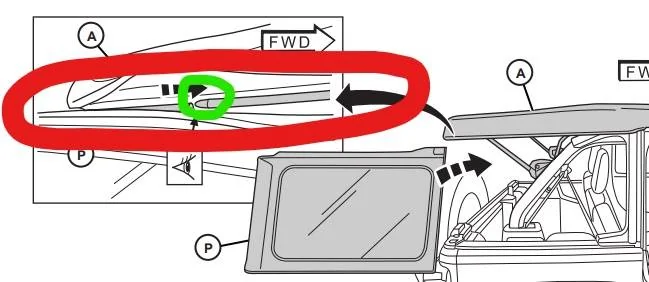

Guys, as title suggests, are the white soft top window slider guides that are attached to the soft top replaceable ?? circled in green in the picture.
My front door neighbor has that part broken and says dealer told him he had to replace whole top as these parts aren't replaceable. I watched him take a good 5 minutes to put his right side rear window on yesterday and thought I'd seek your help.

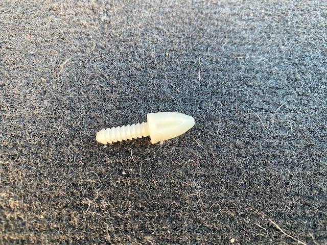

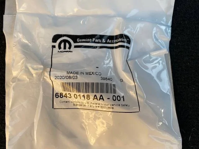

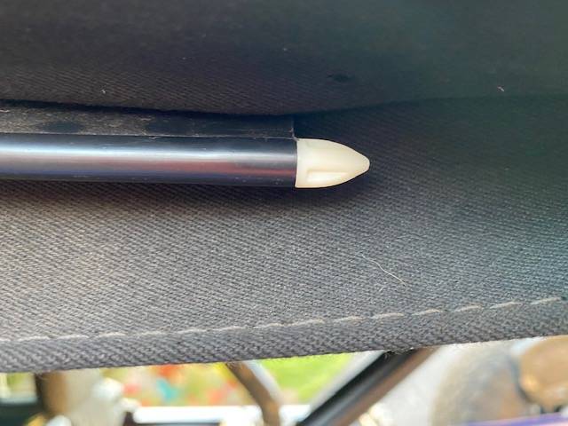

I had one replaced under warranty. First they ordered a whole new window, then they figured out how to order just the white guide. I'll upload a picture of the part number when I find it.
Added pics here and below for anyone looking later

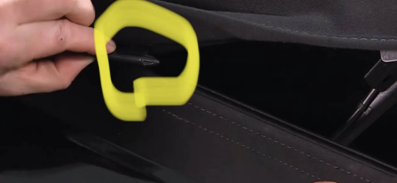

My bad guys, I thought the part was white but it’s actually black. I found an install video and froze the image and circled what he needs.
Jeep Wrangler JL Soft top window slider guide replacement ??? 570A55E1-ECFB-4B66-858A-89D320C9EB7B
Gregj
Greg
Dec 15, 2018
2,814
5,737
West Texas
2018 JLU Rubicon, 2018 JLU Sport, 2023 JTRD, 2017 JKRR, 1998 XJ
Same part. They are white on my top.

Oh I know, I didn't say the dealer was good at their job. They gave me a several hundred dollar window instead of the $2 plastic guide. Luckily they eventually figured it out. Here ya go!
Jeep Wrangler JL Soft top window slider guide replacement ??? IMG_3878
Jeep Wrangler JL Soft top window slider guide replacement ??? IMG_3879
Jeep Wrangler JL Soft top window slider guide replacement ??? IMG_3880

This is exactly what he needs, sent him the info and he's extremely thankful to you for supplying it. To think that the parts dept told him he had to live with it or change the whole top part...
HungryHound
Rick
Dec 24, 2020
1,366
2,835
TN & FL
1975 CJ-5, 1983 CJ-5, 1998 TJ, 2021 JLURe
Maybe 68430118AB will have better barbs to hold them in. I've already lost one for my rear window.
