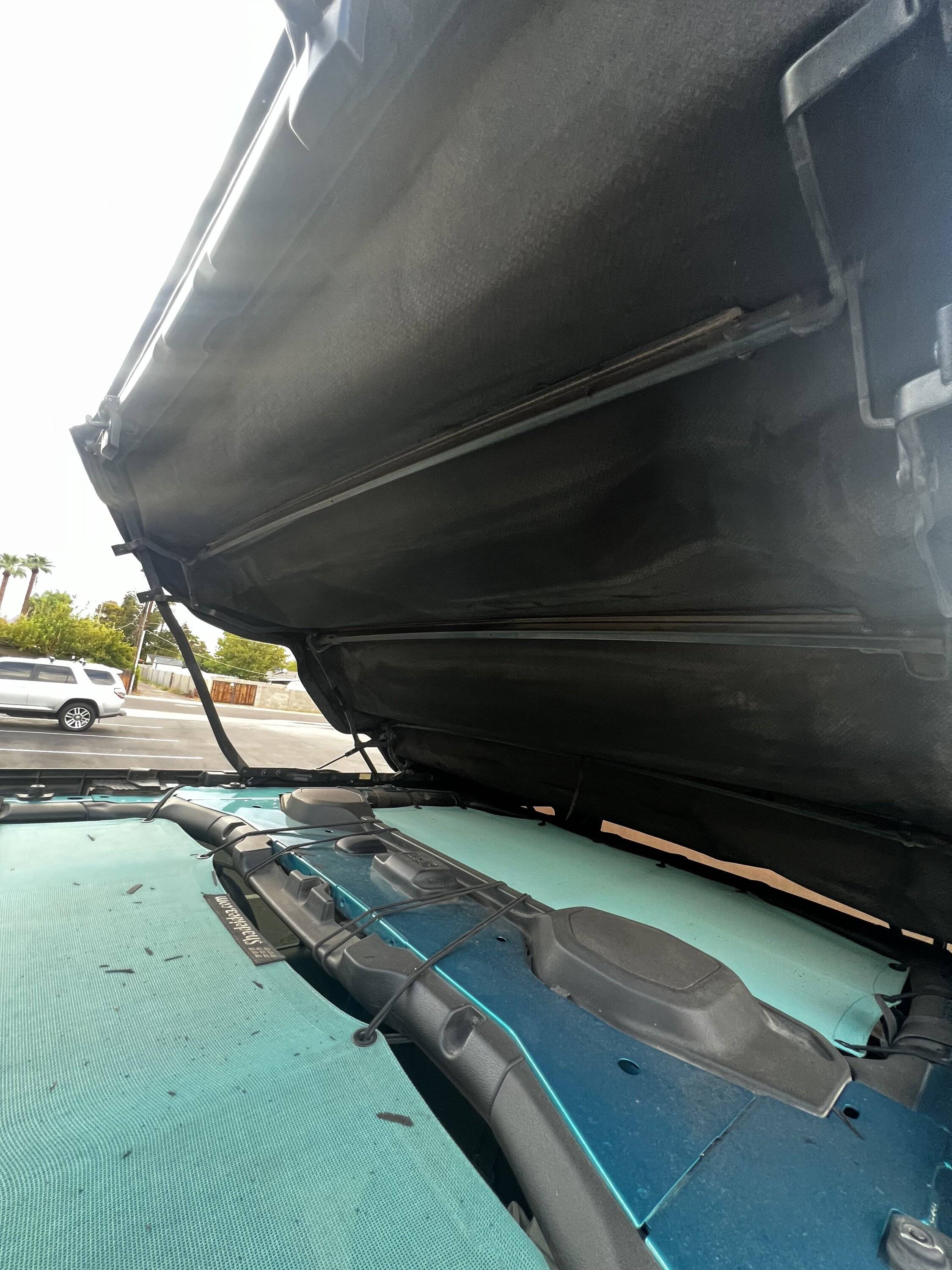

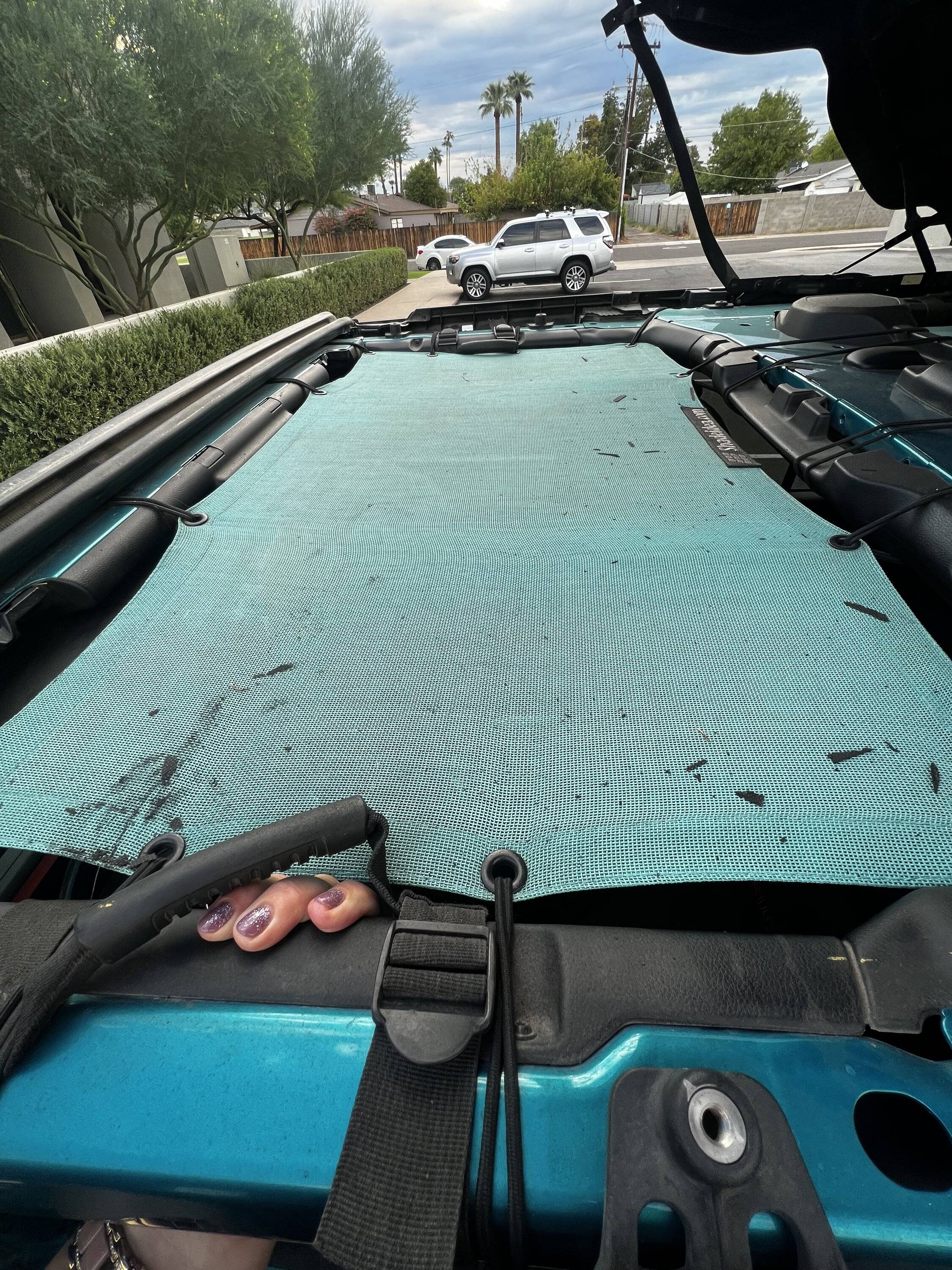

Finalllllyyyy got my jeep back after having the engine replaced and a few other things done. It’s been sitting outside in the AZ heat for over three months. I’ve had a sun screen on the top and noticed as I drive now that random bits of “fabric” that disintegrate when touched fall down on my head. I’ve traced it to what sits on top of the crossmember bar on the soft top. Anyone else experienced this or idea how to treat?
...as I drive now that random bits of “fabric” that disintegrate when touched fall down on my head.
I'd agree with the idea that fabric deterioration, as a consequence of prolonged exposure to heat and light, is occurring.
Perhaps the real test here is to determine if the top's waterproofness is now compromised. Any water infiltration would indicate that a replacement top is now required. On that point, I don't know if or how you'd have any recourse with the dealer, as it concerns the cost of a new top.
Best of luck with things, Kristy. Personally, I'd go in for a new top simply because the falling bits of fabric suggest that a slow motion failure has already begun.

That definitely will be the test. It seems that it’s coming from the fabric that sits on top of the crossbar. I haven’t seen any fall from the inside of the twill top so far. Definitely will be watching it. Unfortunately, it’s out of warranty so no dealer would help unless I pay for it. We’ll see how things go!

I'm a plastics engineer. Oxygen + Heat and UV will make fibers degrade. Fabric has more surface area than a solid piece such as your fender so more place for O2 to touch the plastic. Many folks may not realize that almost all fabrics are high % plastic.
Vinyl =PVC = plastic
Twill is probably polyester with possibly some cotton = plastic + cotton?
Nylon = plastic
As things degrade they get brittle, break, and little bits fall off.
I live near Houston, so I feel your pain - but at least you have a DRY heat.
Pay close attention to thin spots which may rip at highway speeds.
