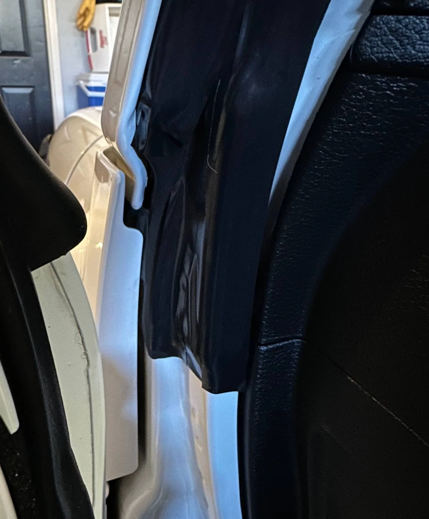

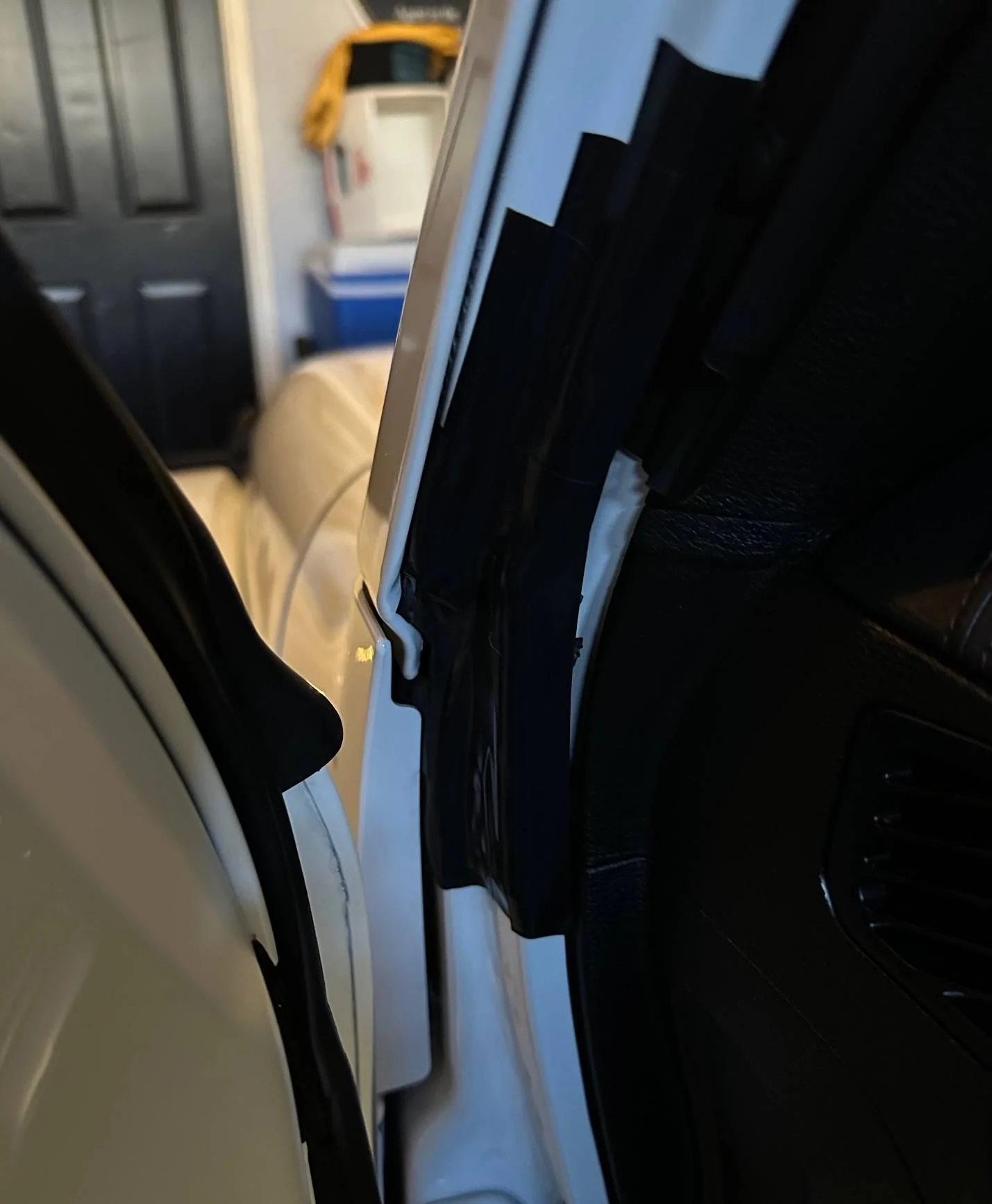

I tried every fix on the forums. Windshield seal, under cowl weld/seam, plugs. The source of my mysterious wet mats was the molded rubber cover at the frame/windshield/door. I taped the entire area for two weeks and parked outside. Endless rain, dry carpets. Pulled the tape and sealed behind all of the molding and plugs. Still dry.

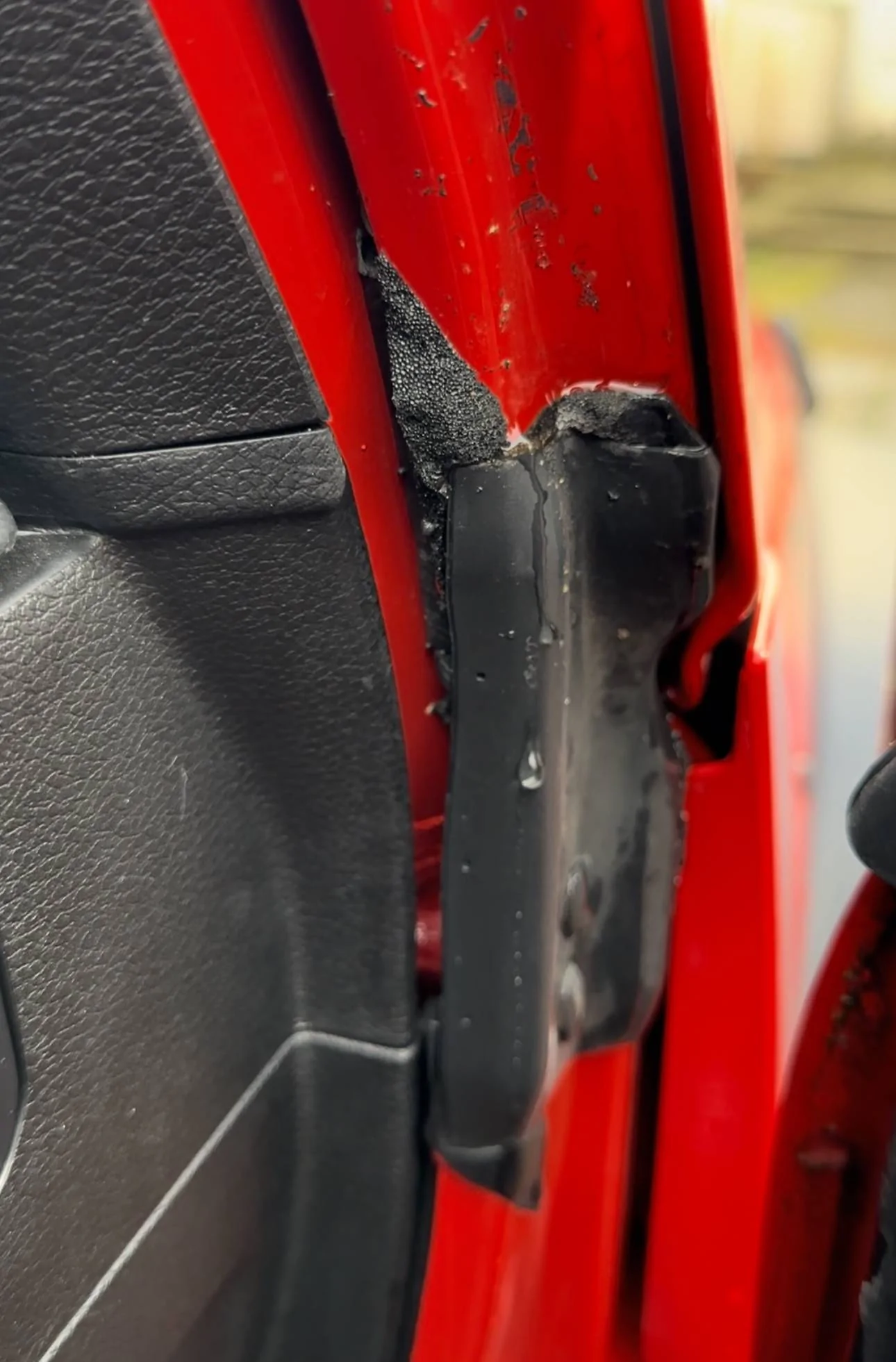

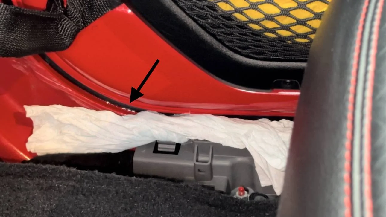

@Jeffy56 Thanks, turns out both outside ones were loose, thought I had won a watch, but after pouring some more water around the roof, still pissing in the bottom of the drivers door.
@Eyeball nope
@Chestatee This could very well be where my problem lies actually.
Jeep Wrangler JL Soaking wet carpets, front drivers side only IMG_6EFB10AF69C9-1
Jeep Wrangler JL Soaking wet carpets, front drivers side only IMG_EB567160A31E-1
In the above (not the best picture), but the arrow is pointing to where I can see the water running with the door closed.
Think I'll just bite down hard and get the dealer to look at it (given I've broken 3 of the small white clips while removing tho bottom panel).

Exactly where my water came in.
I used a bit of electrical tape in the pics to test (all I had handy). It worked 100%.
Once removed, I pulled the two plastic plugs/trees, cleaned, applied a black RTV sealant/gasket, reassembled, put some sealant in the trees and mashed them in. Will have to find the tube of RTV I used. Nothing special. Good luck!
