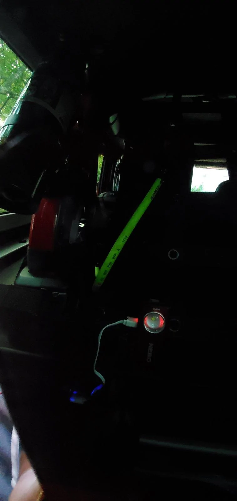

I have a NEBO rechargeable light which has been stored in a molle pouch on tailgate.
I installed a USB adapter and plugged it into the cigarette lighter outlet in the cargo area. From there, I plugged in the light so it charges everytime I turn the Jeep on and drive.(many times I've gone to use the light and it's been dead or nearly from sitting).
What's puzzling me is - Jeep is completely off and the alarm set....but the adapter light is on and so is the red charging indicator light on the flashlight(?).
Is it charging while Jeep is off?
Will it drain the battery?
Attached is a photo showing this taken outside the rear window glass about 10mins after the Jeep has been off.

I believe the rear 12 volt outlet is "always on"--so, technically, yes, it could drain your battery. The amount of power that small LED Light pulls though is unlikely, but, you never know.
You're better off getting another 12V adapter and wiring it to one of the wires under your dash if you have aux buttons.

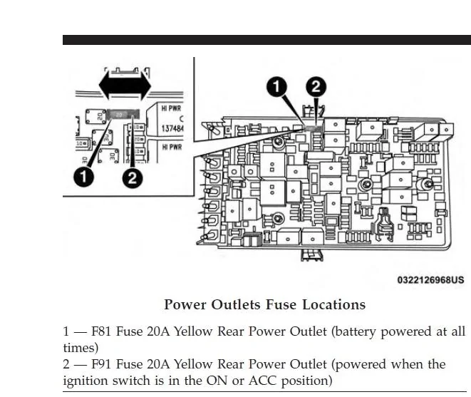

I have the same setup and my light has never encountered dead battery. I believe you can set the behaviour of the rear 12v outlet to be either ignition or always on by moving between fuse 81 and 91.
WOW!!!!!!!!
I love this guy!! THANK YOU!!
Just made my day!!!
Yep!!
This is confirmed just did it!!
So cool...thanks again!!
