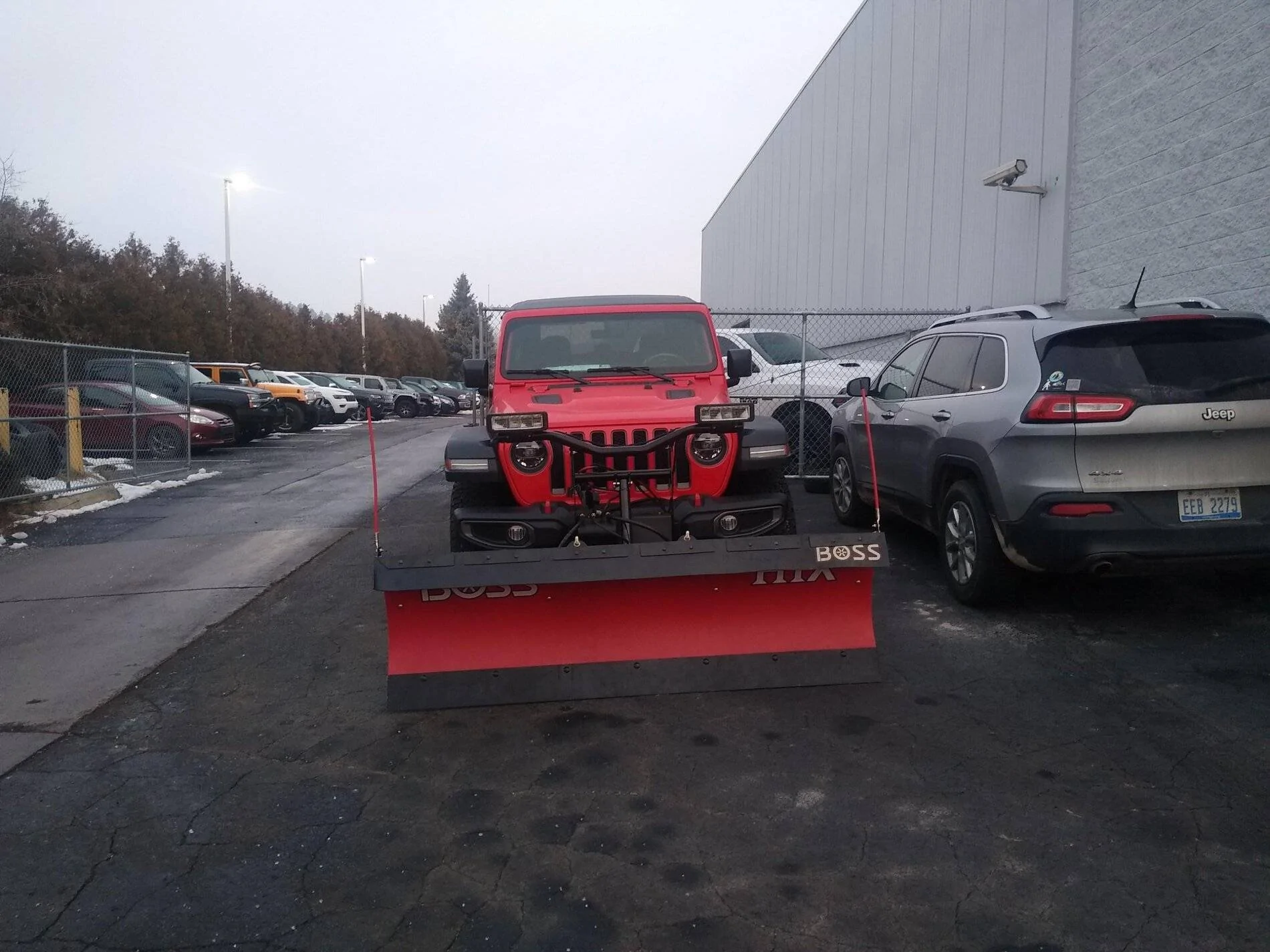

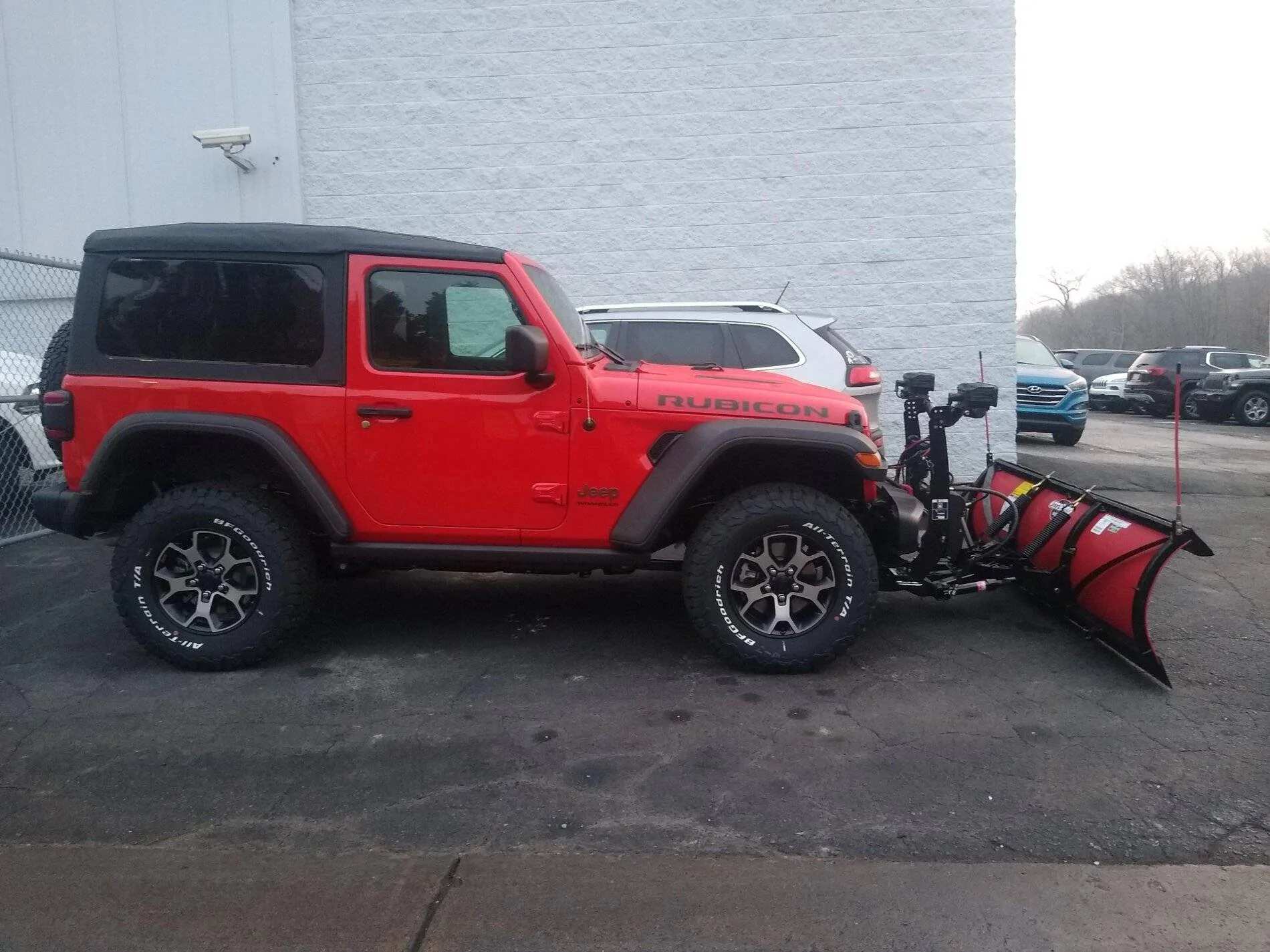

It is a 2021, how much plowing could you possibly have done? Given the amount of rake in the picture, I wonder how often the rear wheels come off the ground when you lift the plow?
Plowing a small personal driveway with a Jeep would be fine. 12 hrs of commercial use per event is going to trash the Jeep in short order. I am sure it handles 2-4 inch events fine but heaven help you with that lightweight rig should you really get snow.
Brother, you’re simply wrong. I try to plow with the storm, but occasionally shite happens. I’ve plowed over 12’ of snow with a Cherokee 4.0L and as long as you turn that plow and go slow in 4H a Jeep or Wrangler will crush it like it ain’t no thang And while you’re trying to find a place to turn around without smashing into another garage or tree, the Wrangler is taking another swipe. Your pic shows a Ford with solid axels, great for plowing bigger accounts, but you must know that a Chevy with independent (comfy!) axels gets burned faster than any Wrangler ever will. Jeep is in part responsible for these awful rumors and BS over the years because some of their less than honest dealerships like to scare owners about putting on plows and lift kits etc as they look for excuses to void warranties as they prey on the misinformed. Just like some thieving dealerships want to change tranny oil, transfer case oil and differential oil every 30k miles LOL. Wrangler is built to plow, but I’d agree any rig gets beat up when trying to make a buck with many accounts. Most of the beating occurs when driving around bouncing the plow off the front end, that’s the worst treatment, or slamming into snow banks.
