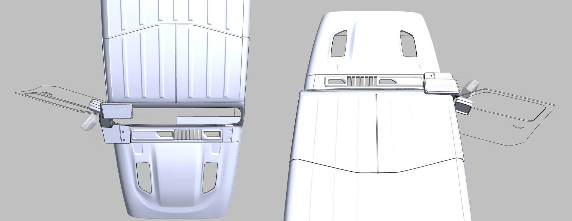

We'd like to gather some feedback on our JL Stealth Snorkel design prior to prototyping:

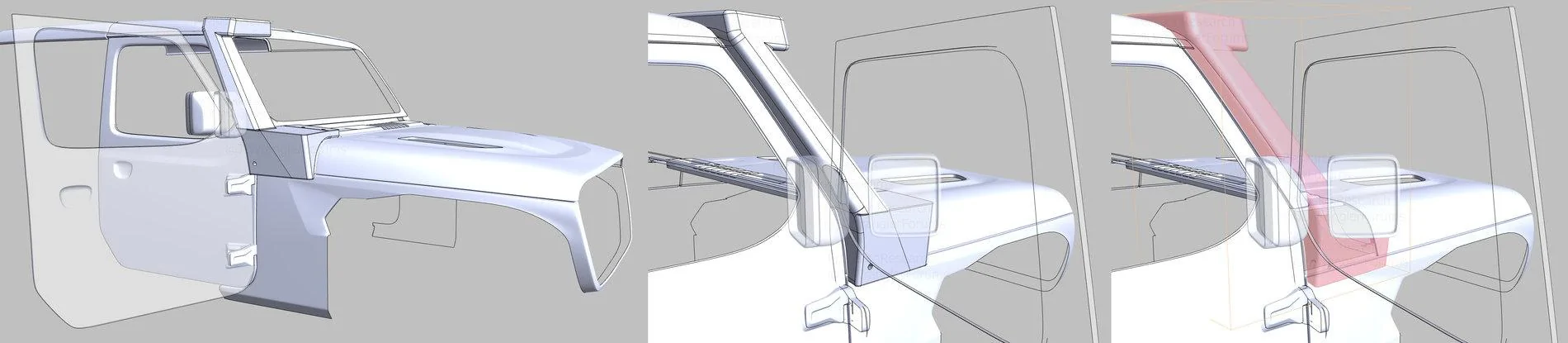

Jeep Wrangler JL Snorkel Prototype Factoring PrecisionResearch JL Stealth Snorkel 001
We've got a high flow airpath that has been CFD designed to provide optimized airflow, minimal turns and bends, and has the correct plenum effect offset for unobstructed engine power output on both the 3.6L and the 2.0T JL's.

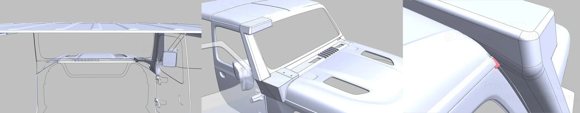

Jeep Wrangler JL Snorkel Prototype Factoring PrecisionResearch JL Stealth Snorkel 002
Our JL Stealth Snorkel is invisible from the driver's perspective, completely hidden behind the A pillar - hence the "Stealth".

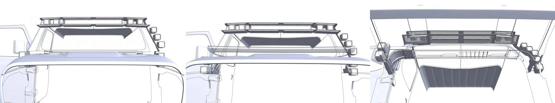

Jeep Wrangler JL Snorkel Prototype Factoring PrecisionResearch JL Stealth Snorkel 005
Our JL Stealth Snorkel doesn't add to overall vehicle height so that you can still get into your garage if you're lifted and also includes JL roof drip rails extension to channel water forwards and onto the edge of the windshield instead of dripping into the interior.

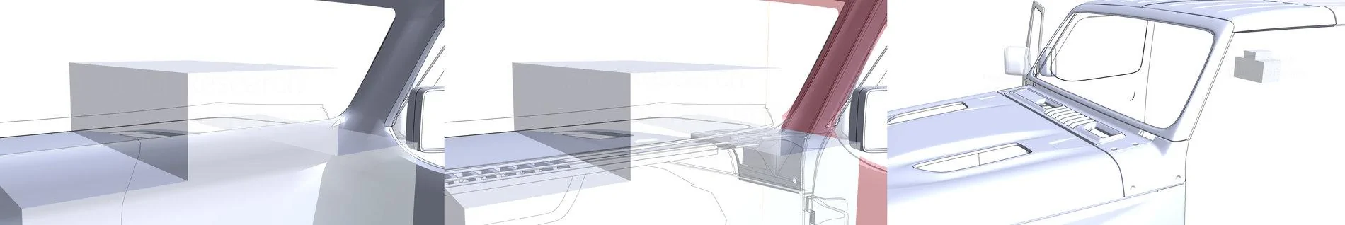

Jeep Wrangler JL Snorkel Prototype Factoring PrecisionResearch JL Stealth Snorkel 004
Aerodynamically designed so that there will be minimal wind noise - the trailing edge of the snorkel completes a kamm tail to minimize drag and eliminate wind buffeting with the passenger side window cracked open.

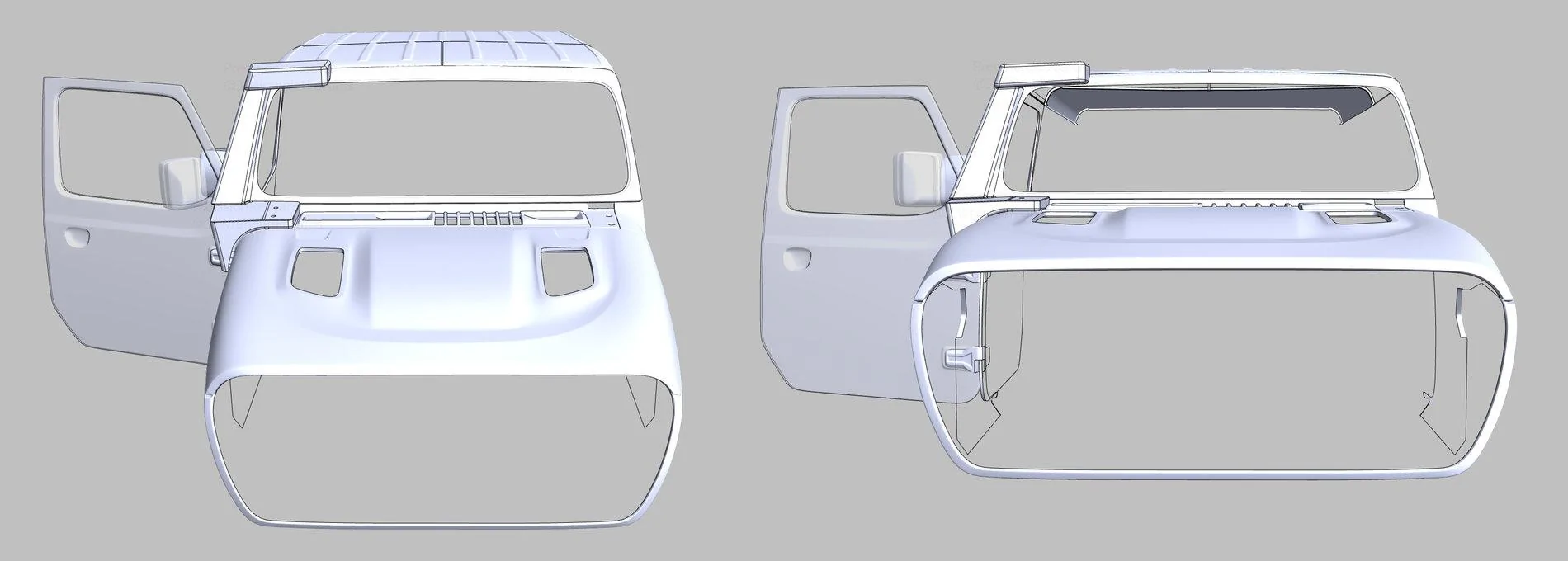

Jeep Wrangler JL Snorkel Prototype Factoring PrecisionResearch JL Stealth Snorkel 003
Please let us know if you have any requests and/or feedback,
Thanks

Not for me, but looks like a nice design. Are you going to do anything to make it more aesthetically pleasing? To me, the lower box on the cowl looks pretty bland.
Material? HDPE?
Drilling or cutting required?
Estimated price point?
New airbox under the hood or does it work with the factory box?
Dec 2, 2019
TX
JT
Material?
I don't know yet as we're not ready for production yet, but as we get closer we'll probably settle on some sort of cross-linked polyethylene with a strengthening additive and then passivated for UV resistance. We haven't ruled out colored additives either yet, though color matching per batch will probably be interesting.
The goal of going through the cowl piece is so that there should be no cutting required at least, but the design goals towards the windshield frame are currently no drilling required either.
OE intake box because of CARB. Not pictured but you can already guess that the under hood ducting runs from the cowl piece to the OE intake box.

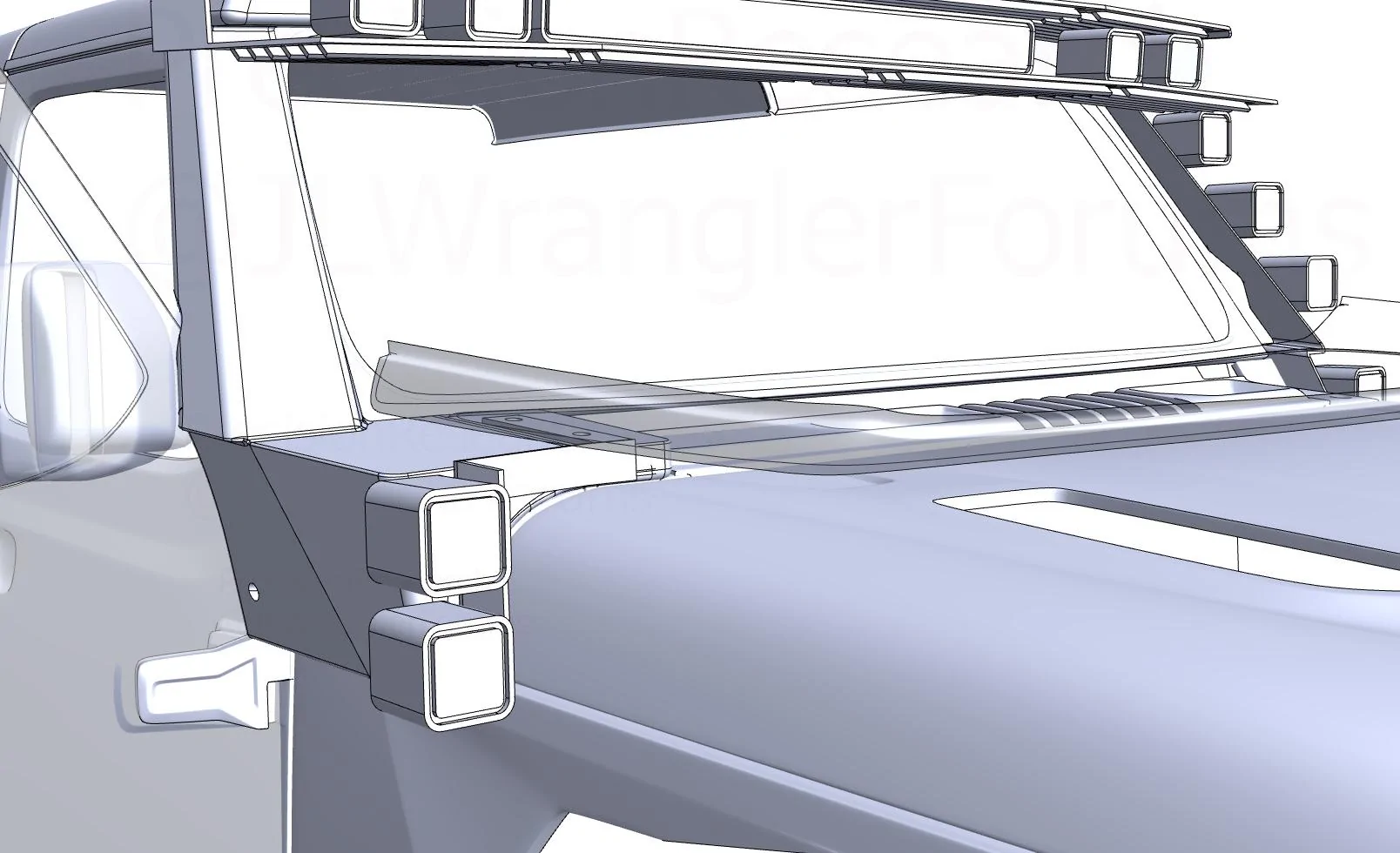

The logo and a light/aux/acc mounting system goes there:
Jeep Wrangler JL Snorkel Prototype Factoring PrecisionResearch JL Stealth Snorkel 006
We're hoping to start somewhere around the $500 range and then lets say if we're including a light bar or visor piece then it'll go up from there.
When dressed in full regalia:
Jeep Wrangler JL Snorkel Prototype Factoring PrecisionResearch JL Stealth Snorkel 007
