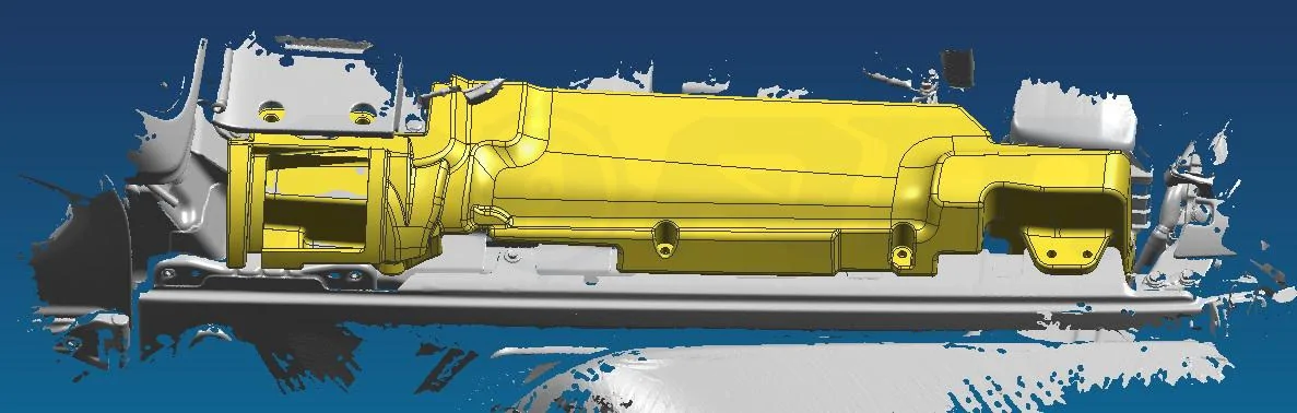

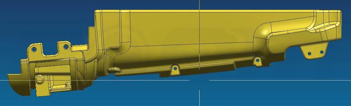

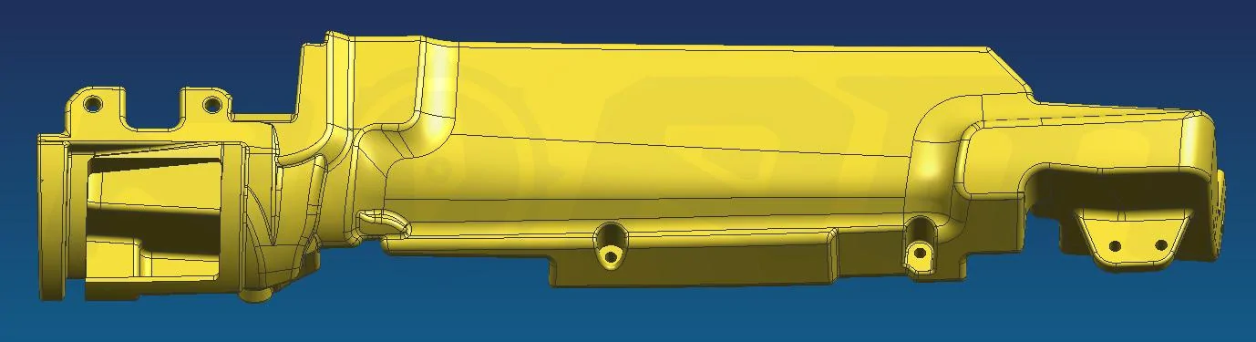

The base part of our JL stealth snorkel has a recess on the bottom to access the battery terminal so most if not all currently known dual battery kits should be compatible. Although if you are planning on running a dual battery kit the optional extended midship air/water separator assembly will no longer be compatible.Whats the chances it will fit with a Genesis dual battery kit?
Our JL Stealth Snorkel does not require drilling or cutting for installation. We'll include everything needed for installation including the cowl piece (pictured above in orange/peach).I’d almost consider this if it is truly plug and play.

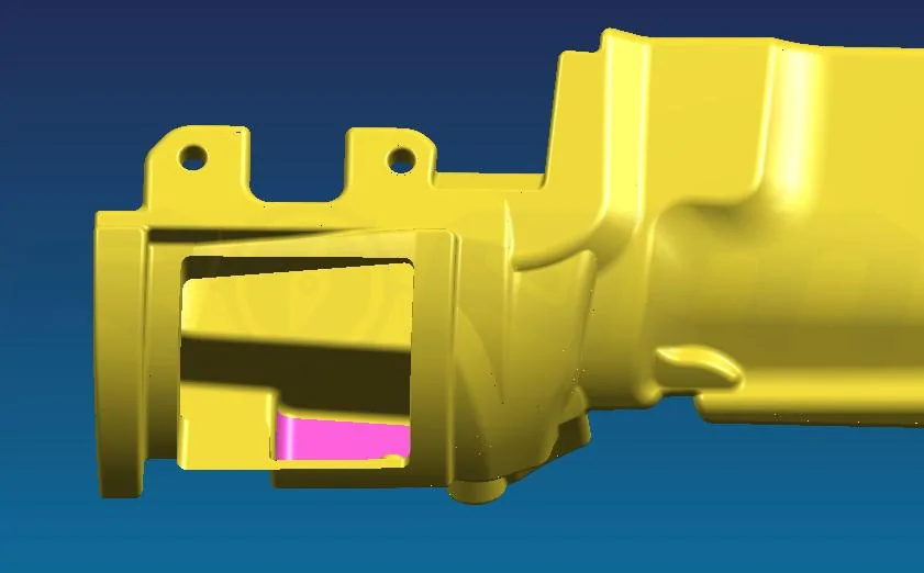

You can call it hubris but we're extremely confident that most of our stuff can not be knocked off by anyone. And while I understand that potentially there are those whom will try, what they'll find is that our innovation is not only core to everything we do, but there are quite a lot of features that are not reproducible without investing in either specific tooling or a really specific mold system. For example, we're quite confident that our air/water separator assembly and our CFD (computational fluid dynamics) development can't be replicated without going with either a one to one copy in which case then they'll need a pretty exotic multipiece sequenced mold, of which case in my opinion by the time they reverse engineer our mold process they might as well start from scratch, or their version just simply won't work right, given the space constraints. With our air/water separator assembly you can shove a garden hose straight into the intake and the air filter won't see a drop of water, but when submerged past the outlet the outlet itself is sealed against water ingress.Let's hope Roam remembers the great Mopar hood lock debacle of '18/19 and brings this to market sooner rather than later or we'll all be ordering copies on AliExpress

Did you monitor the air/fuel ratio during the dyno tests? The 3.6 could also be going lean at open loop & low RPM, which could explain the drop in power.After a few more rounds of CFD (computational fluid dynamics) development and factoring, we started over with a transitional or "variable" flow centric flow model instead. Apparently the venturi effect, helmholtz effect, and sizing the plenum correctly played a bigger role than previously theorized, and all influence transitional airflow, or in other words the "initial" momentum of air. So by making improvements to account for better "variable" flow and then eliminating low speed air tumble regions and air merge paths, we've eliminated a bunch of flow restrictions that are apparently only present during low airflow speeds which our superflow flow bench testing did not show because it measures at a constant setting.
