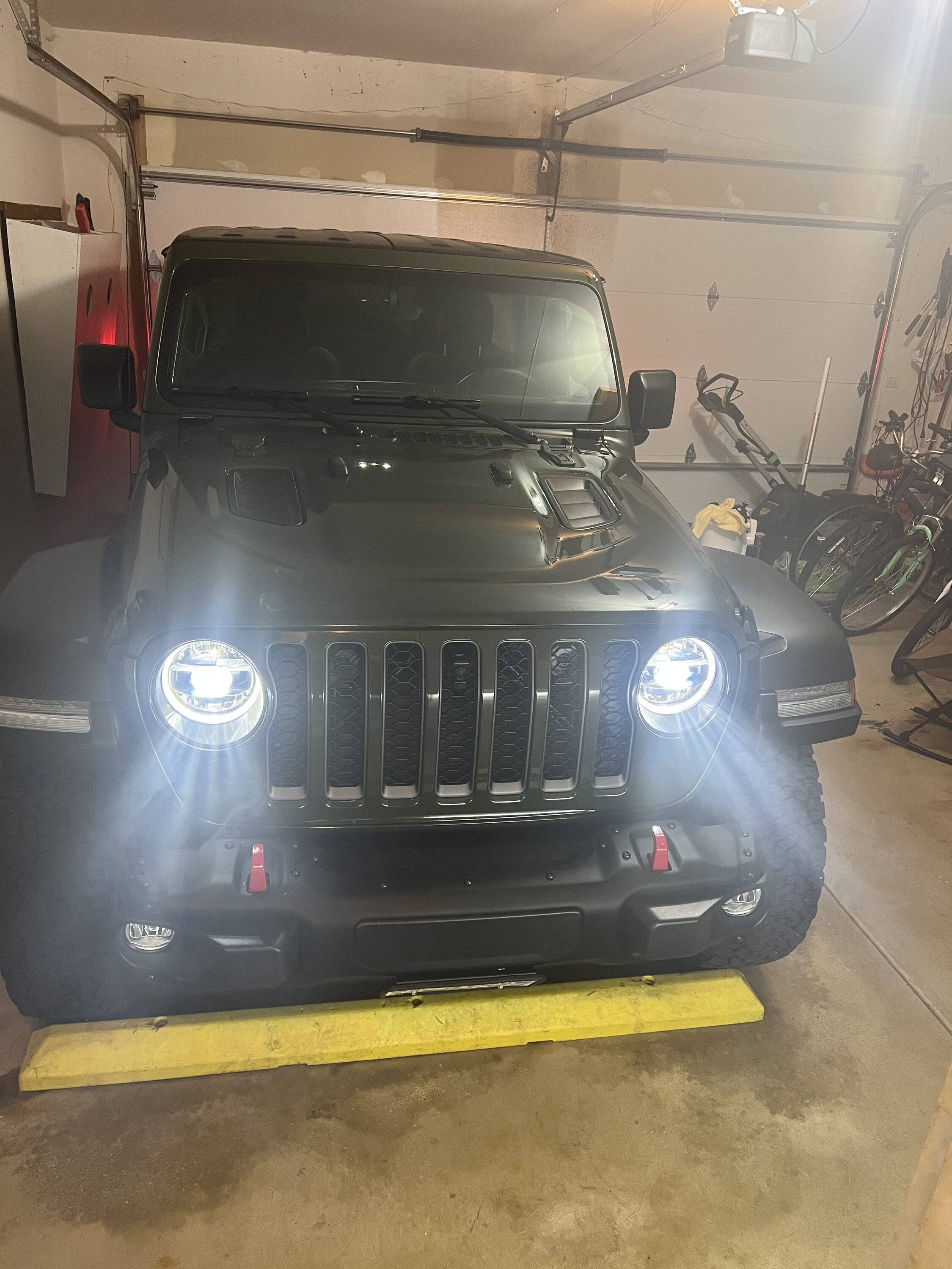

Strange thing just happened. Went out to a smoke filled garage. Jeep was parked for about 30 minutes. Maybe was in passive regen or something? Can find anything melted or burned. I guess I’m parking outside for awhile. Let’s see how this plays out….. lol No the Jeep wasn’t running. Lights are on because I opened the door.
