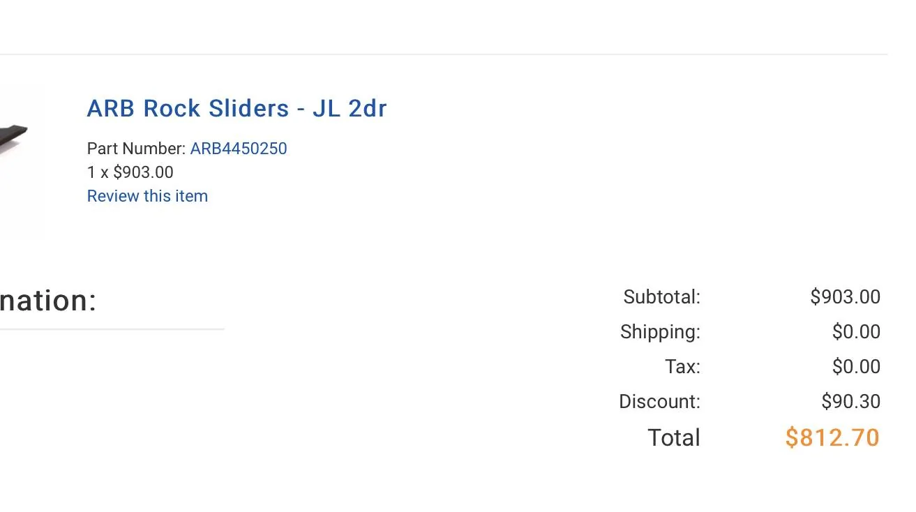

As @GATORB8 pointed out, it depends. But it’s also been decent and no need to wait for sales. As it’s always been close enough (when they have sales, you can’t combine the code). Some stuff you won’t get a discount on anywhere, such as AEV.
Jeep Wrangler JL Sliders/Steps while keeping factory rock rails C7A97470-1218-4272-80FF-EA2B575D93F1
But here’s an example.

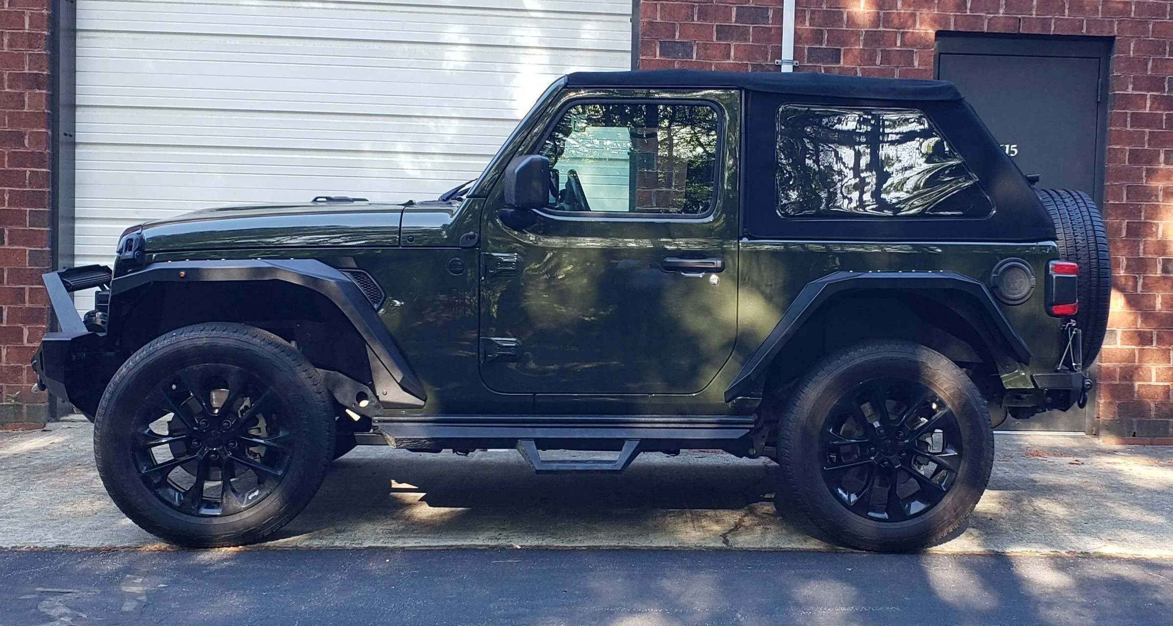

I added these Rough Country step rails to the factory rails by drilling and tapping the factory rails for the inboard bolts. I got rid of the pinch weld bracket and had to fab a front mount because it needed to drop about two inches on the outboard bolts.
If I'm heading to somewhere with rocks, just 4 bolts each side and the steps are off.
