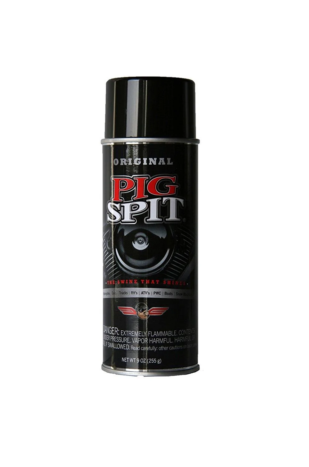

Rubi rails are steel and they are coated and yes, will rust over the long haul, especially if scratched, etc..
I have had Rubi rails or as you called them "rock rails" on a few JK's over the years. Also, have had Ace Slider's on the same vehicles.
A product I have used for many years, now that protects the Rubi rails and the Ace Slider's, along with keeping them looking great is a product called Pig Spit. Talk about something that does the deed.
Just wash the Rubi rails and or Ace Slider's, let them dry well and then spray say 2 light coats of Pig Spit on them. Let the Pig Spit dry...
Now, if you like a slight sheen as the end result do nothing further.... but, it you like a more subdued appearance, just take a clean cloth and wipe the Rubi's and Ace's down slightly.
Regardless of whether you wipe lightly or no, do know that your goodies have a protective coating that also looks great.
I have used Pig Spit on my Harley FatBoy 01 for over 17 years. The black heads on that FatBoy look as black and almost as new as they did back in 2001. Also, keeps the Wrangler Rubi Rails and Ace Slider's looking like new also.
Pig Spit Original:
https://www.amazon.com/Pig-Spit-PSO...pID=31Eo4TbUbvL&preST=_SY300_QL70_&dpSrc=srch
