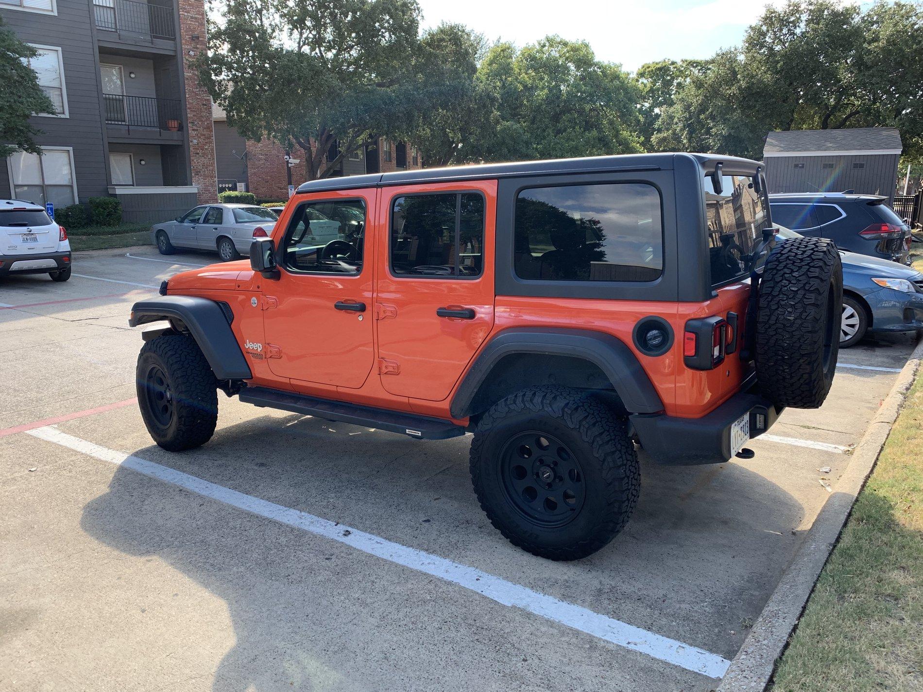

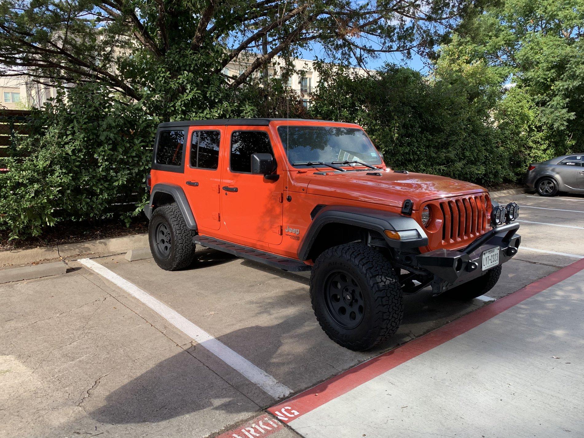

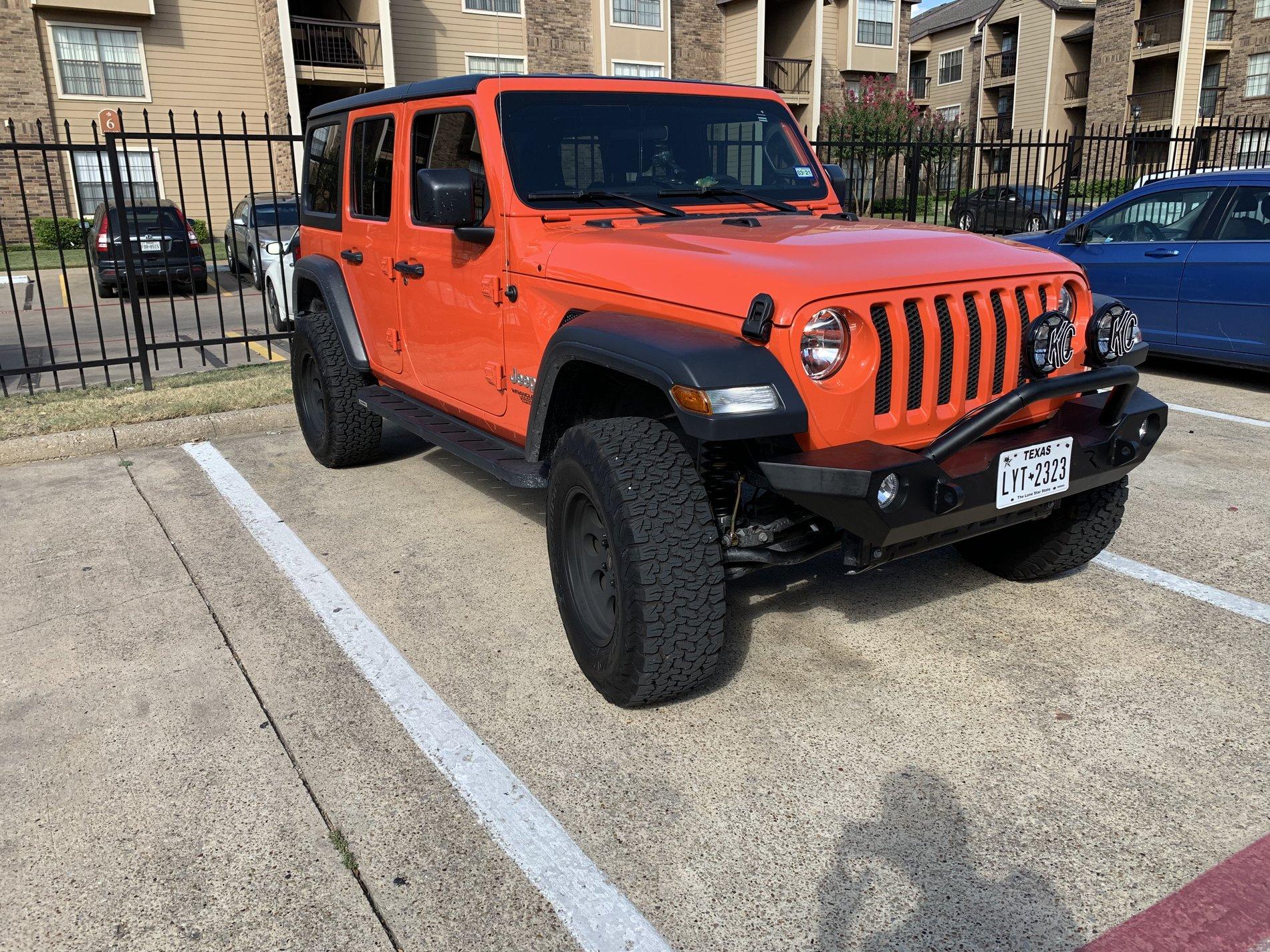

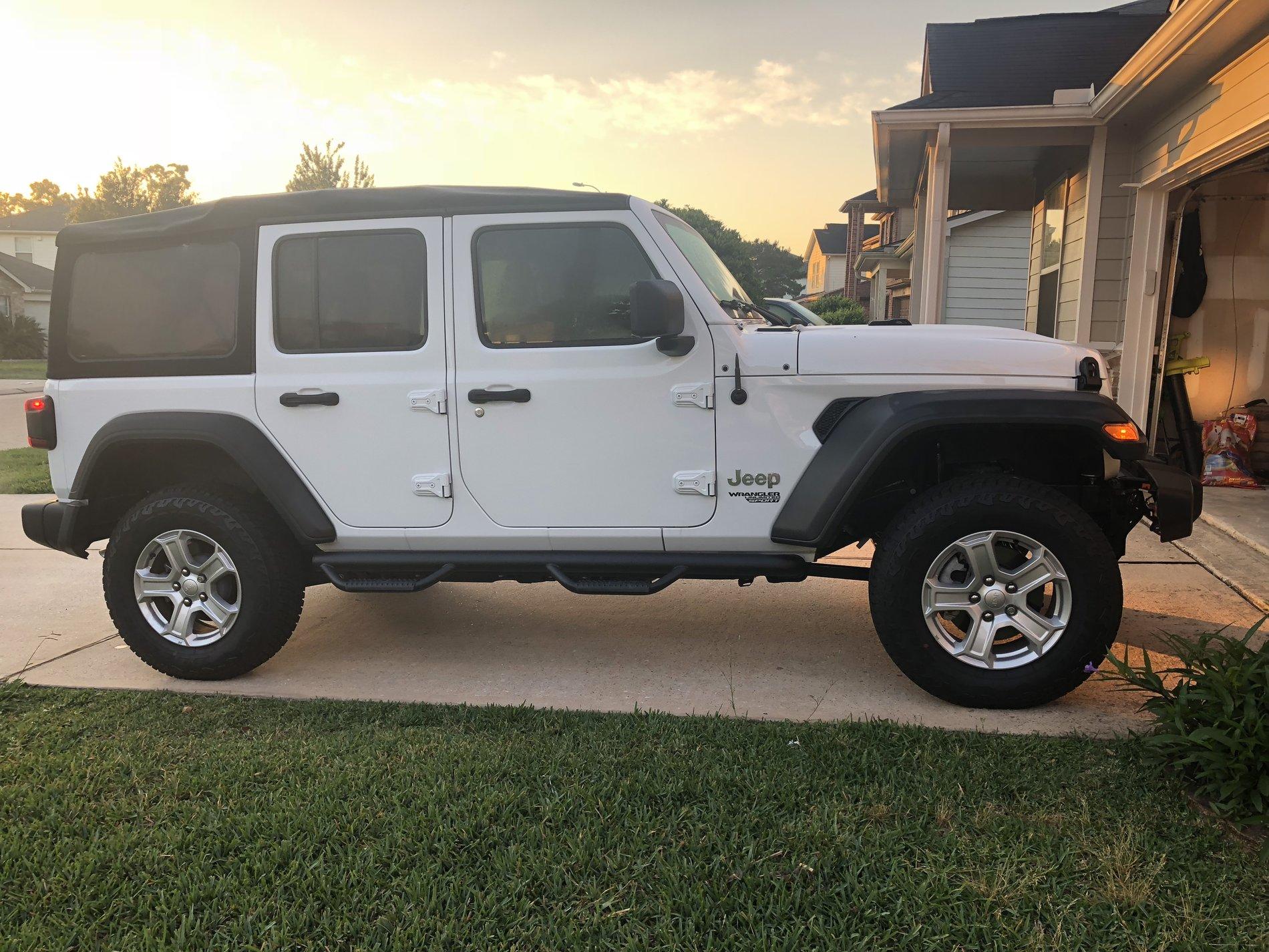

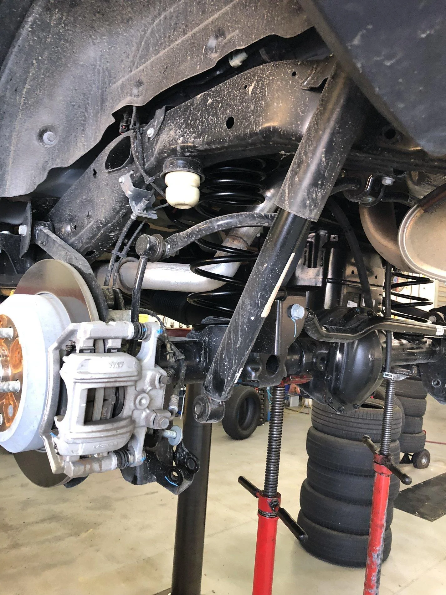

I just installed the 2.5 skyjacker with m95 shocks on my jl im running 285/70r17 ko2s .. i was planning on going for a bigger tire but I’m really liking how it looks so I think I’ll keep mine on those tires for now
