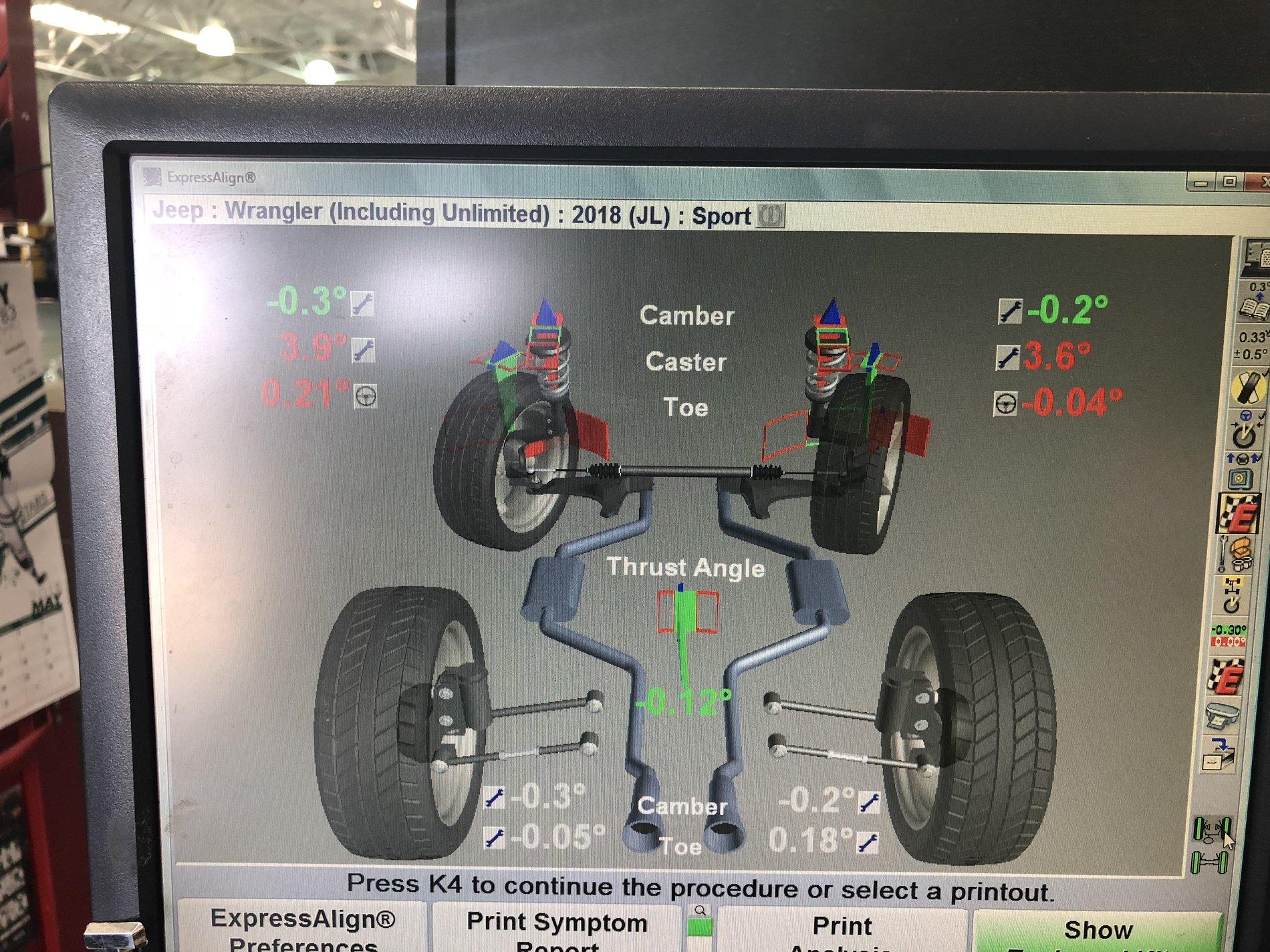

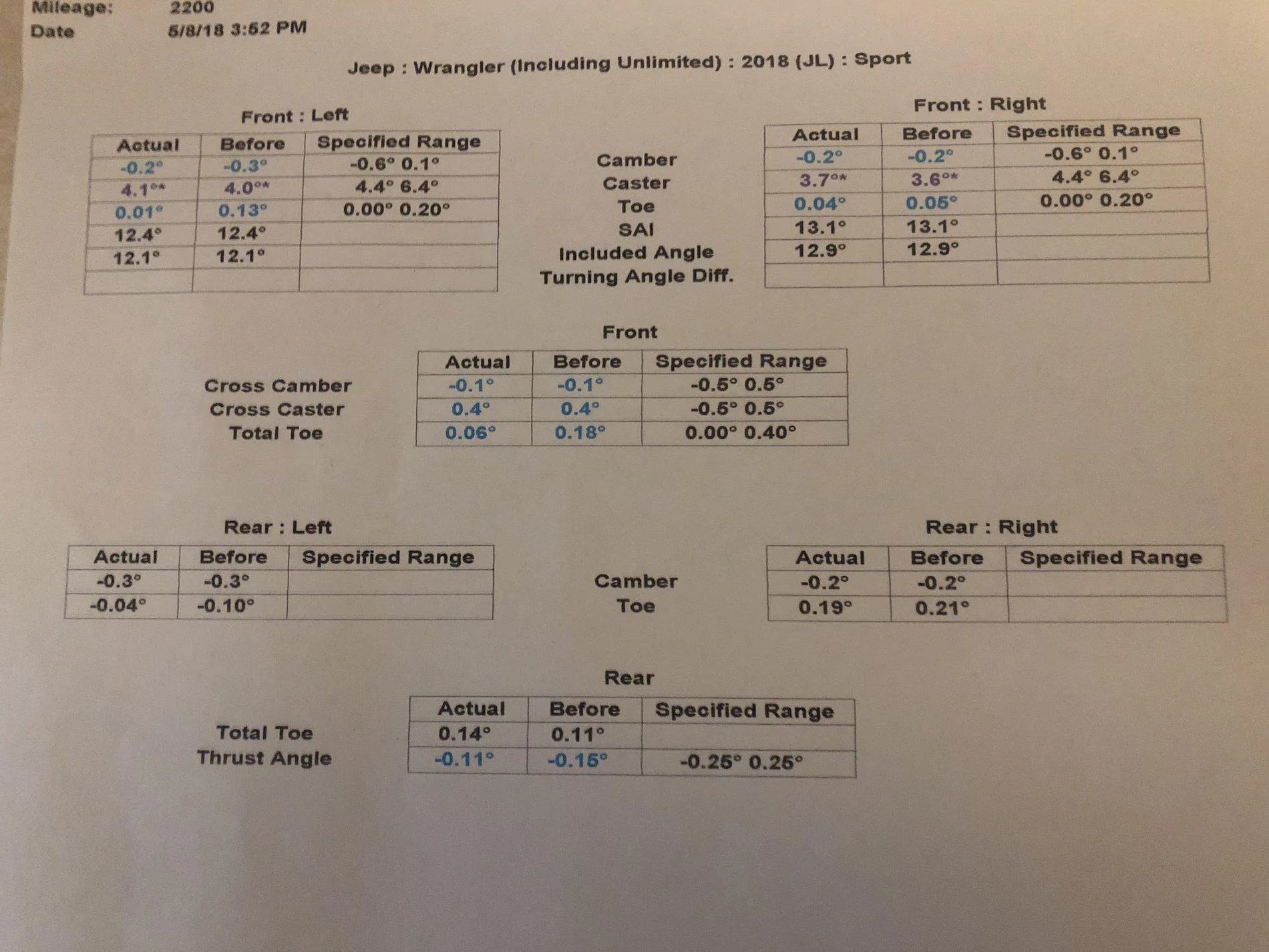

Doesn’t look like caster moved much at all if your before numbers are goodI Also performed a Wheel alignment. As I suspected the caster was off on the front. I could feel less directional stability. I need to increase it by a couple degrees on both sides. Who makes some really beefy adjustable control arms that are reasonably priced. I don’t think the skyjacker ones are available yet.

The before numbers are after the lift was installed. I didn’t check it before the lift. I have nothing to adjust the caster with that is why I need the adjustable arms.Doesn’t look like caster moved much at all if your before numbers are good

Being adjustable, you can get whatever caster you want... I don't know what the baseline caster is going to be on the JL, but I'd shoot for 5.0 to 5.5.I went ahead and ordered the Rusty’s with flex joint. I’ll replace the rear arms later. I’ll let y’all know how they turn out and what kind of caster I get out of them.
