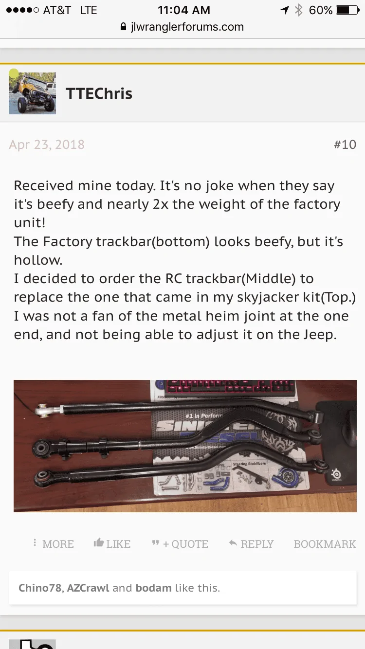

You should take a look at the Rough Country trackbar. It's adjustable on the jeep and very beefy. Also the price is cheaper then a nice dinner at $140.00. You probably really don't need an adjustable trackbar but I totally get wanting everything perfect even if it is a 1/4 inch.Looks great! I want to get the skyjacker control arms and track bar to dial in everything perfectly
Tired of watching me work on the jeep...lolWhat did you get your dog to help with the install? Looks pooped - time for a beer! Looks great, I agree on Mopar pricing - plus their springs are bowing on install... sheesh!
I’m not sure about this type of bar it would only be as strong as the weakest part and that would appear to be the adjustable sleeve part. How strong is the sleeve?You should take a look at the Rough Country trackbar. It's adjustable on the jeep and very beefy. Also the price is cheaper then a nice dinner at $140.00. You probably really don't need an adjustable trackbar but I totally get wanting everything perfect even if it is a 1/4 inch.
https://www.roughcountry.com/forged...MI7_LmoZv12gIVi8DACh1cYQo8EAQYASABEgLbAvD_BwE

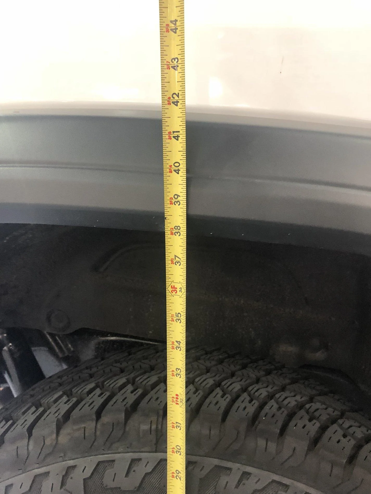

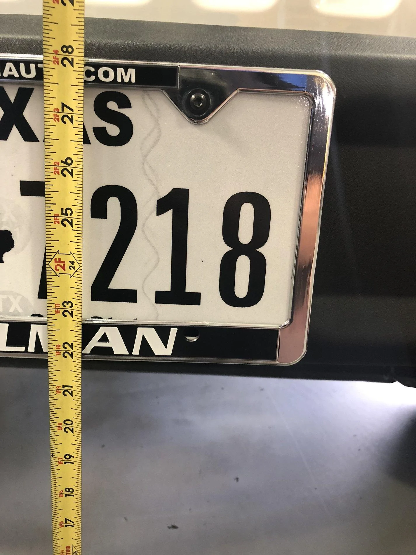

I’m took the pictures just as I set it down I’m sure it has settled down a bit over night. I will retake the measurements tonight when I do the alignment. It looks more level to me now but I would like the back slightly higher for towing. The ride is nice! Feels stockHi @Craigb , a couple of questions...
From your photos, it looks like you got 2.25" of lift in the front and 2.75" of lift in the rear. Are my numbers off? Those numbers are surprising to me for a couple of reasons:
Here's how I got the numbers - hopefully I'm off somewhere:
- I was expecting less lift, given that this is marketed as a 1.5" lift (you did install the 1.5" lift, and not the 2.5" lift, right? Post #8 indicates 1.5", so just double checking...).
- We'd typically want a slightly more aggressive lift in the front compared to the rear, to help with leveling - this appears to be the reverse.
Lastly, how is the ride quality compared to stock? I know it's early, so please keep us updated.
- FRONT: Started just shy of 26" and ended at ~28.25" = 2.25" (based on the license plate picture in post #23)
- REAR: Started at ~35.5" and ended at ~38.25" = 2.75" (based on right rear fender picture in post #26)
Thanks!

Here is a thread about it. https://www.jlwranglerforums.com/fo...ront-jl-forged-adj-trackbar.6986/#post-161439I’m not sure about this type of bar it would only be as strong as the weakest part and that would appear to be the adjustable sleeve part. How strong is the sleeve?
Well looks like it ended up 2.0 in the front and 2.25 in the back. It is level side to sideHi @Craigb , a couple of questions...
Thanks!
