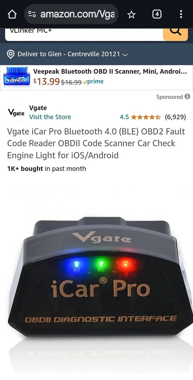

Im planning on upsizing my tires from stock 285 70 17 to 305 70 17, im new to this and dont know excactly which OBD adaptor to get.
This is what im thinking of getting from amazon and downloaded jscan app already. Am i on the right track?

Do these adapters dont connect directly on the obd port under the dash?
When adjusting settings (tire size, TPMS, etc) you need to use the cables from the security gateway located under the driver side lower dash kick panel. OBD port can be used to read and clear codes.

2021 Wrangler Sport S JL
I just installed the Tazer Lite. It will do what you need, plus other changes. I got the refurbished unit from ZAutomotive direct. Not an ODB plugin, as mentioned before. It's direct into the SGW plugs . Quick and easy install once you locate the plugs on your version of Jeep.
