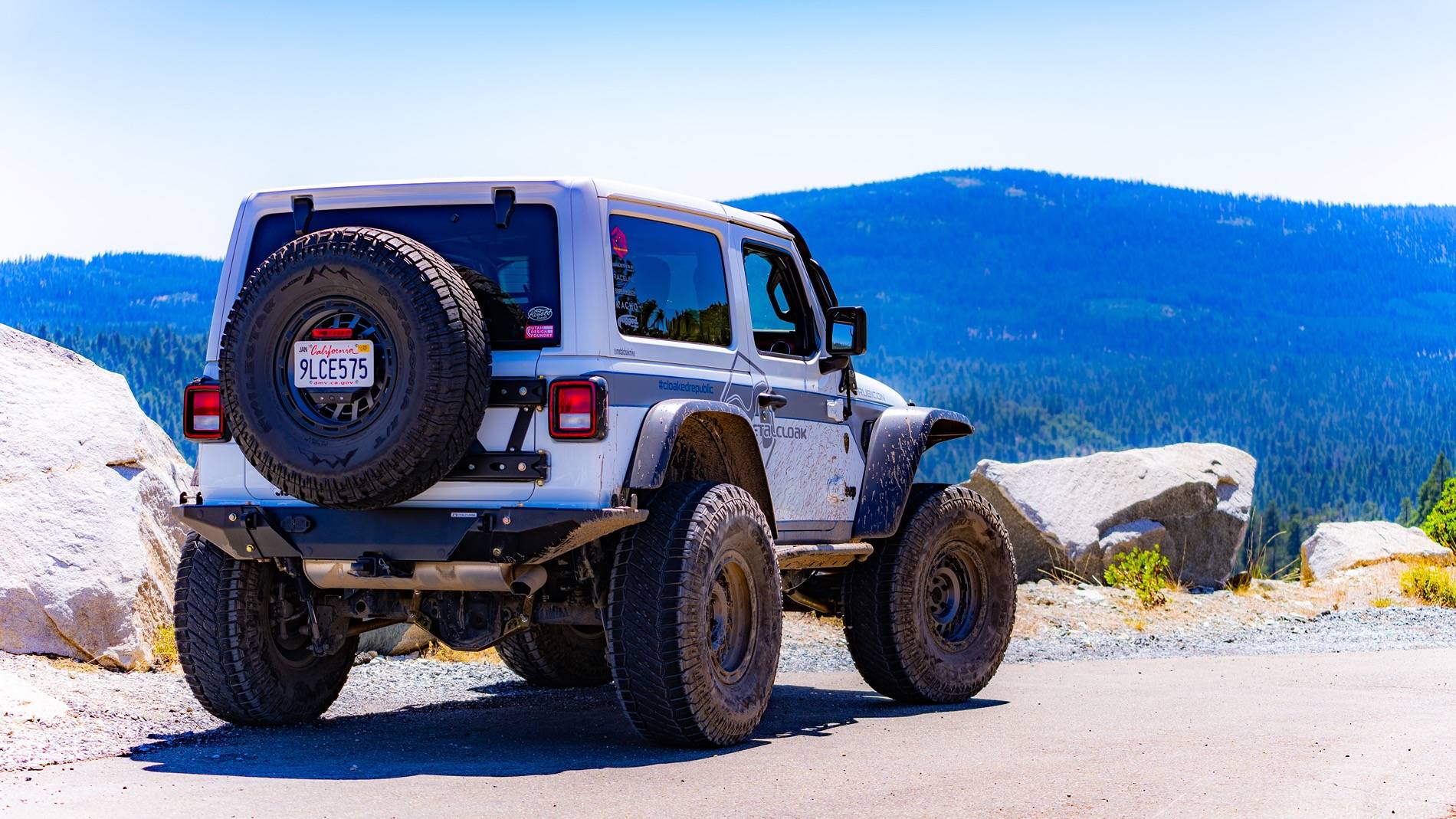

I have the 3.5” Game changer kit on my 2-door JL, and If you’re going to carry a few hundred lbs, upgrade the rear springs to the next size, trust me. 😉. I have the 4.5” spring in the rear, which is a stronger load rating and it sits level even when light, but won’t sag under load. Call the office and they can set you up.
This pic is empty and it looks the same once full… (maybe a slight dip in the rear)

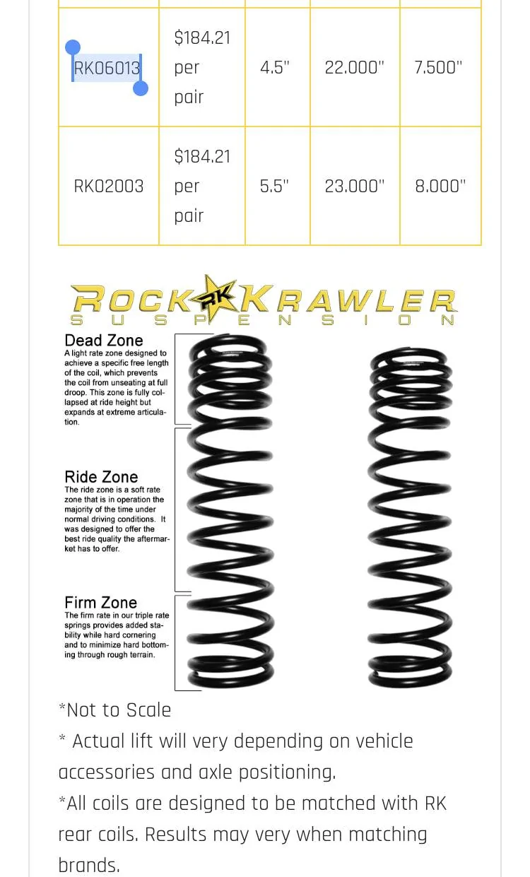

MC dual rate spring is as Roaniecowpony has said the first rate is just a soft portion that fully compresses in order to keep the spring tight even when fully flexed.
Rock Krawler has triple rate springs which incorporate a compression zone to keep the spring tight when flexing out, a ride zone, and an overload zone.
