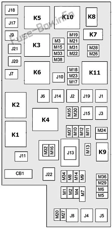

Maybe a quick check of the fuse? Mushed bulbs will often blow one -

Oooh! Never thought of the fuses!! LOL OK I'll see if I can find them and check as soon as I can get away from my desk. I really appreciate your helping me - I know these are lame questions - but I always had a mechanic I could trust - then I moved to FL and have no one - trust no one! So Im trying!! Starting small tho! Be careful, I have a TON of questions :0) Thanks! I'll be back as soon as I check the fuses!

Awesome! I did find it - fuse looks fine - I tried again and passenger side works, drivers side ..... must have a bad connection - I can get it to come on but any movement and it goes out again. One of the guys at work was messing with it - (I dont like anyone touching my Jeep UGH!) but they finally had to go to a meeting so I wiggled it until it came on and got it screwed back into place - Id imagine first bump in the road it will go out - but thats ok for now at least I know. I cant thank you enough! You taught me a lot of little things that to me are big things! Wanted to swap out my headlights but Im afraid too LOL - I know the front grill has to come off - she is 13 yrs old - I dont want to mess with it, lots of rust from being in NYS all her life (salt)- maybe I'll wait til I have no other choice!! And hopefully you'll be around when I have more questions as I find my way around Bella Blue. (Thanks for not laughing at my small issues!!) Now I have to figure out whats wrong with my front end but FIRST - gotta get her new shoes and aligned then I'll be back for y'alls expertise!!
