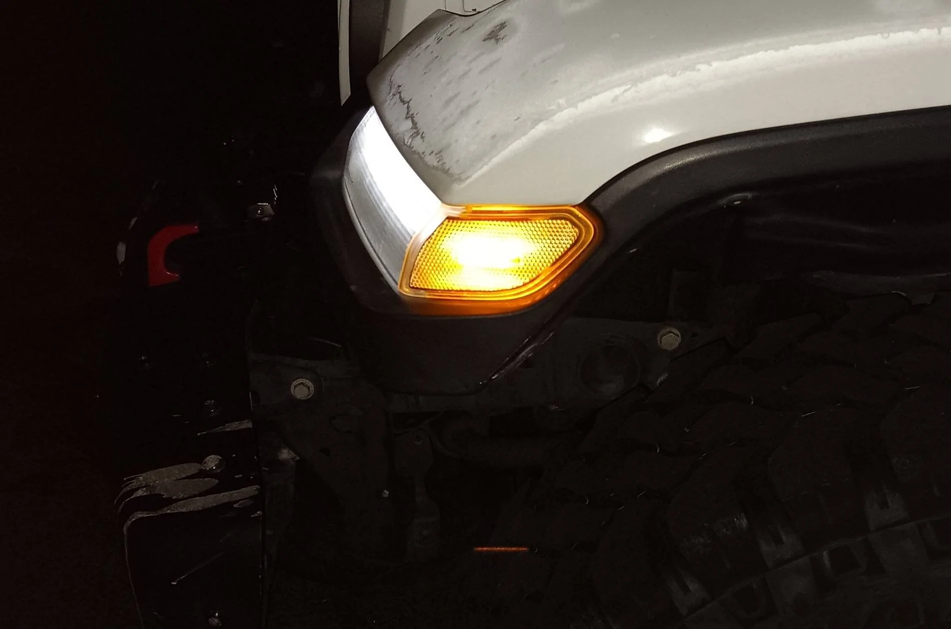

Yep they all look cheezy in regards to bright lines or a dot matrix appearance. I'll take a picture of my working one to show how well it equals stock... other than the failed one.

There is some glare from phone flash below the light source behind the lense.
I will attempt to repair the bad light this Friday. Weather permitting.

Ok, I pulled my bad passenger side clear marker light. Found that it is a Diode Dynamics branded marker light. I noticed, when removing the connection, that the connector was loose from not being fully seated. Obviously VA winter chills and rain eventually took its toll and made a loose electricall connection become a no connection.
I thought Jeep had a light warning system for bad bulbs. Well I never got any indication about the side marker being bad.
Easy fix was to reseat the connection fully engaged.
I can live with it for now.
