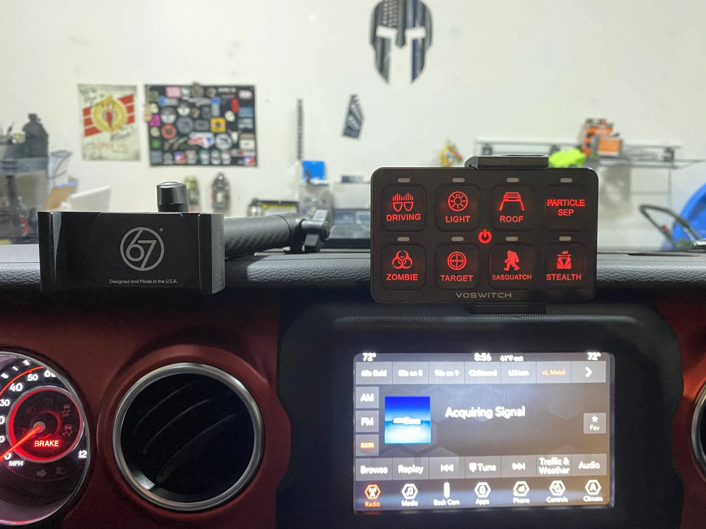

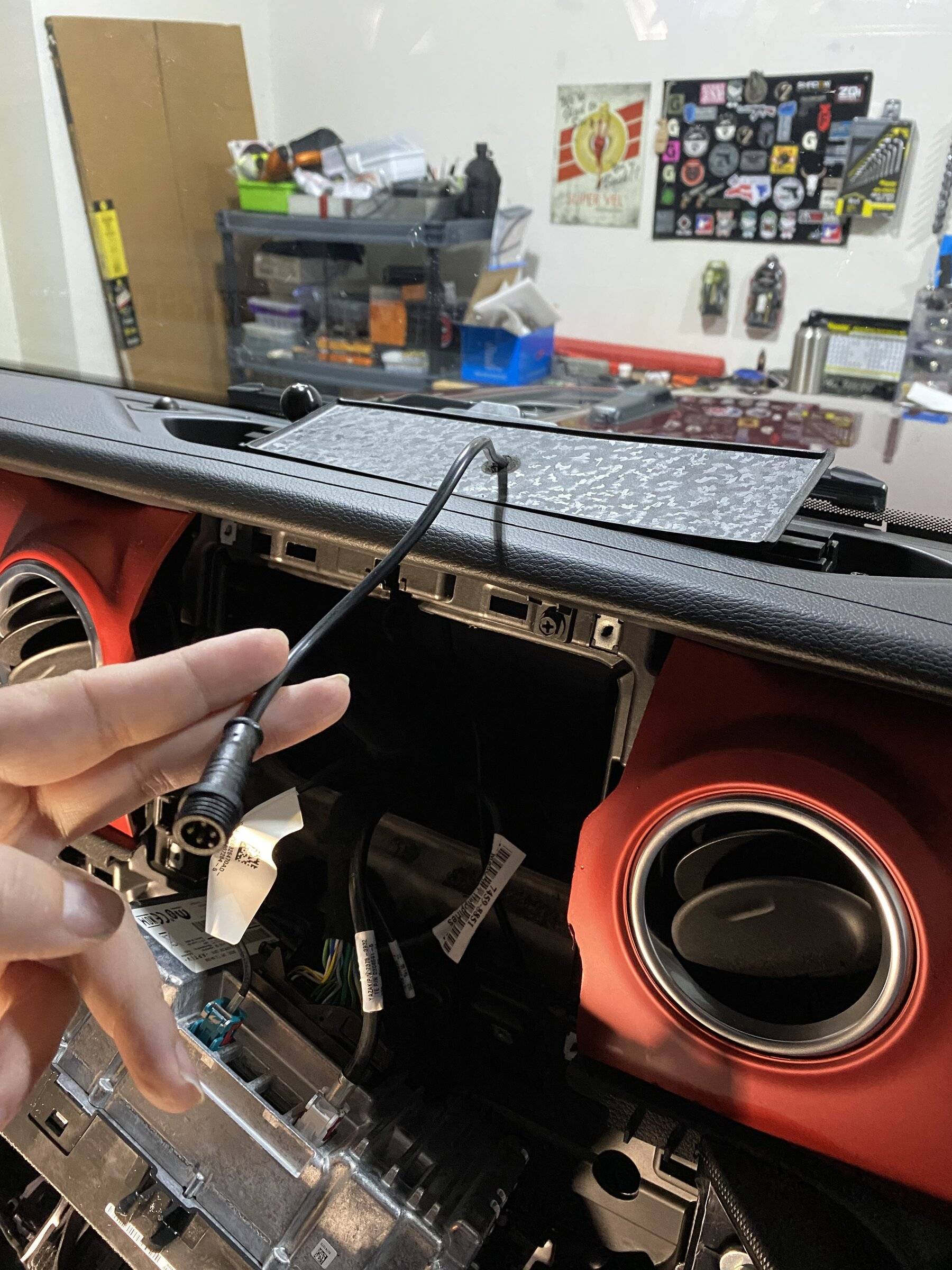

Install is super easy and connecting any doodads you want is also easy. I originally had the switch setup that goes in the factory location, but I swapped it out for this setup above the radio on a 67 Designs phone mount.

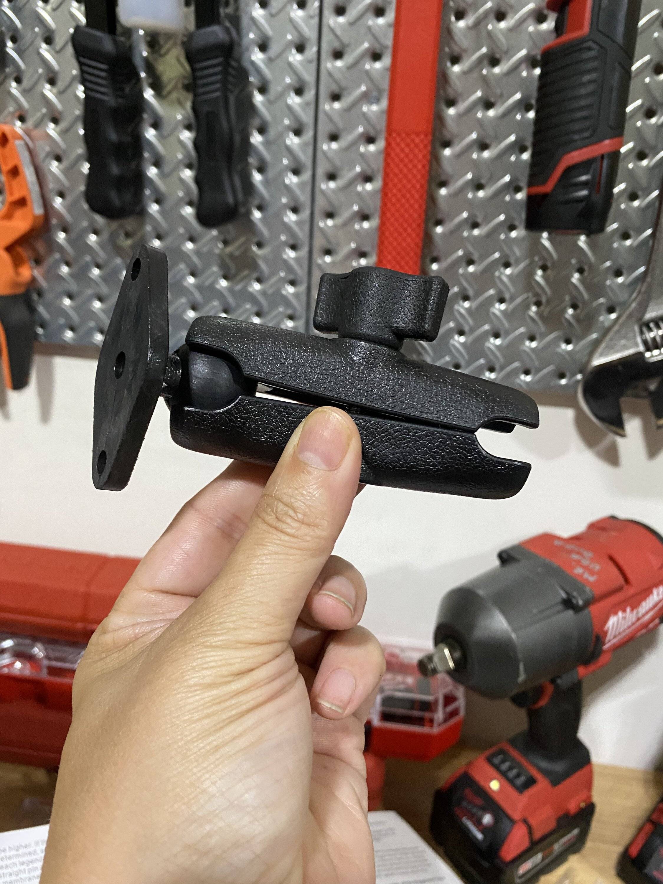

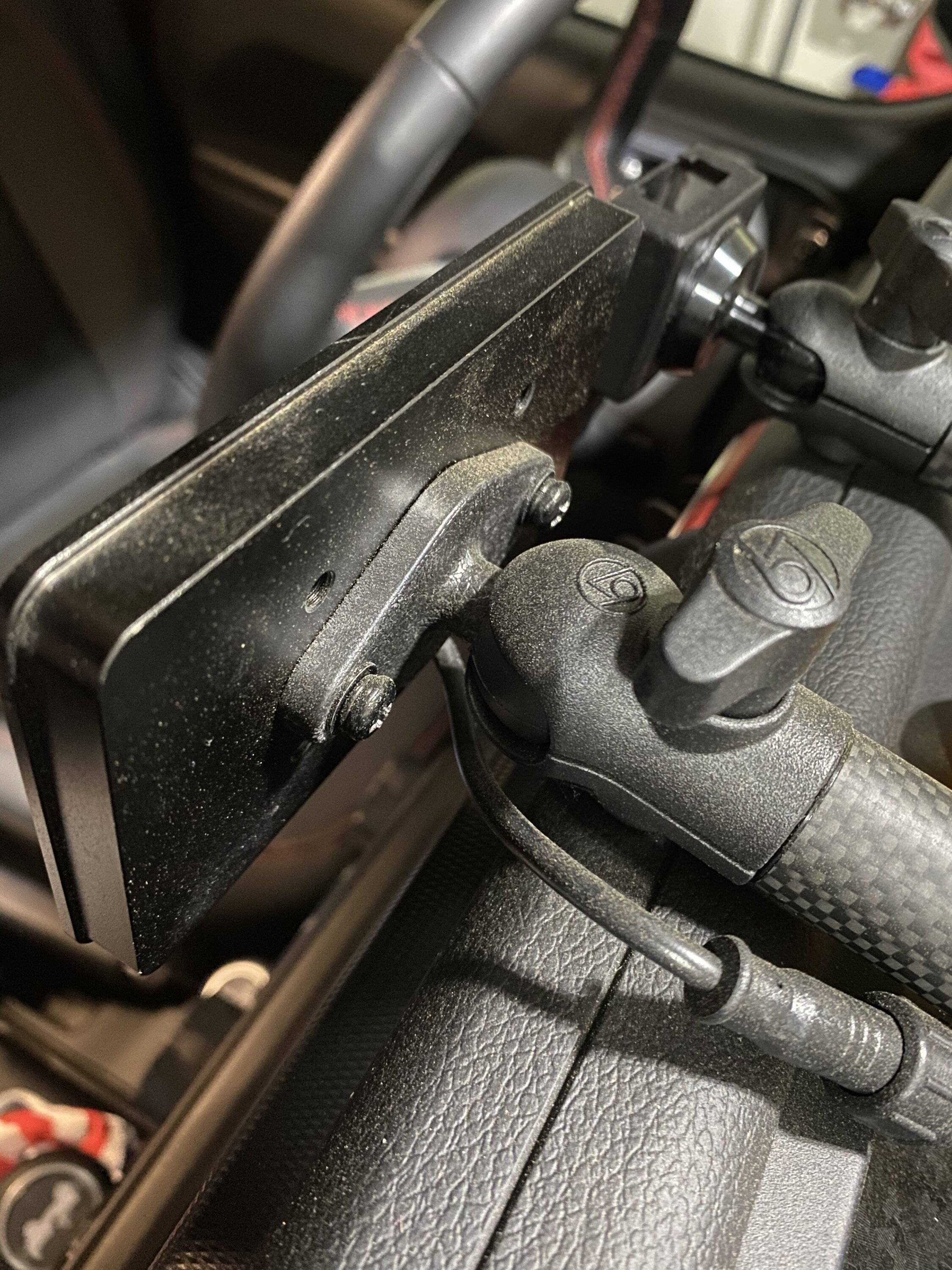

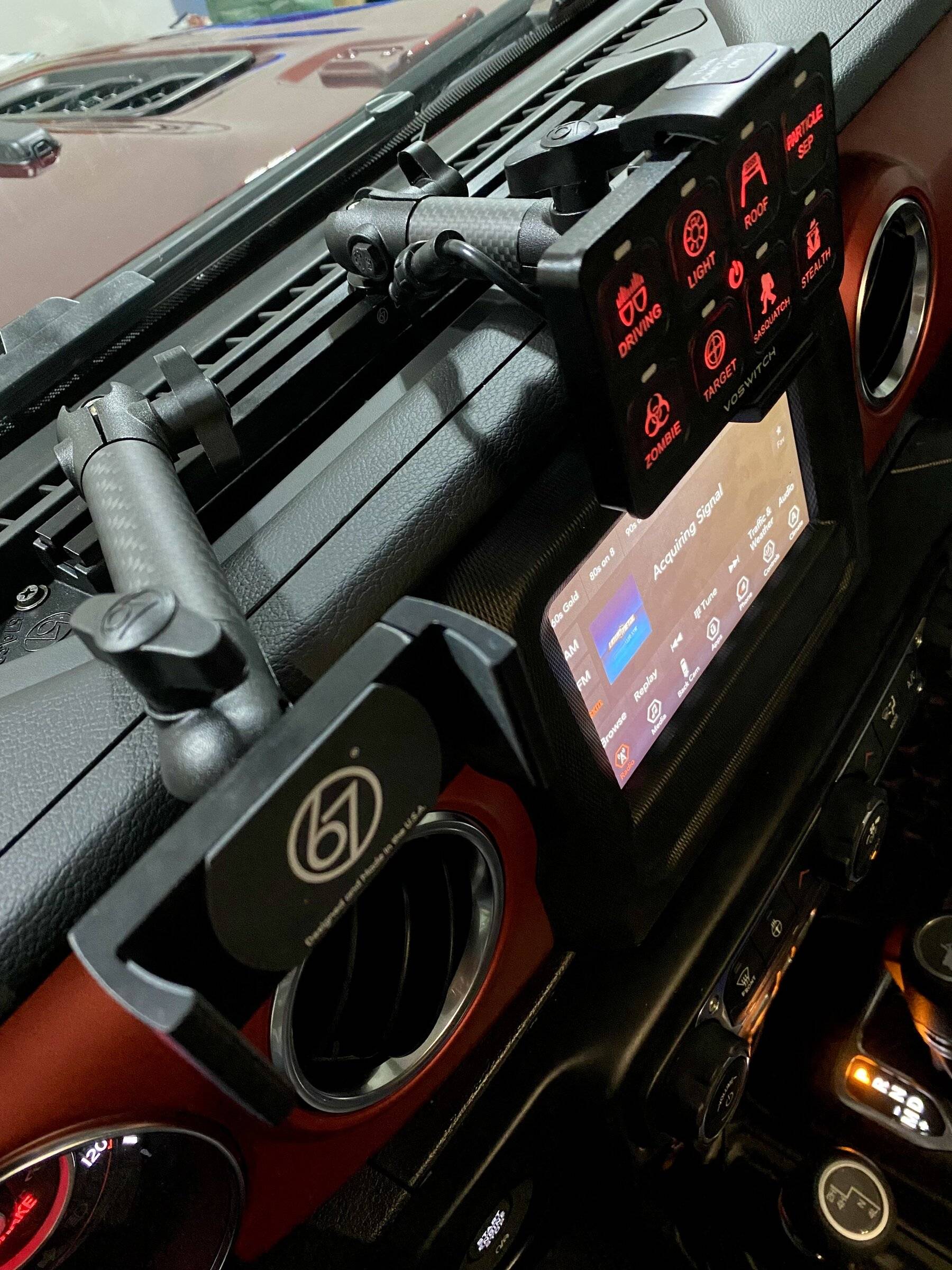

Any idea if the 67 Designs ball mount will also work with this switch panel? Thanks.
It will. This set up came with an arm from Voswitch. I used the ball mount that screws to the back of the Voswitch which is 1” and discarded the Voswitch arm.

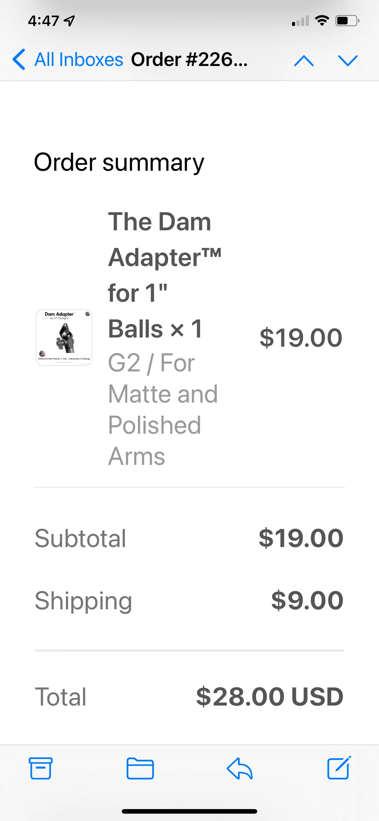

I then used a 67 designs arm I already had and ordered a Dam Adapter from 67 designs that would allow me to mount the Voswitch to the arm.
