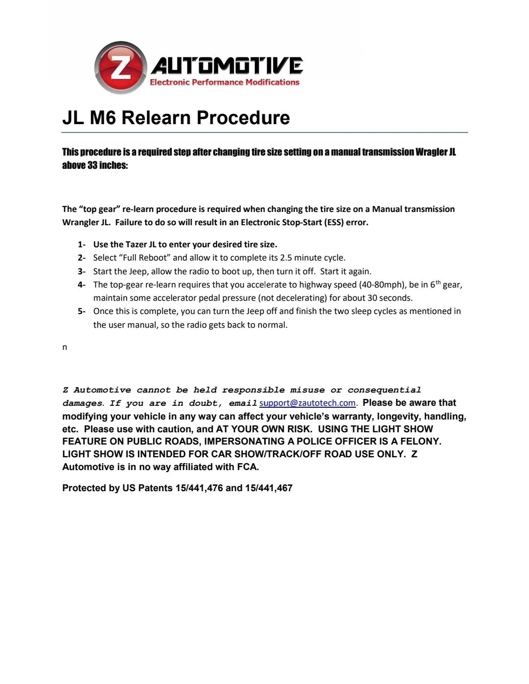

I just bought a 2018 Unlimited Sport with a manual trans. It had 35s on it when I bought it and I found out they did not recalibrate the spedo so I bought the Superchips Flashcal F5 and recalibrated my spedo. Now whenever I hit 5th gear I get a message saying that my stop/start system needs to be serviced. Did disconnecting the batteries help? If so, how long did you leave them disconnected?
Gawne Jeeping
Nov 24, 2019
Manitowoc, WI
2019 Jeep Wrangler Rubicon
To anyone having this issue, I would 100% recommend disconnecting both batteries for 20-30 minutes, then doing step 4 of the gear position relearn procedure that Tazer has. I have a Superchips and it worked for me. My Jeep has been back to normal for over a year now.
Jeep Wrangler JL service stop/start system - no reverse lights or back up camera Screenshot_20210702-065801_Word
