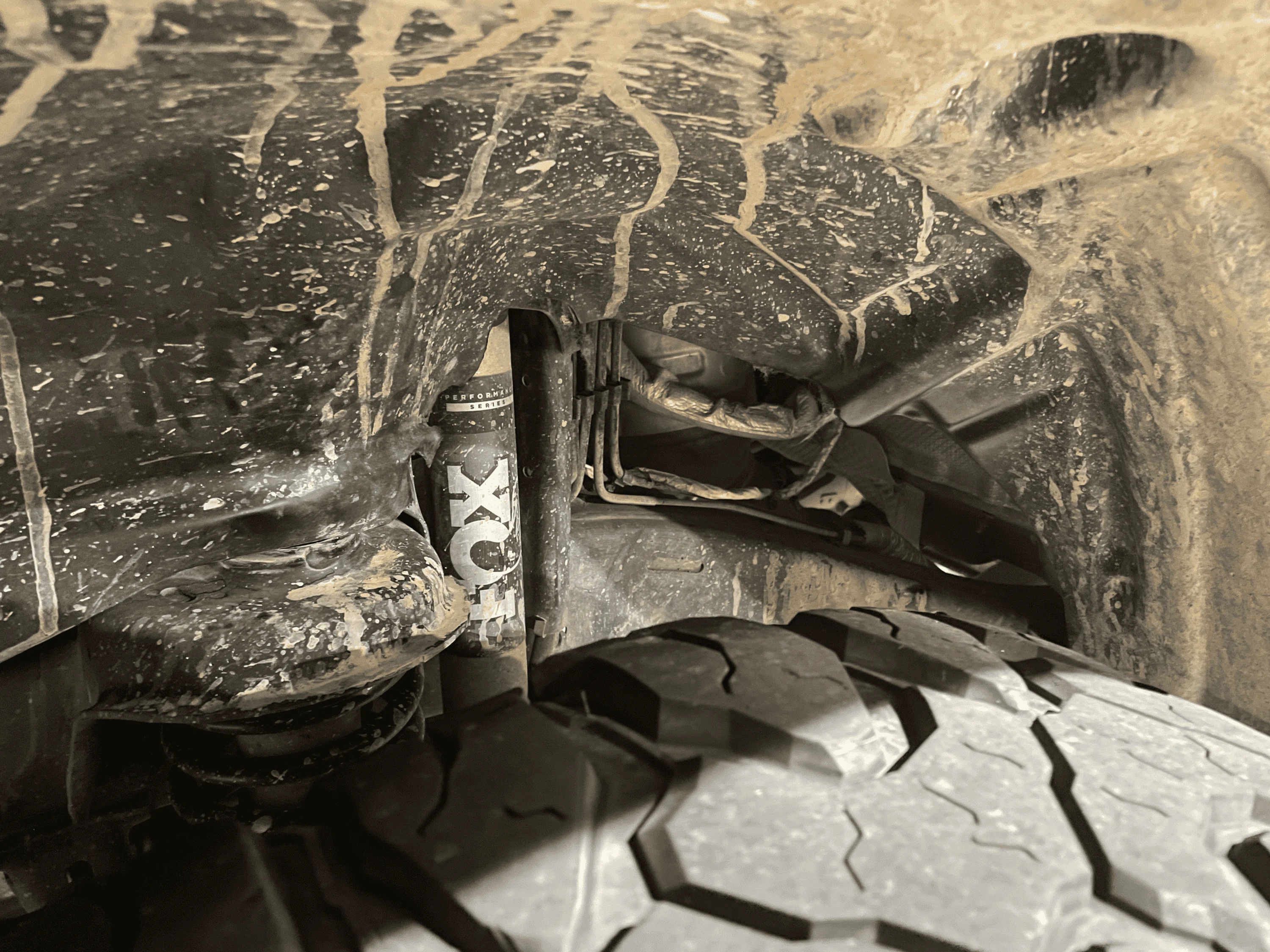

I zip tied the fender liner to the shock tower/frame to prevent it from rubbing for the remainder of my trip.

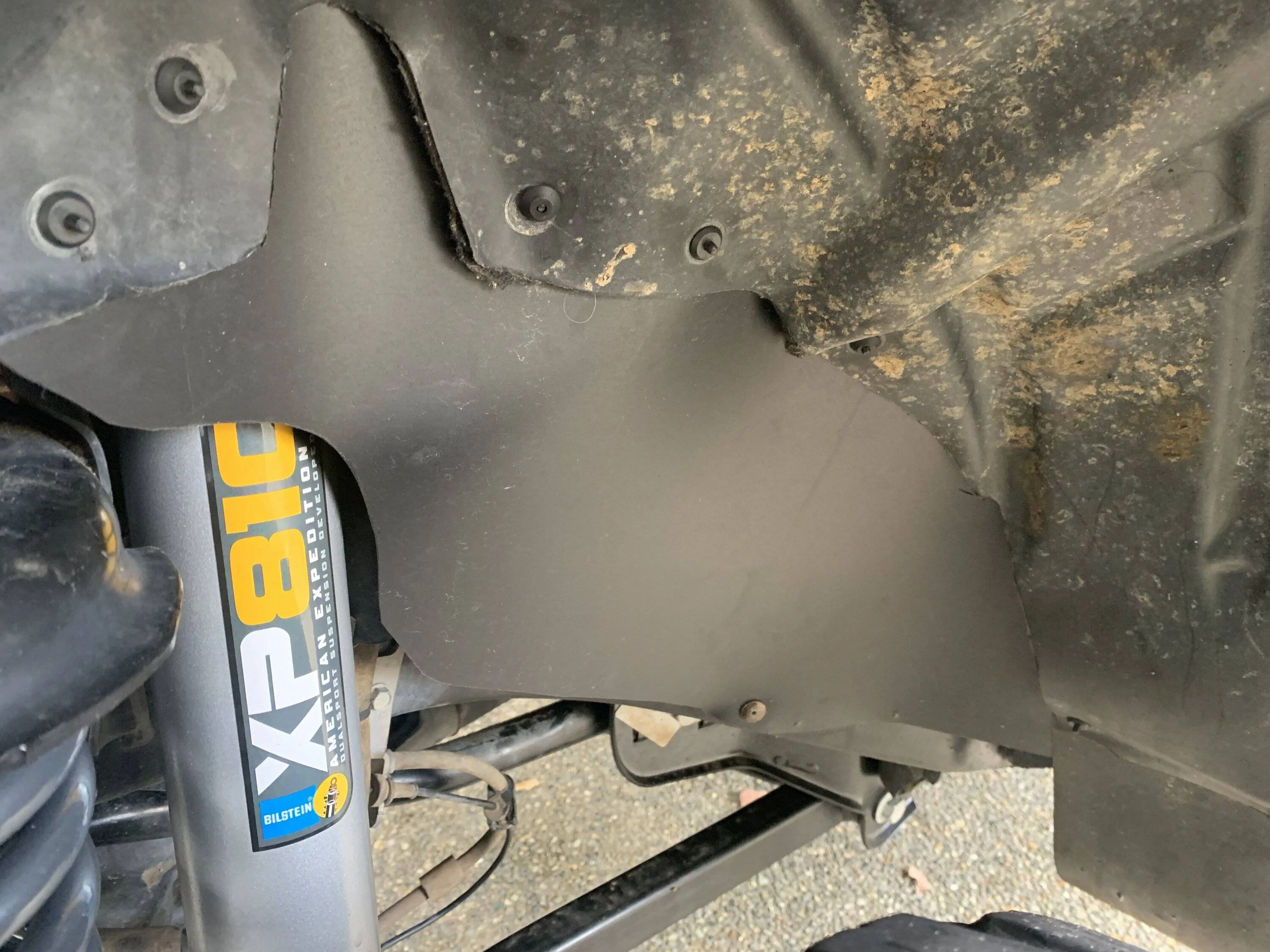

Used plastic pop-rivets to repair and extend them for better coverage; made a sheet metal clip for the hole in the frame near the back of the wheel and attached the bottom there, No problems since.

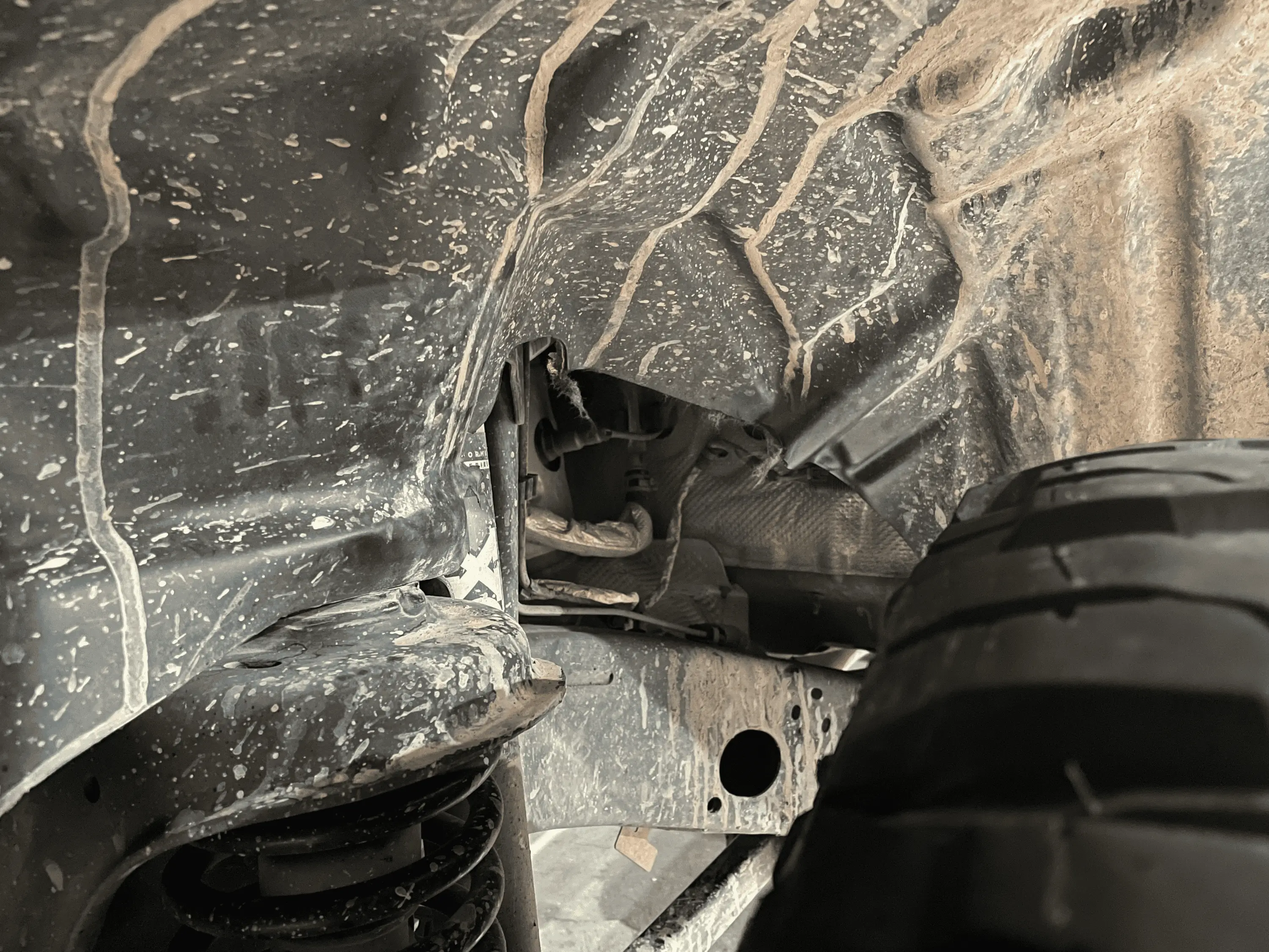

Artec on my JL / Nemesis on the JT specifically for the Falcon shocks
I’ll get better pictures in the morning, found this one on my phone
