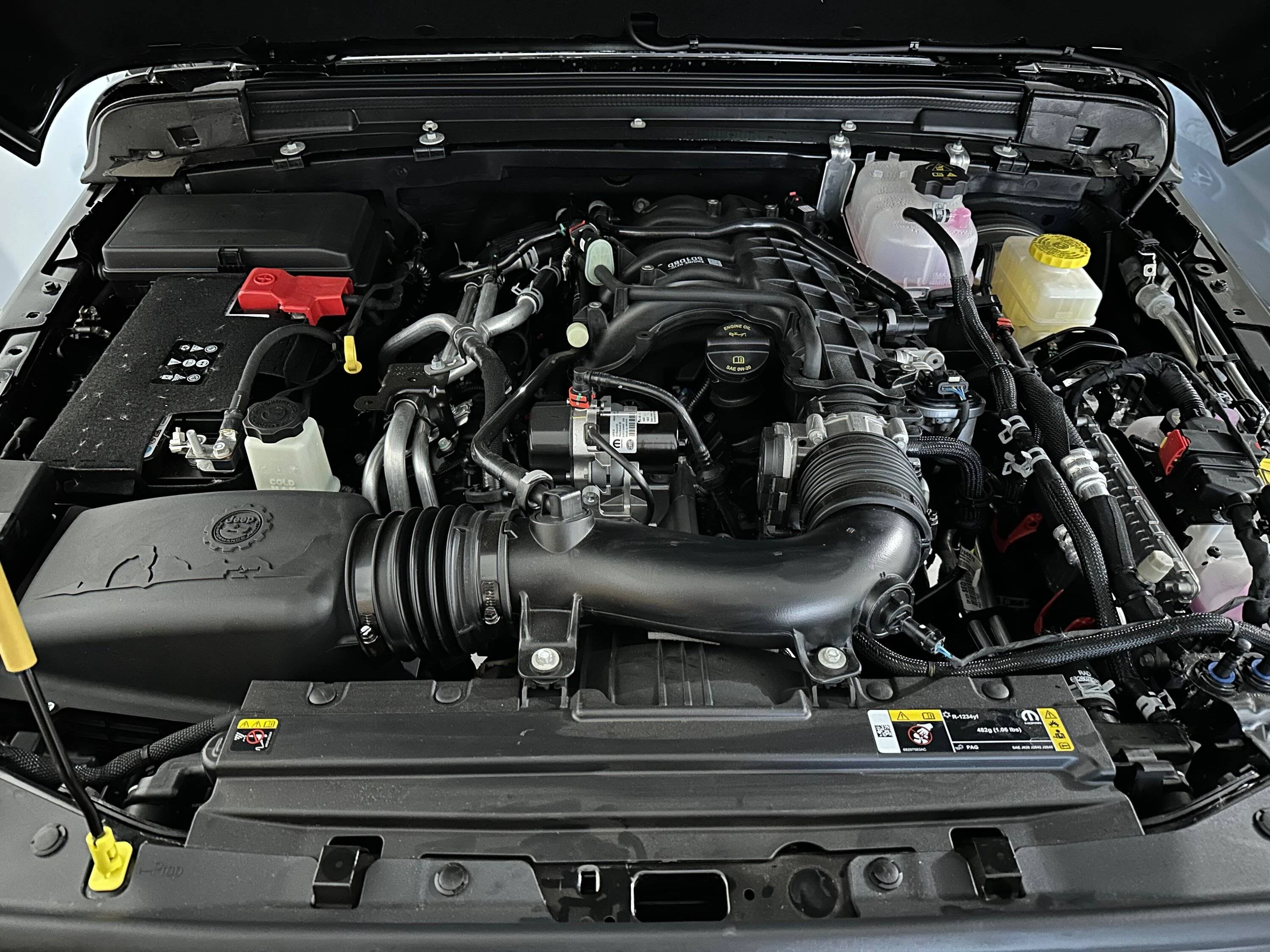

Appreciate the knowledge and input assistance here.. Won't lie, I've heard this so many different ways in regards to the "Primary" 12v Battery and the "Secondary / AUX" Mini 12v Battery that is supposedly under the Passenger Firewall area in the Engine compartment.
Last I'd heard was that only the 4xe and the 2.0L 4 cylinder had the 48v battery and that the 3.6L V6 eTorque had the Primary 12v and AUX 12v Battery.
I have a 2023 JL Rubicon with the 3.6L eTorque. So which Battery combination do we have with this Engine?
On a side note, I use a 12v Battery charger / tender as I don't drive it much, I'm guessing that this would only charge the main 12v Battery then and not the 48v Battery.
-Thanks..

All etorque setups are the same. 48v primary battery under the drivers side opposite the fuel tank. Belt start generator that charges at 48v. The 12v battery is charged by the 48v battery. Using a battery tender on the 12v is still a good practice as it's standard lead/acid configuration with discharge over time. The 48v battery is a lithium ion pack and will hold a charge for a very long time so there's no need to worry about it. The 4xe is an entirely different set up that has a massive battery under the rear seat, charges vis plug in and/or regenerative braking, and I believe operates around 400v.
