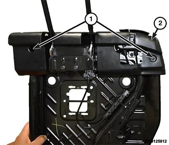

From the service manual-
Remove the seat back foam and seat back cover as an assembly, from the seat back frame.
Remove the screws (1) and the top cover (2).
Jeep Wrangler JL Seat Release Cables WTF 1711287445960-w1

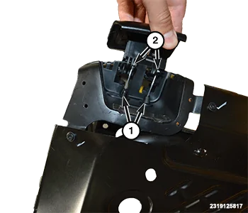

Unclip the release cable from the seat frame.
Open the release handle and release the necessary cable end (2).
Unclip the necessary cable (1) from the release handle housing.
Jeep Wrangler JL Seat Release Cables WTF 1711287698474-j3
Remove the screws (1) and the foam support (2).
Jeep Wrangler JL Seat Release Cables WTF 1711287874472-f7

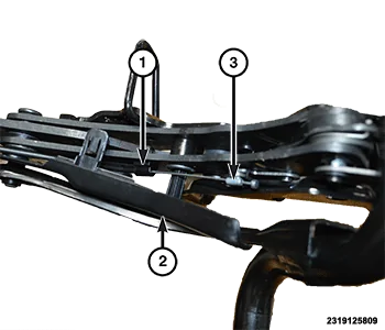

Remove the screws (1) and the mechanism cover (2).
Jeep Wrangler JL Seat Release Cables WTF 1711287930035-9s
Position the inner cover (2) aside, unclip the cable (1) from the mechanism and remove the cable end (3).
Jeep Wrangler JL Seat Release Cables WTF 1711287983346-01
