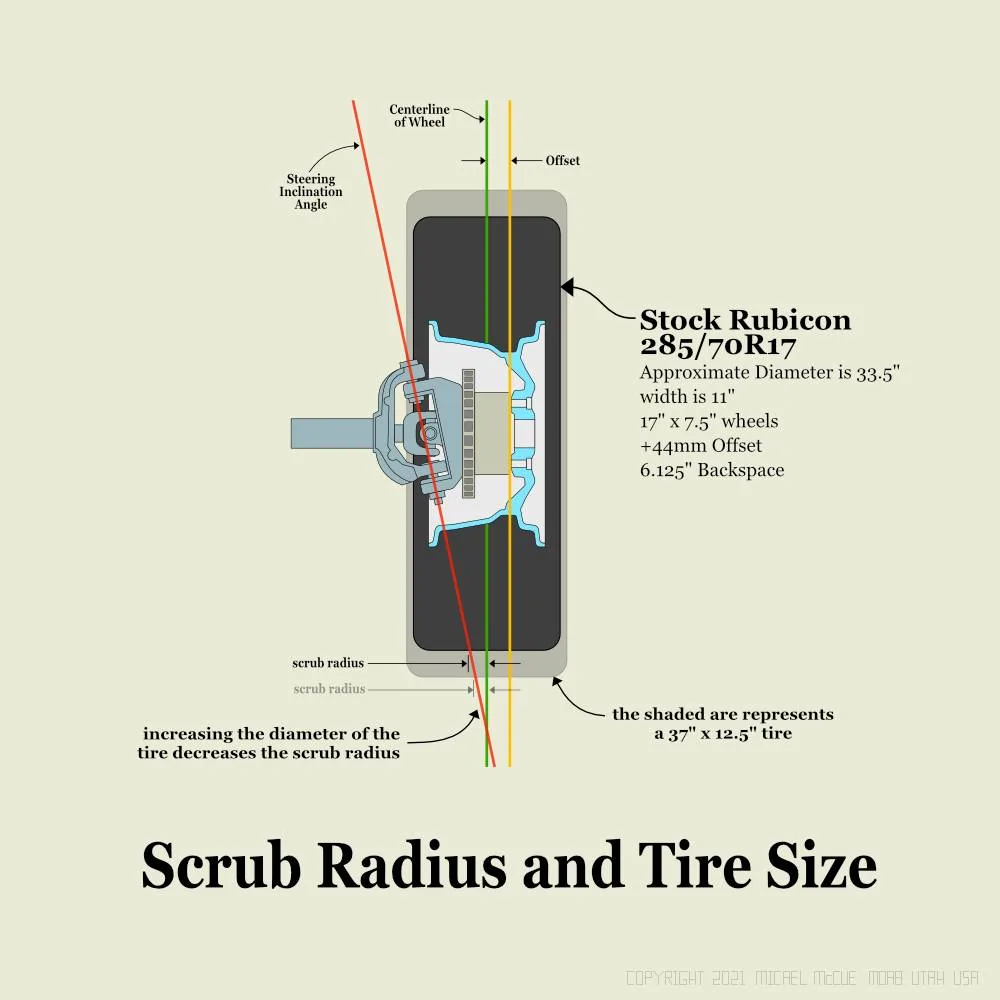

This illustration shows a stock 33" tire as black, while the shaded area represents a generic 37"x12.5" tire, which is positioned coincidental to the same wheel.
You can see that the Steering Inclination Angle line extends downward to and through a point where it intersects the center line of the wheel.
The distance between the points where the Steering Inclination Angle and Wheel Centerline cross the horizontal ground plane may be positive, zero, or negative.
If everything else remains the same, increasing the tire diameter decreases the value of the scrub radius dimension.
The distance between the points where the Steering Inclination Angle and Wheel Centerline cross the horizontal plane where the tire contacts the ground may be positive, zero, or negative.
Ah, that makes perfect sense, thank you!

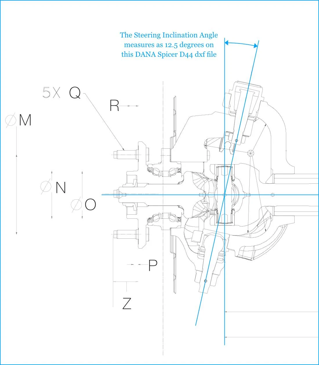

I am still trying to learn the specifics of the axles in the JL series Jeeps. In the meantime, I have been using this technical drawing as a reference.

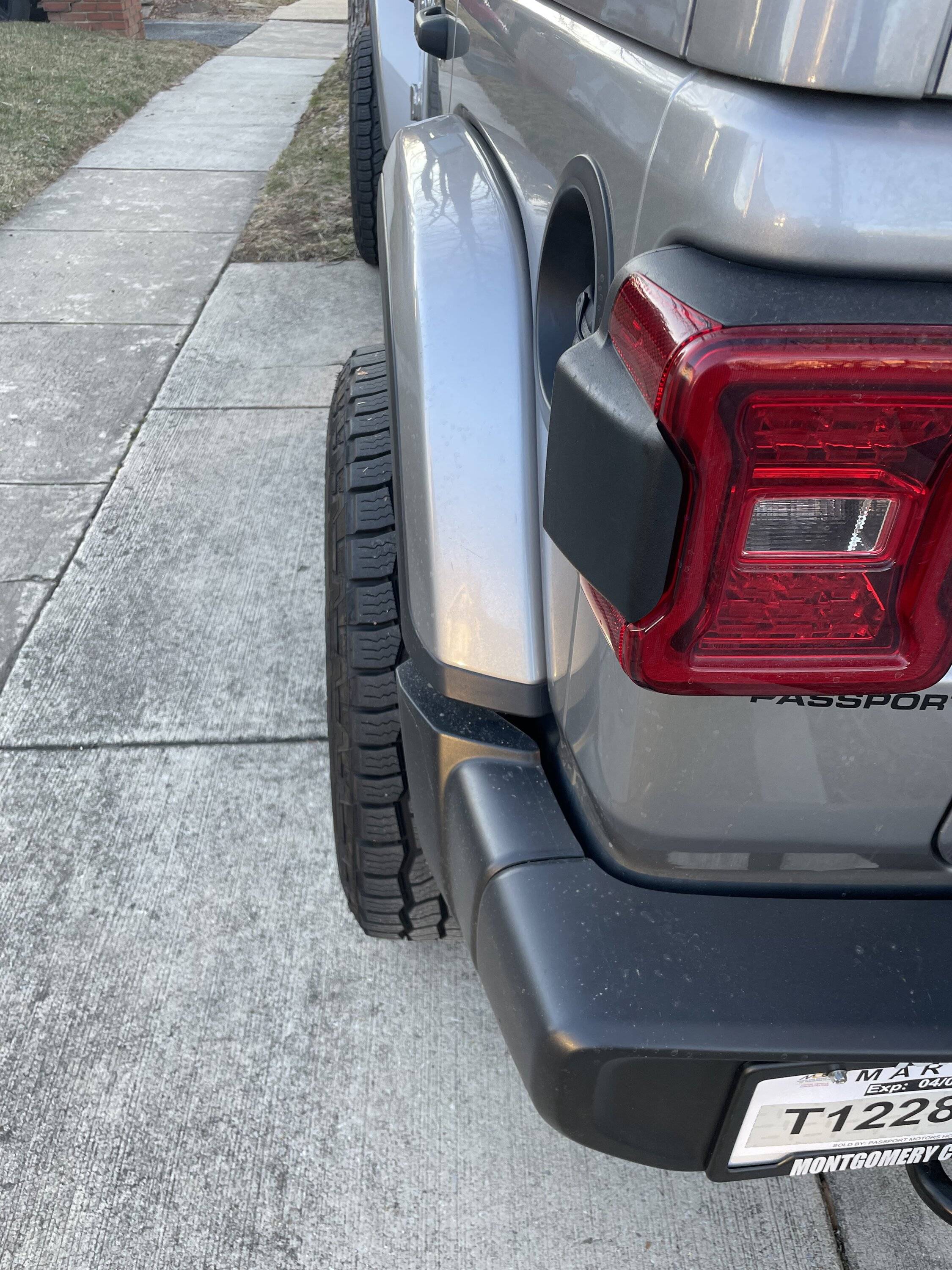

Need some help here! Found this thread when I was researching why my JLU is shimmying all over the place way worse since putting on my new wheels/tires. I have Method 701s in 17x9 et12 on Cooper discoverer 33in tires. Sahara, no lift. I love the way these look but ever since installing them the Jeep feels like it’s all over place. I’m being throw around over the smallest bumps.
Is this all because of the more aggressive width and offset creating an incorrect scrub radius? I’m eventually going either mopar or dynatrac 2in lift w/ 35’s- though not sure this will help my problem obviously. I’ll go stock width and/or offset if I can get the ride back to normal.
Pic attached for reference. Any help/ advice is greatly appreciated!

CORRECT, to clarify it’s et -12 & a 9in wide wheel. You can see how much they poke in the pic.
