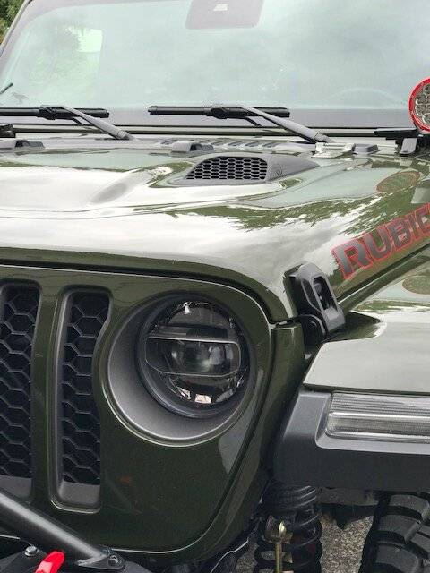

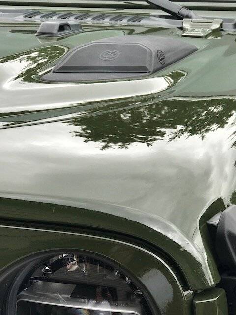

I have them. Trying to put as much air flow to the motor without changing hoods. Trying to avoid D rating when traveling. They have rubber covers that pop on when it’s raining. I also throw them on when following close on dusty dirt roads. Trying to keep engine compartment clean. Yes, the Eco Diesel seems to have heat issues.
My biggest concern would be the copious amounts of rain we deal with here in southern Louisiana. Don't really want to have to jump out in one of our sudden rain storms to put the covers on.

Heat saturated motor from freeway speed, throttling up for climbing or taking off have been all been related in our d-rates. Putting on new hood, painting, vents is a high cost with no proven fix. We have pre-filter fabric that we’re wanting to adapt to the S&B’s for the rain. My last d-rate the covers were on because it was raining. My next mod will be removing the foam blocks under the hood and making the side cowls into vents to for rear air escape. It’s not done yet because I want it to look good. Removing any heat in engine compartment is a good move to me.​
