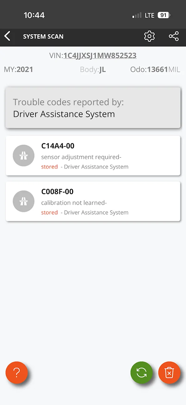

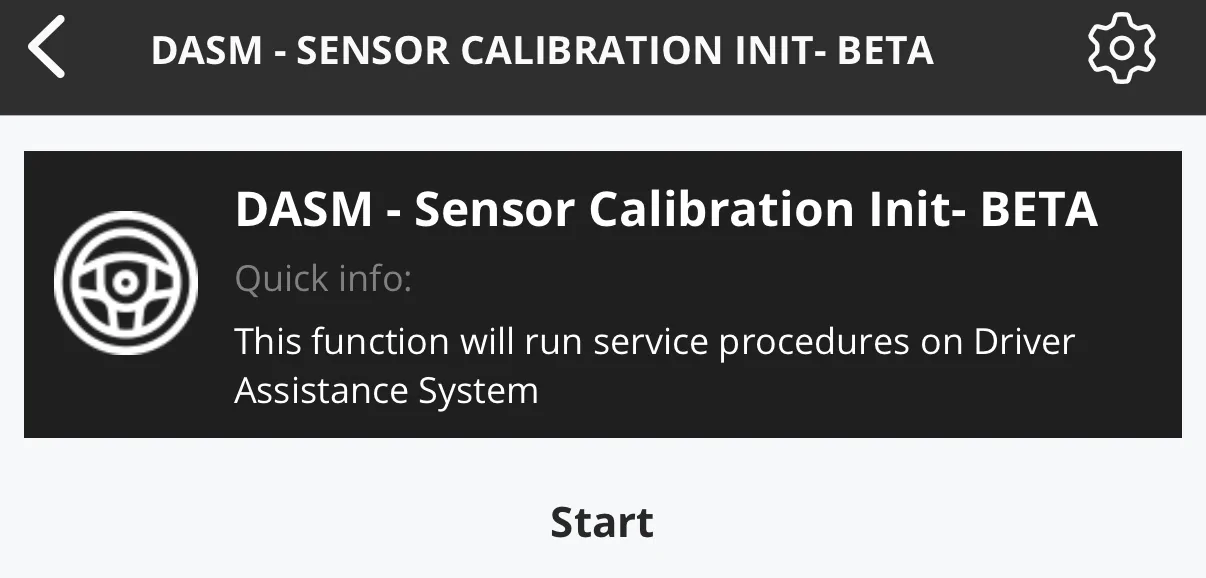

Jeep JL/JT.. DASM - Sensor Calibration Init - Beta... Has anyone ever completed this adaptation successfully in JSCAN? I've read that if you have any lift or bigger tires it basically doesn't work no matter how much vertical alignment of the sensor you attempt. I've learned (too late) that if you have a lift you should never run this feature, but unfortunately I already ran it and left my vehicle in a state that Cruise no longer works. No MIL, JSCAN advanced system scan reports that calibration is not learned and sensor adjustment is required.. I've vertically aligned the sensor multiple times to no avail. When you attemp to use adaptive cruise it reports "Adaptive Cruise Control (ACC) Unavailable Steep Grade" and when you attempt regular cruise it says "Cruise Unavailable Below Minimum Speed"... These things happen on flat ground at 75 so neither of those error conditions is actually applicable. This is a 2021 JLU with portals giving it a 4" lift and 40" tires. I have the gear ratio and tire size settings correct and my speedo is accurate. My steering wheel is also centered. Vehicle reports no errors other than this DASM alignment stuff per image below.

Considering temporarily returning vehicle to stock to run the feature but want a certain level of confidence that will work if I do so. So love to hear if this feature works in JSCAN for stock vehicles. Even better if folks have actually achieved success messing around with that alignment screw and passing that calibration with a lift and tires I'd love to hear about it. I posted this on the JSCAN facebook group but the JSCAN admin deleted my post.
