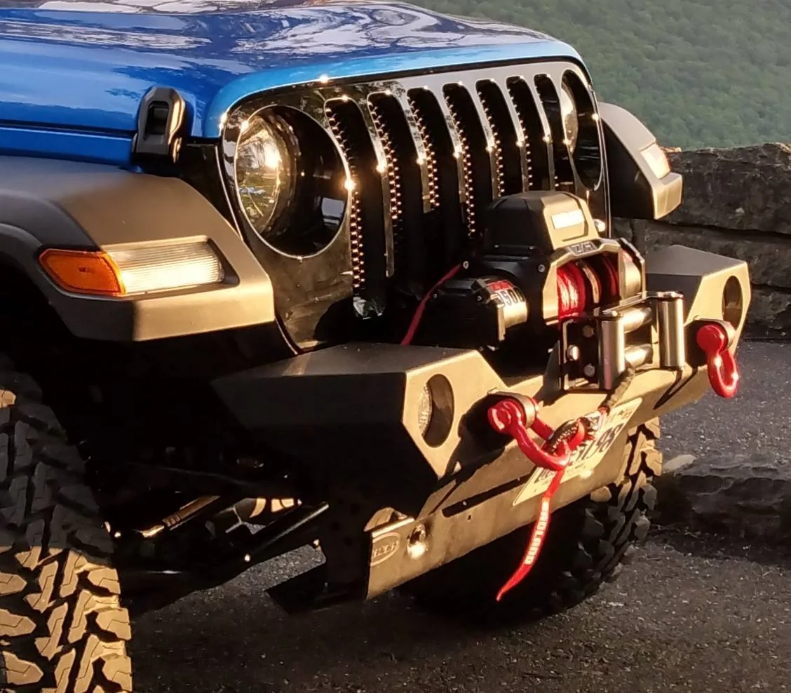

As others have said, chip off the flakes, hit it with a rattle can of paint. Re-powder coated, Probably the cost of a new bumper or close to it.
My method: I removed it. Used a grinder and took it down to bare metal. I used a can of herculiner bed liner. It's holding up better than the powder coating, over 2 years now.

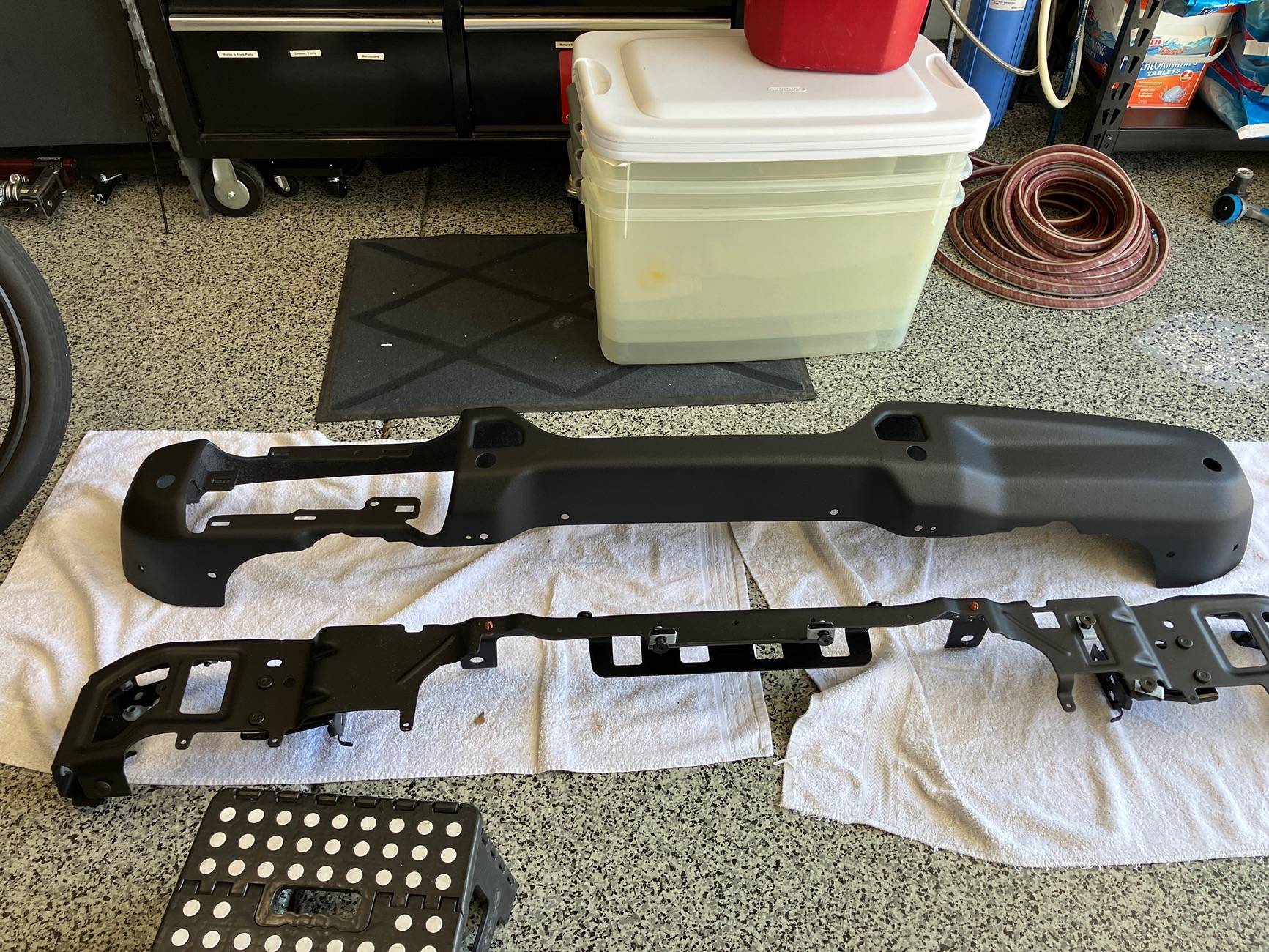

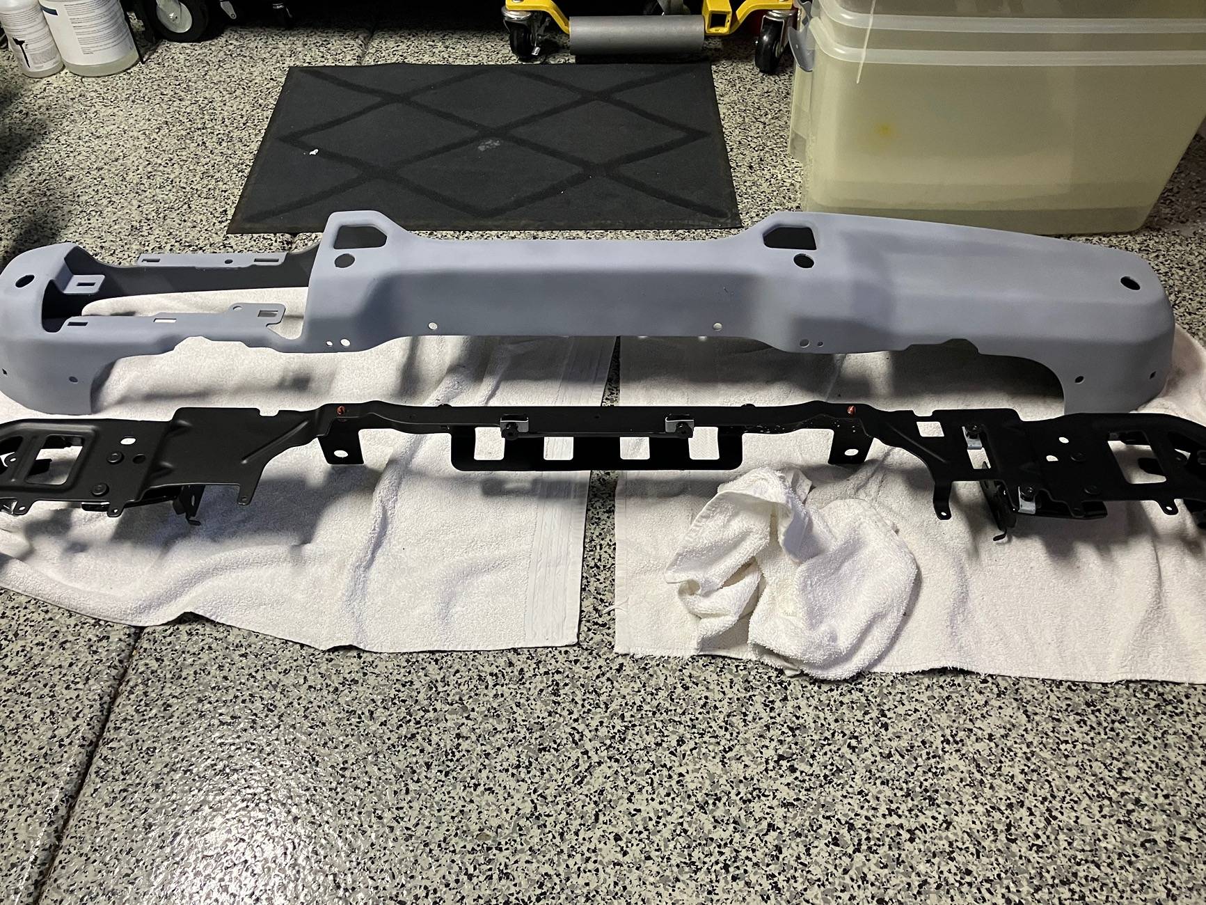

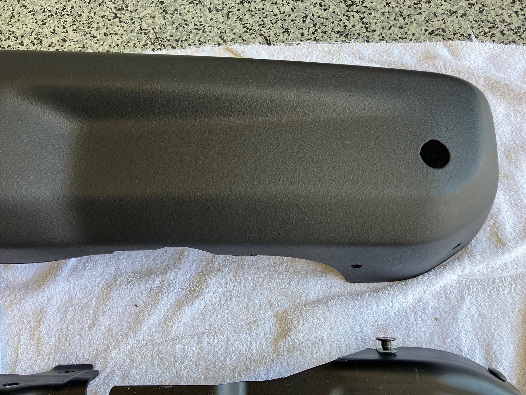

I’m with @Flip on this one. I sanded , primed and bed lined. Looks great
Many moons ago, I purchased a barricade rear bumper for my TJ. The powder coating started to flake off inside of 6 months. I was furious. I scraped off the flakes, touch up painted it for years. I didn't know about the bedliner back then. No more flaking, scraping, and painting, Its solid!

I found out about through the forum. 9maybe your post😊) It was surprisingly easy to get a great finish. Your front bumper looks really great. I bought a beat up steel bumper off of marketplace, and for under 150 bucks refurbished it. I did replace the plastic pieces, and some bolts were missing
My current bumper was really inexpensive when I bought 2 years ago - $225. Now they're over $400. I did a bull bar delete. At first I started to finish it with spray paint and of course I could see all my grinder marks, it looked like 💩! A can of Bedliner, problem solved and it has held up fantastic. On the trails and power washer. 👍
