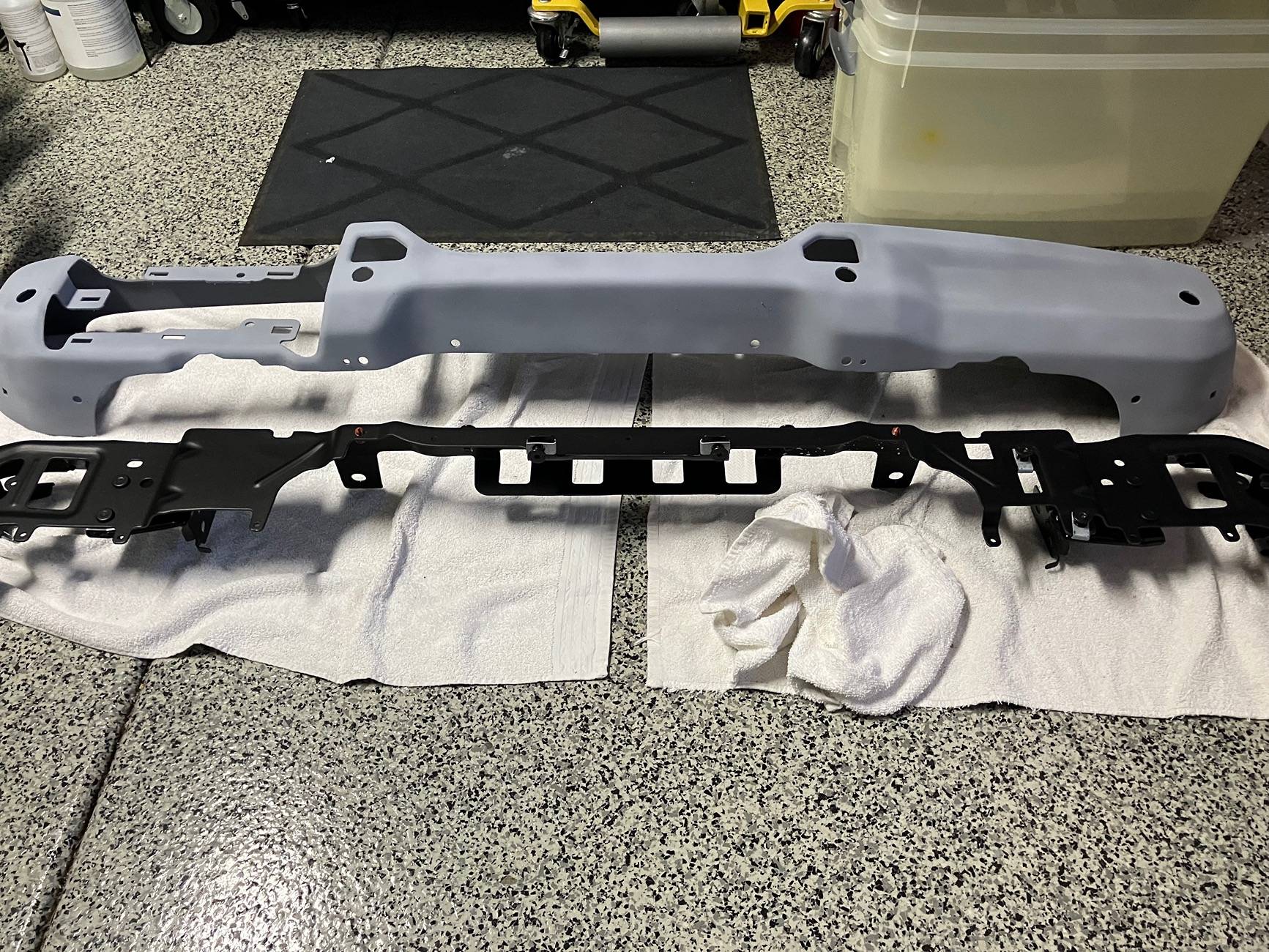

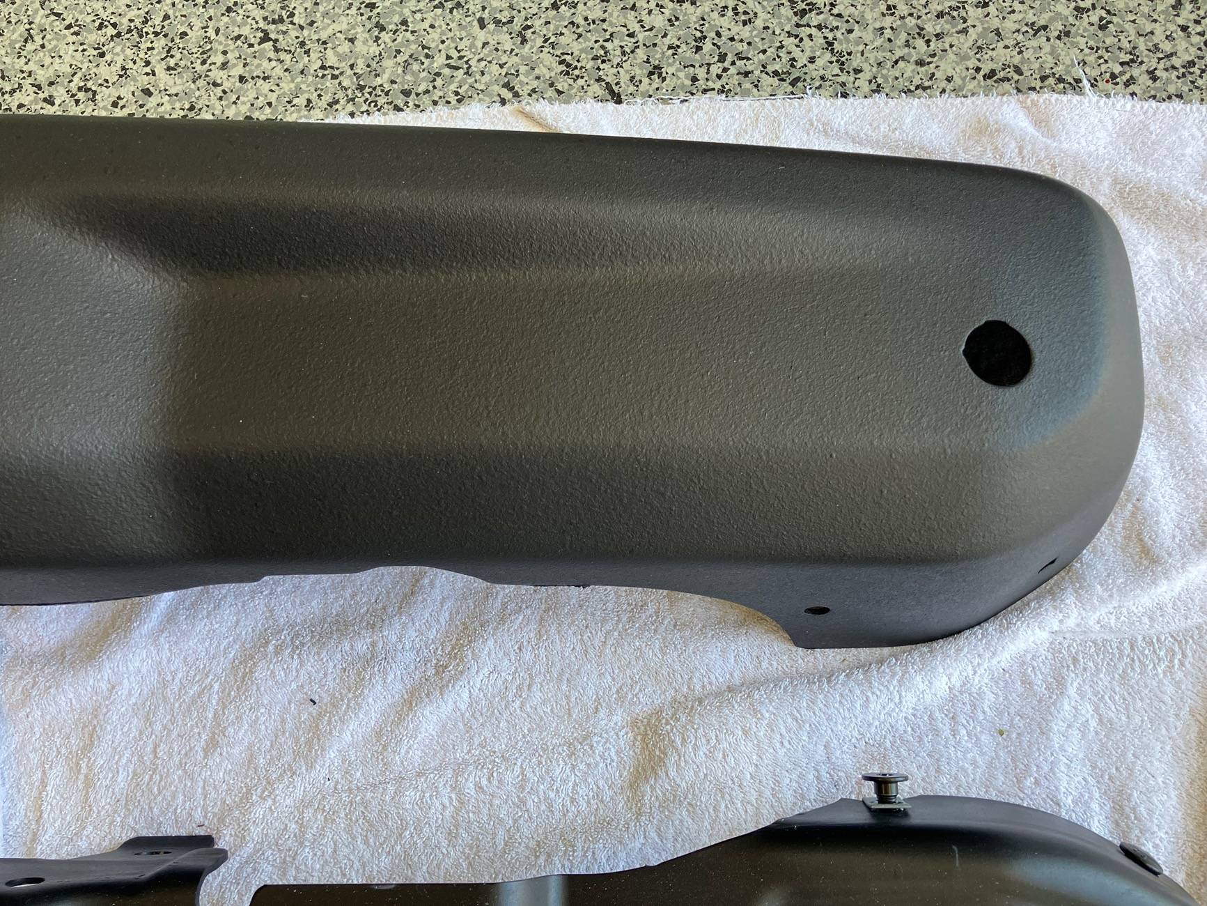

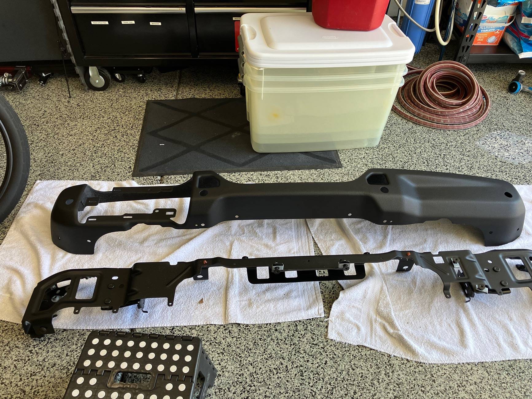

Well, we decided to tackle this today. The wife wanted to do the work since its her Jeep (who am I to complain?) but naturally I didn't get hardly any pictures. The bumper was in worse shape than I thought..but after a bit of sanding and a few coats of the Rustoleum bedliner spray, it came out looking pretty respectable.

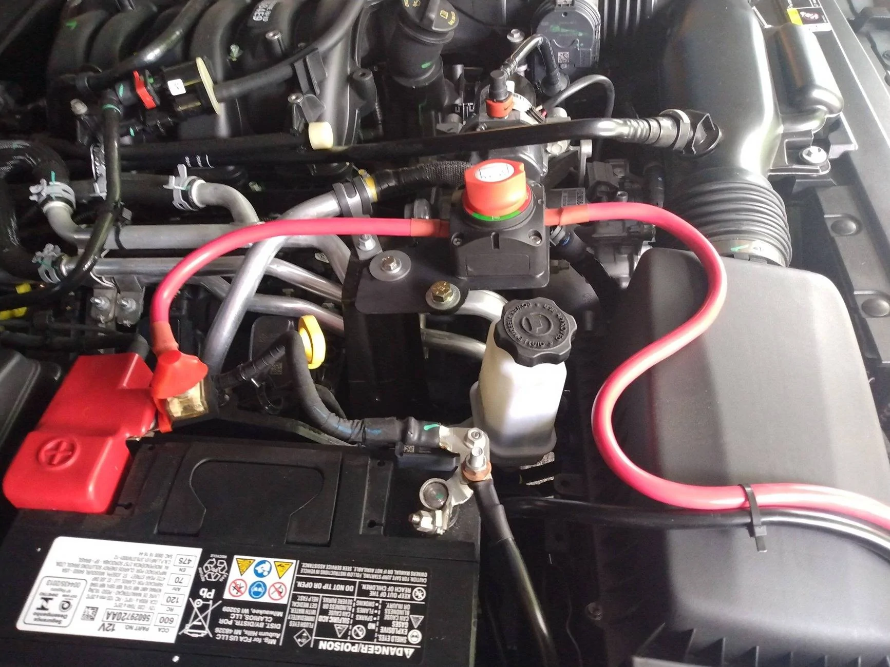

The other issue I had was mounting the power disconnect. I thought I found a decent place, once again thanks to some forum digging, but then realized the supplied cable was too short. Here's where/how I settled on it so far.

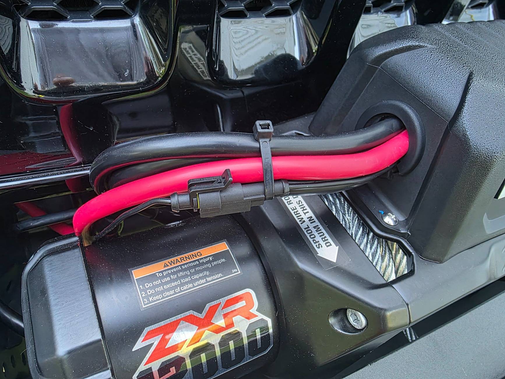

..and with the grommet installed. I ordered the wrong size, but amidst fighting it..I think i probably should've cut the hole a bit bigger.
Nice job, very innovative.

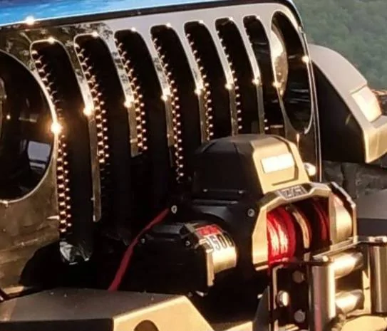

I was able to tuck the wiring at the back of the winch & grill. It's tight, to remove the grill I would have to remove the winch. I had my switch mounted in 2 different locations. I didn't have an issues. Maybe HF shortened the wire, that wouldn't surprise me.
