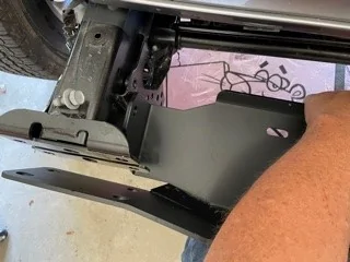

Here are the pictures.
Jeep Wrangler JL Rugged Ridge Arcus Bumper Not Fitting Bumper1
Jeep Wrangler JL Rugged Ridge Arcus Bumper Not Fitting Bumper2
I am off basically the thickness of the steel used in the plate so grinding is not really an option. When I measure the plate from outside to outside I am 26-29/32" but between the horns is measuring 26-3/4".

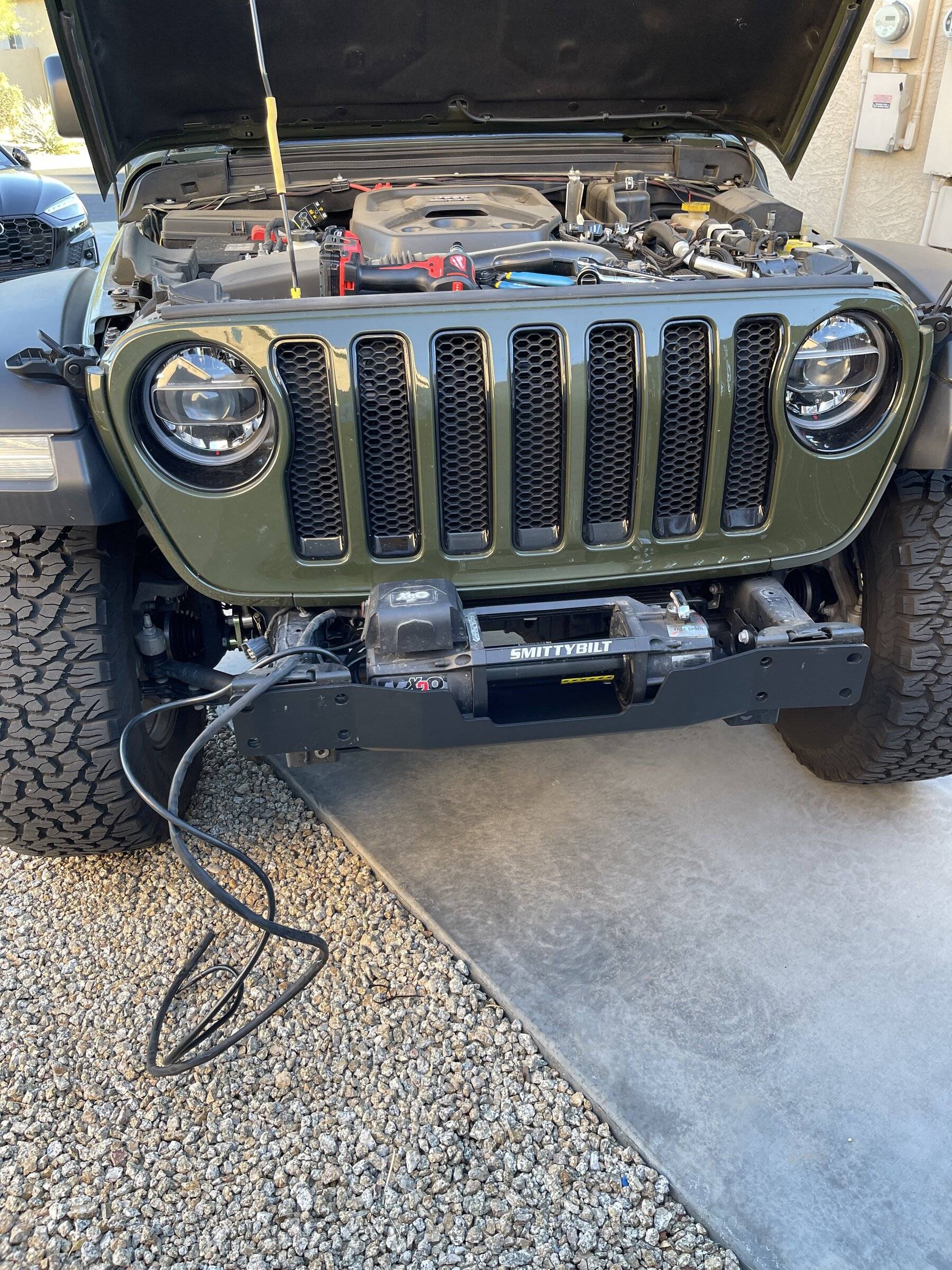

Sargeoverland
Jake
Jul 5, 2021
226
230
Arizona
21 jlu
Mine was a little tight. Took some wiggling and got it in.
