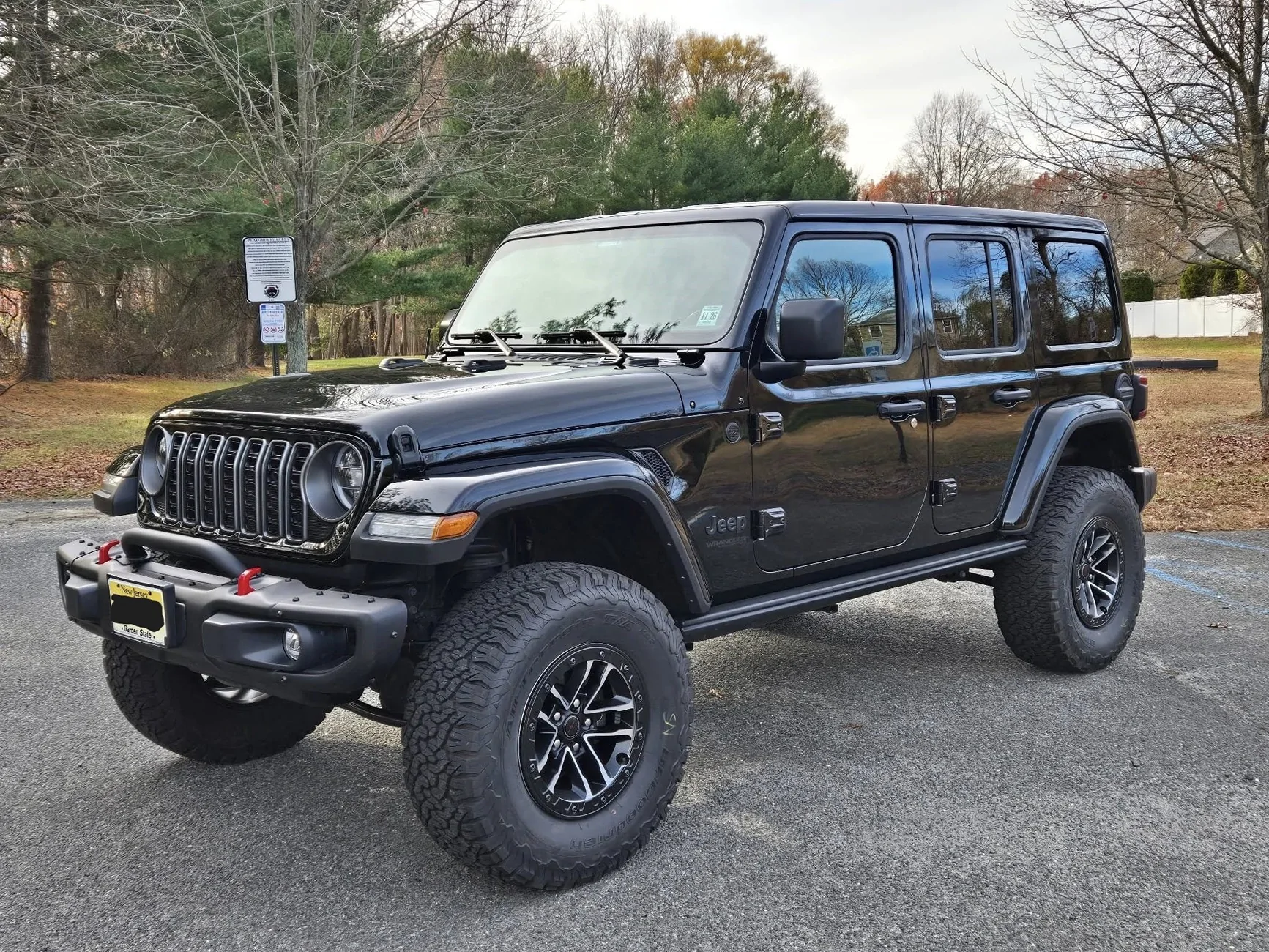

I have done this exact swap on my 2dr sport and my sons sahara. The rubi coils and shocks will give you around 1.5" (each part number on the coil is good for 3/16". so depending on what the rubi was equipped with you may get a little more or less). With the sahara / sport flares that will allow you 33's. if you add rubi flares you'll get 35's.
My advise (this is what i did):
-Add the Rubi Coils & Shocks (+1.5")
-Add a 2.5" RC spacer kit (+2.5")
-Add mopar LCA
-Keep Sahara Flares
-Run 315's (35s)
Very easy, economical 4" lift if you arent doing serious off-roading.
There is very little change in ride quality.
See pics below.... both of these have the set up listed above.

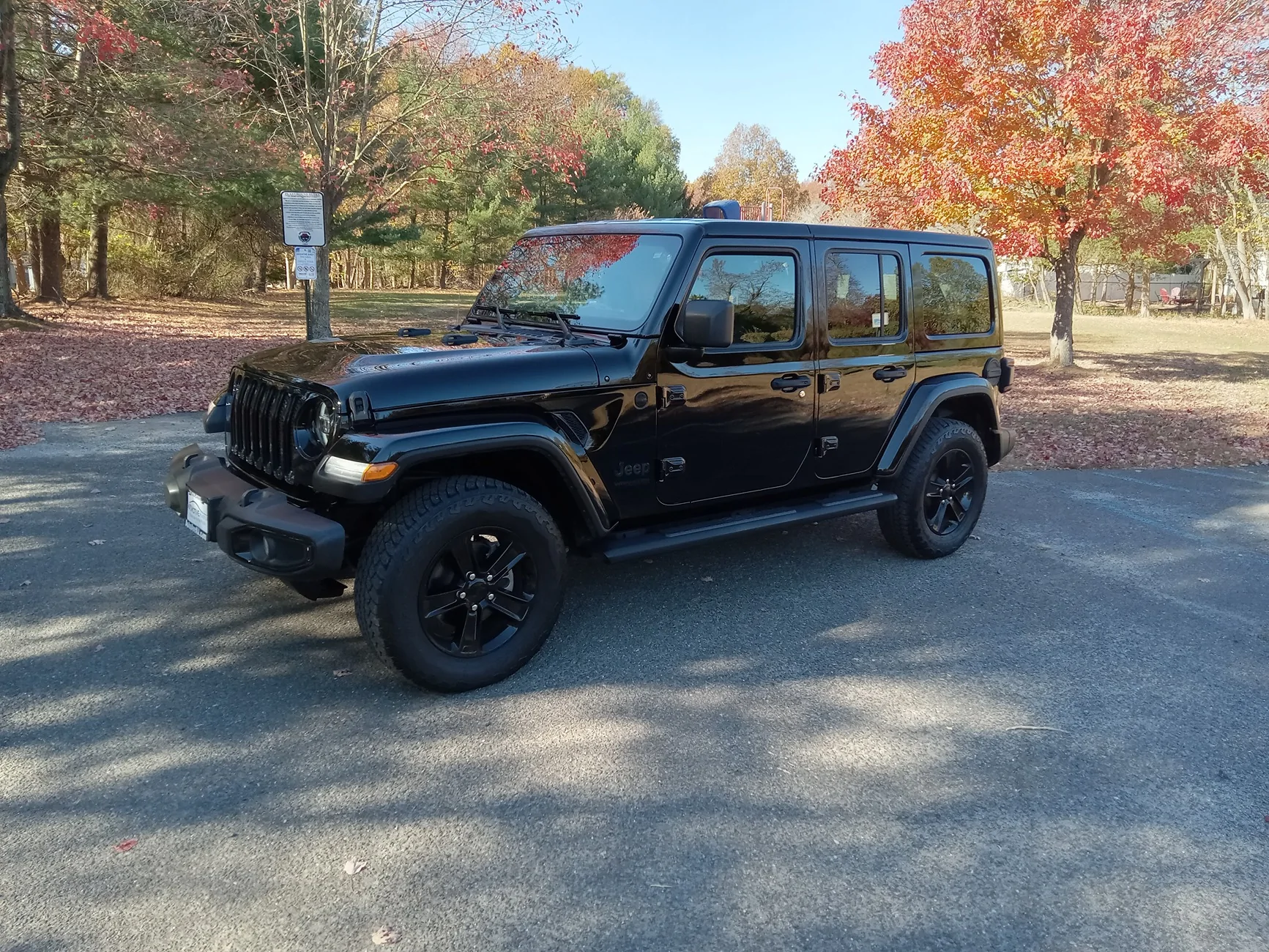

Those are the exact numbers on my son's black Sahara. Add the rc 2.5 spacer kit for around $200 and you'll have 4" and easily fit the 35s. Here's a before / after

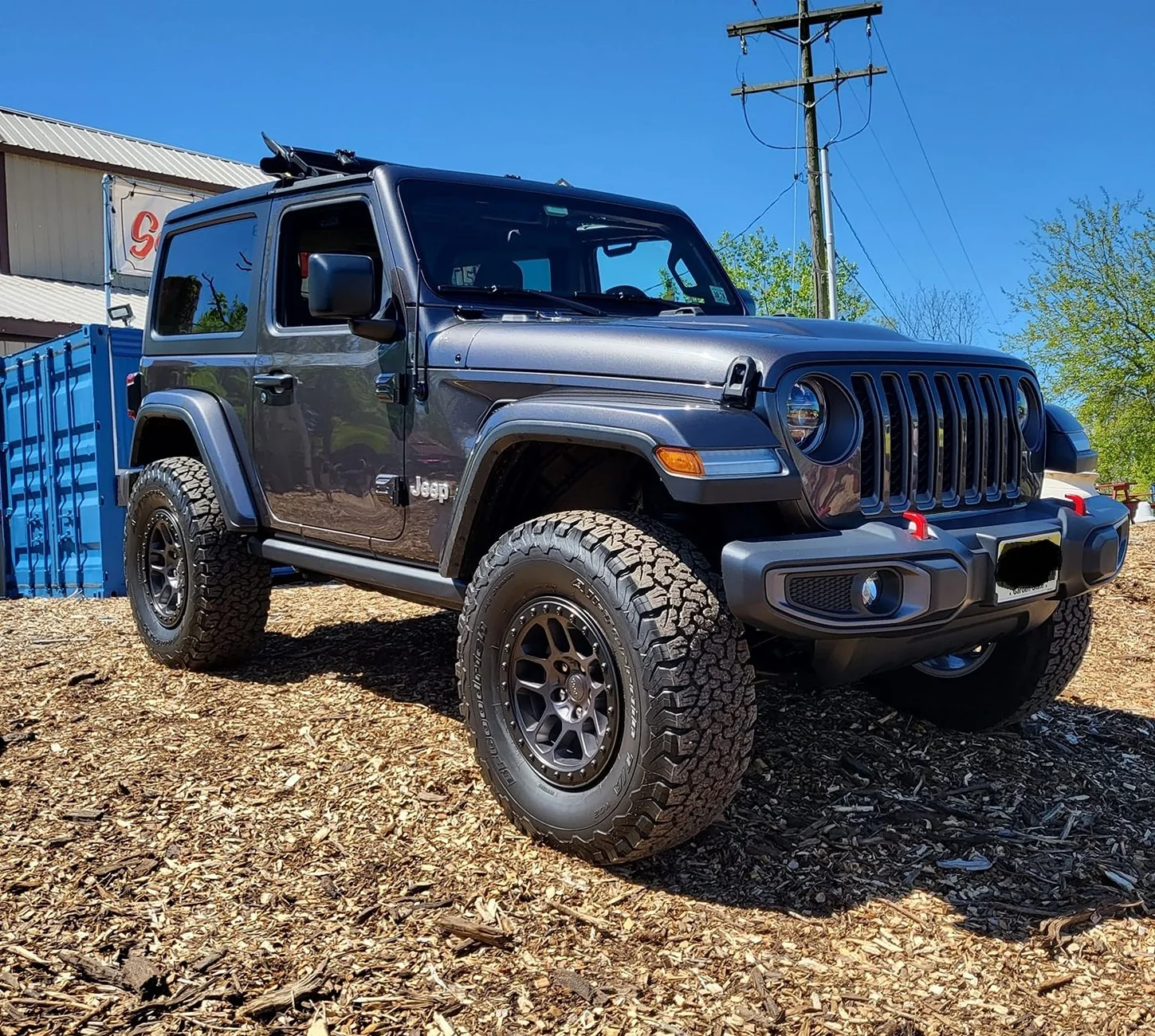

Seems everyone’s experience with the rubicon springs and shocks are different in this thread. This is my 25 sport after the springs and shocks with 35” MT BB ATs. I netted about 2.25” lift front and rear. That’s all I installed for suspension and have wheeled it many places and have never rubbed the tires on the inner fenders even when the tires were stuffed.

This is with my sway bar disconnected with rubicon fenders. Loaded with camping gear for 7 people. I’m confident I could get 37s in there with no rubbing.
