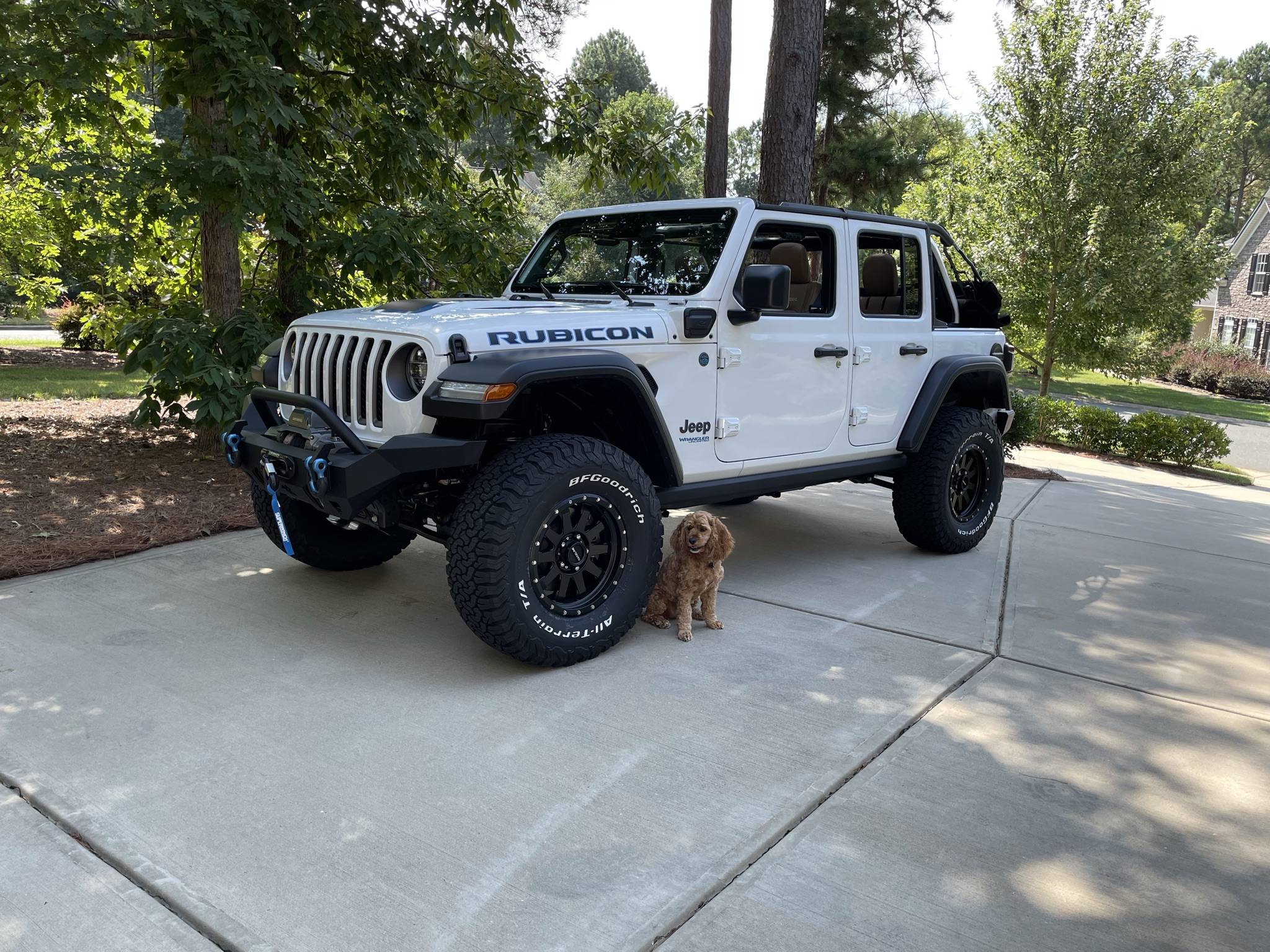

My original setup was the TF 1.5, 2” bumps, 2” extensions, and extended sways on 35s. Probably an inch higher than you’d be due to the 4xe springs, pic attached.

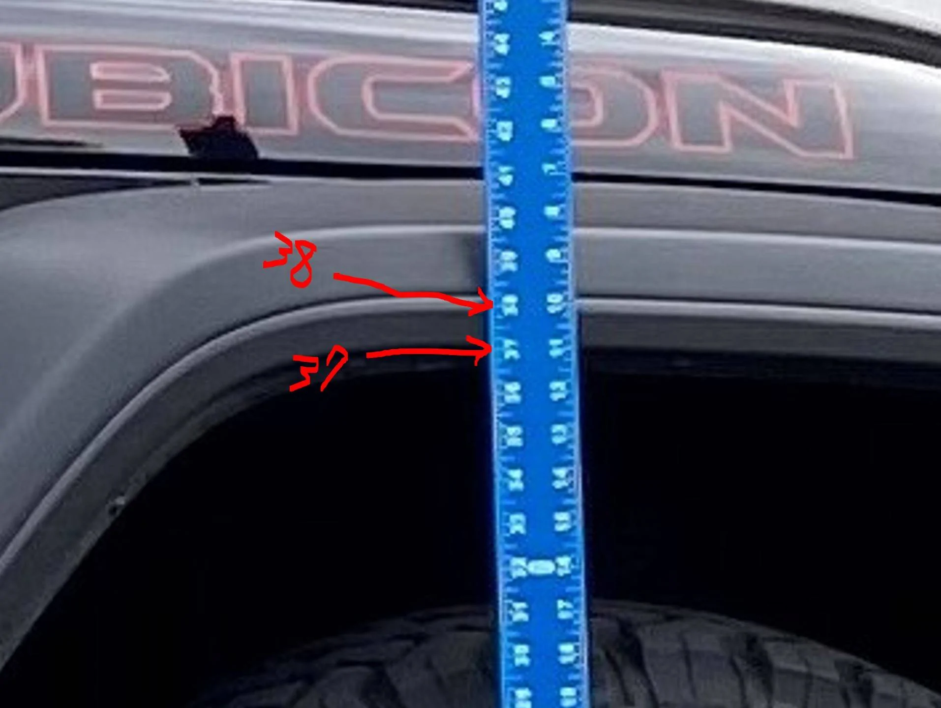

The straight edge is leaning a bit, probably about 05." loss.
