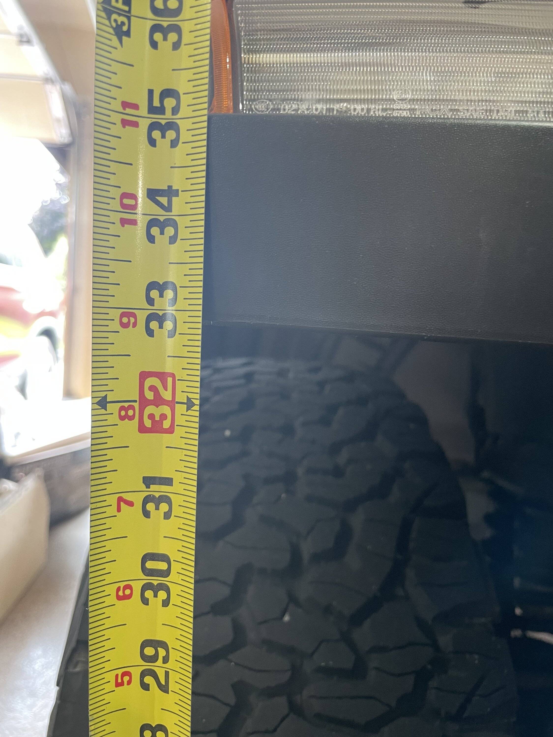

I have a 2021 4 door Rubicon with steel bumpers and a winch with a synthetic line and the stock ko2 tires. I would like to verify my height to see if there's something weird going on. Maybe it was me being next to a bunch of lifted jeeps but something just seems off to me. One guy even asked if my bumper was messed up because it looked like it was on an angle.
In the front, measuring from the ground up across the middle of the hub to the bottom of the fender is about 37 5/8". In the rear, it's 38 1/2".
I feel like I'm in the ballpark considering the steel bumper and winch. I also feel like I could probably use a spacer to even it out if I really felt motivated to do so. With passengers though, it looks better.

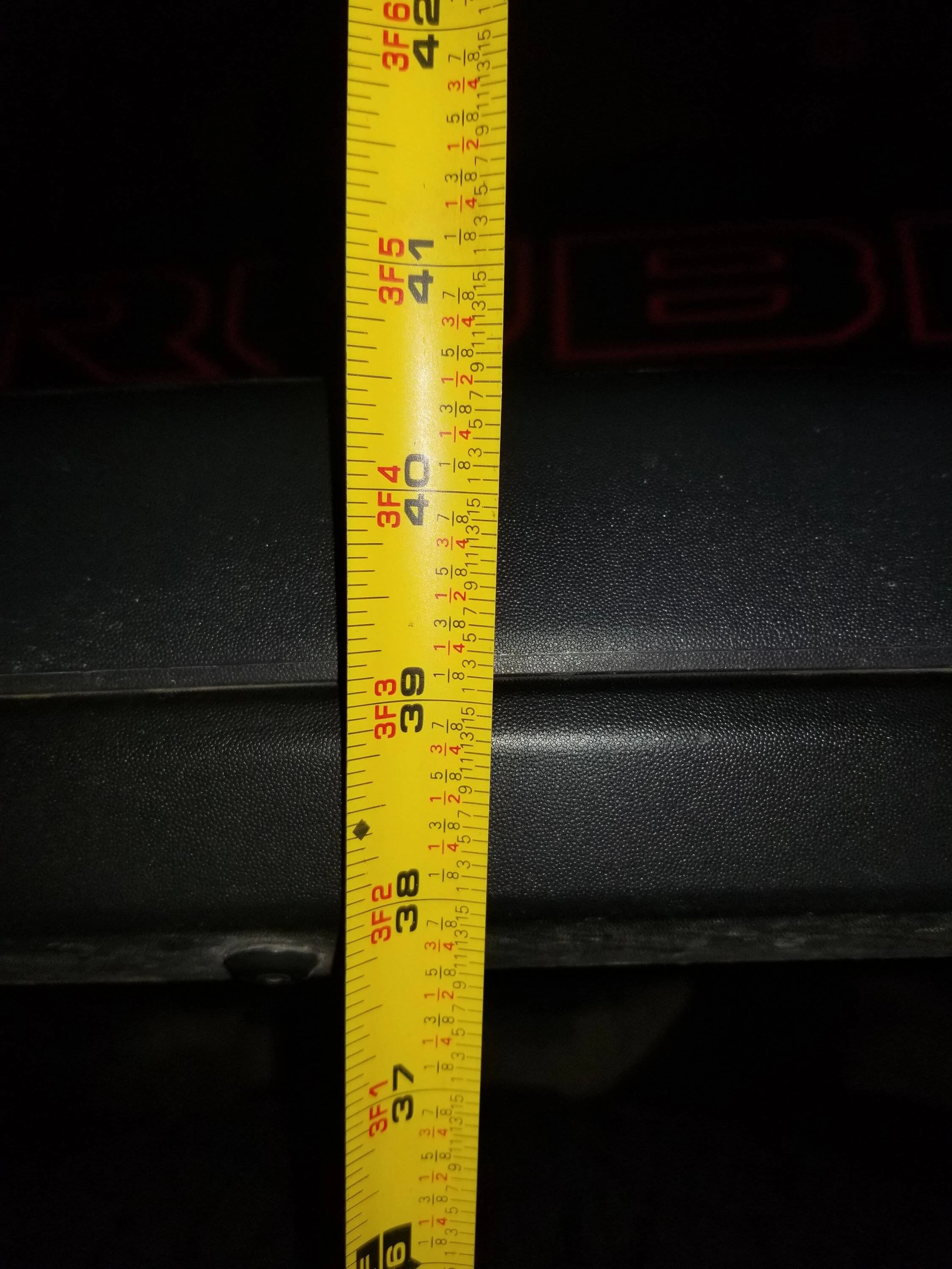

I can go out and recheck mine, getting ready to install a MC bumper and winch today on stock 21JLUR with original 33” tires. Until I take another pic, this is one I did earlier on the passenger front fender in the front under the light.
Thank You! Do you have the OEM steel bumpers before installing the MC bumper?
Comparing your measurement location to mine, I'm seeing about 32". From what I hear, the steel bumpers and a winch drop the front down about an inch. The difference between yours and mine is exactly an inch.
On the plus side, my stock caster is almost 6 degrees. lol... I looked at how to install a spring spacer and it looks as labor intensive as getting a lift. Just a lot cheaper...

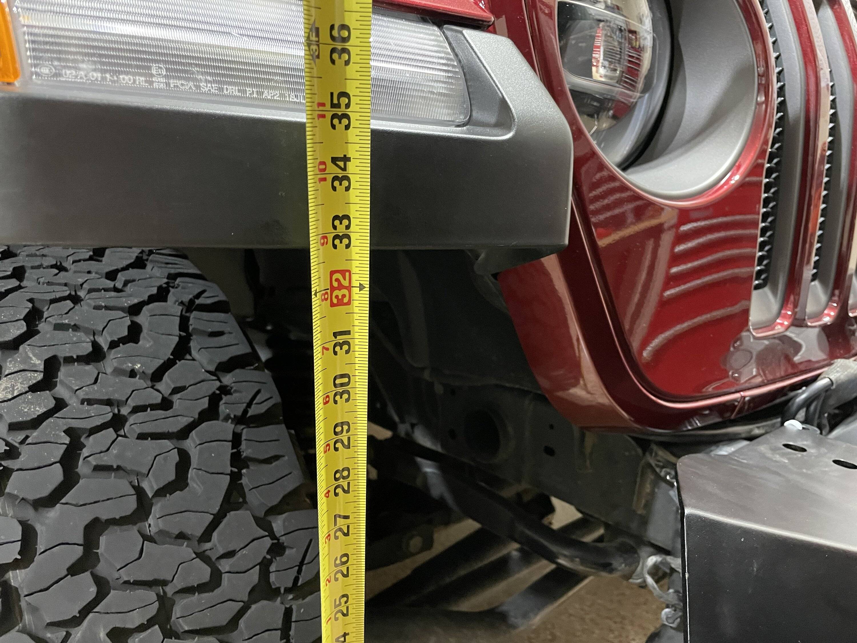

I had the plastic bumpers. After the install to steel bumper and winch at the same measurement location it dropped 1/4 of an inch. My plastic bumper weighed approx. 35lbs. Metalcloak steel bumper was 61lbs and superwinch was another 61lbs. So roughly an 87lbs increase of weight.
Not sure how much the factory steel bumper weighs but it seems like yours at an inch lower is a bit excessive.
