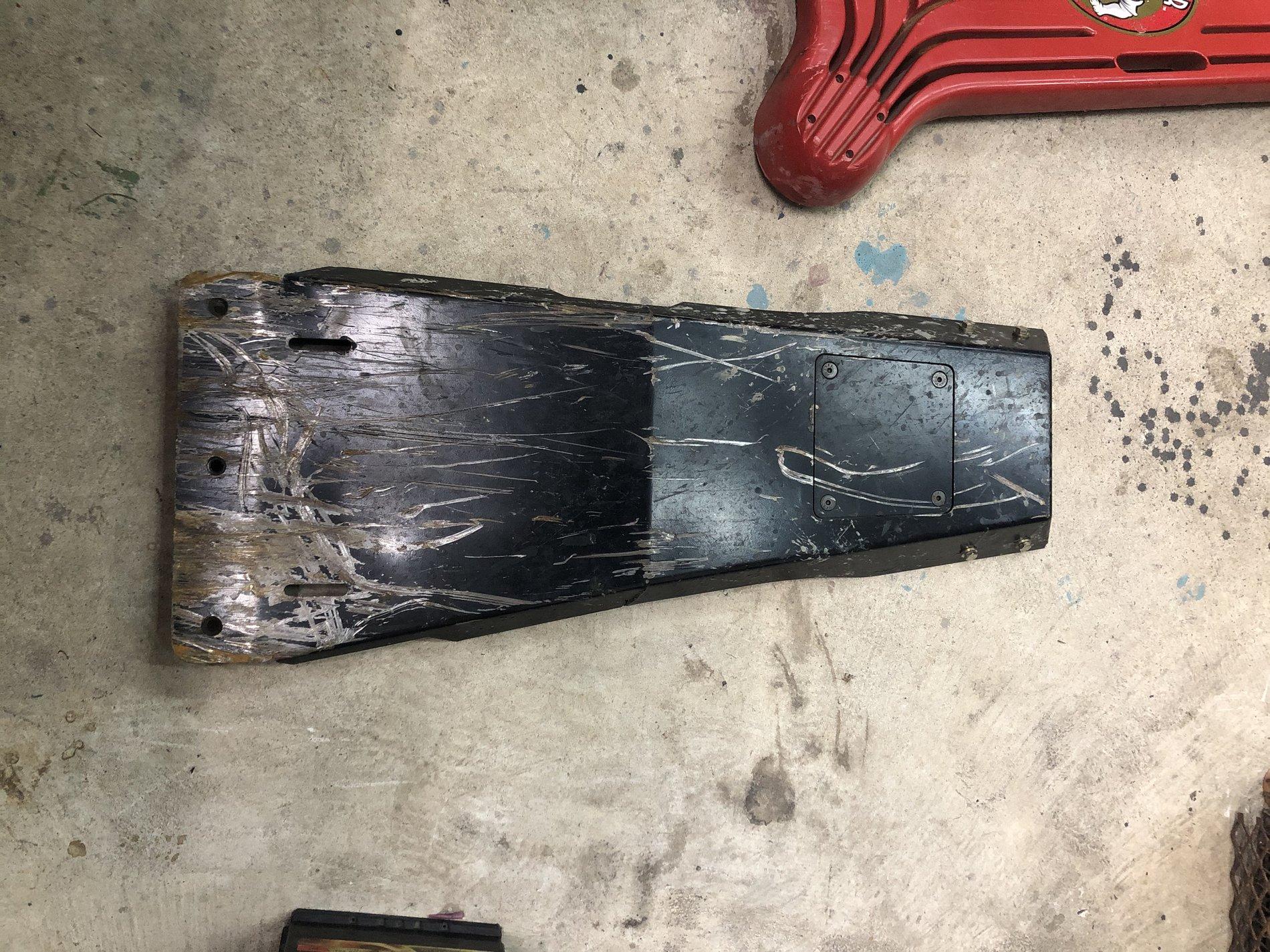

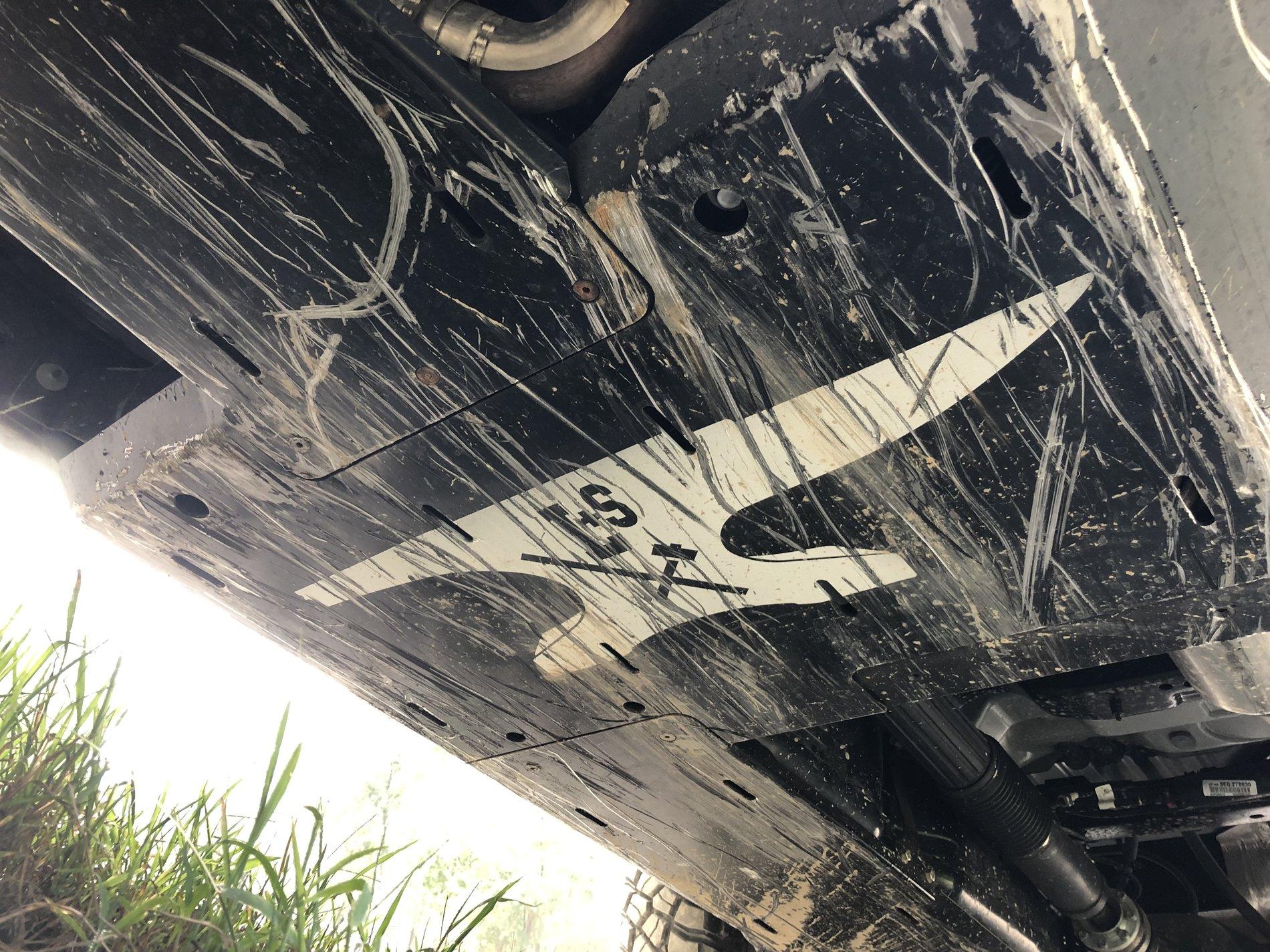

Transfer case cross member and skid - don’t hit this much, but I do hit it.
Exhaust pipe forward of the transfer case. I have hit this once.
Fuel tank - lots of scrapes
