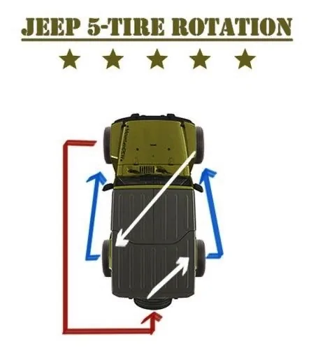

I may not be the norm, but I rotate my 37's at 3000 miles, this is a full 5 tire rotation. My back would appreciate longer intervals but my bank account appreciates the additional miles.

I do my 5 tire rotation and oil changes every 5k.
