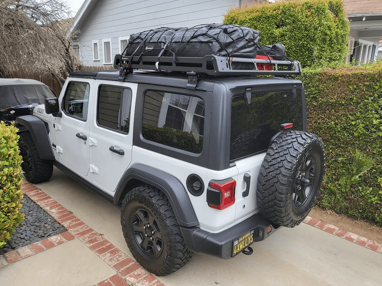

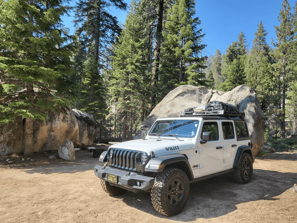

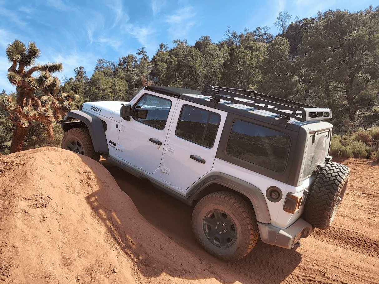

I use this one from Quadratec... works great for my camping needs! All aluminum and no noticeable wind noise. I have a Sunrider top and the length is perfect to accommodate this or removal of the freedom panels. Been on for 2yrs with no issues.

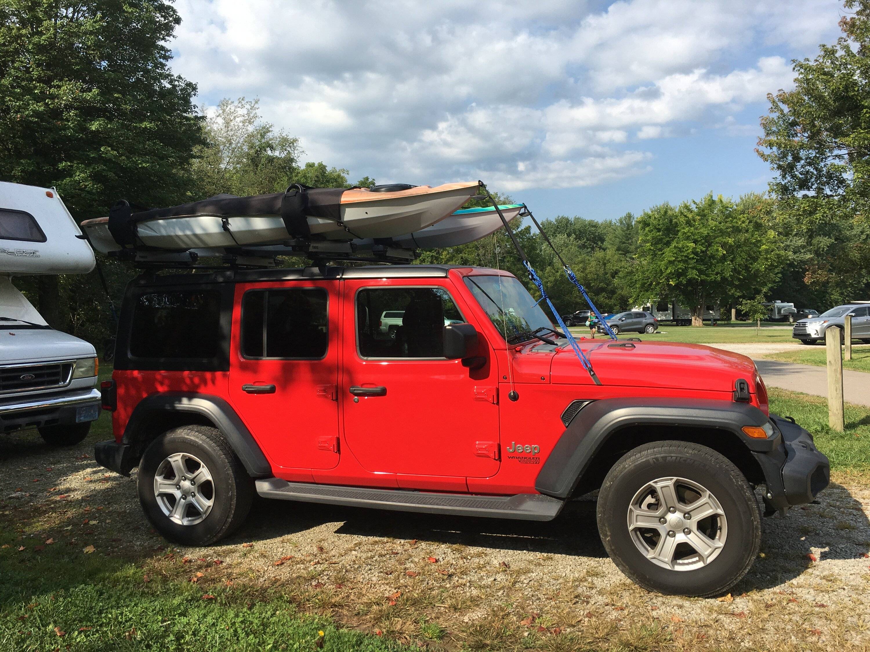

Your system will sit on the drip rail which has a weight limit of about 150 lbs. basically worthless. Add the rhino rack and now you can carry quite a bit. Can’t remember the while moving weight limit but static and stopped at a base camp site the rack will support 900 lbs. The system will support 3-4 adults in a tent.
The backbone is not that hard to install, read through the instructions a few times and watch a video for it and just take your time.
The backbone system is designed for use with a hard top, not sure what you will need with a soft top.
We added it to our Jeep so we can use the Thule Hullivator system for 2 kayaks. With 2 Hullivators and 2 10-foot kayaks we are pushing 180-200 lbs so we opted for the back bone system
