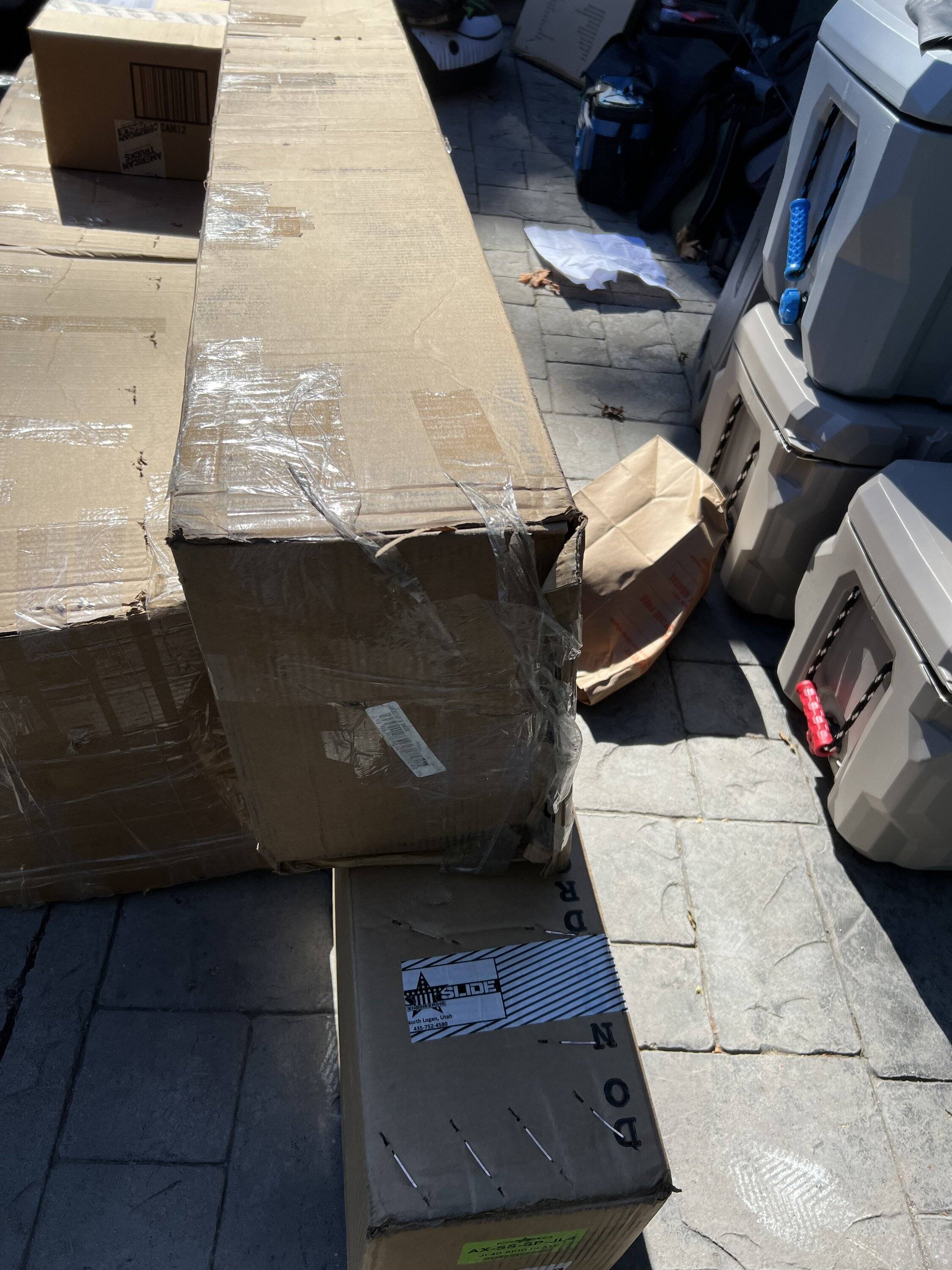

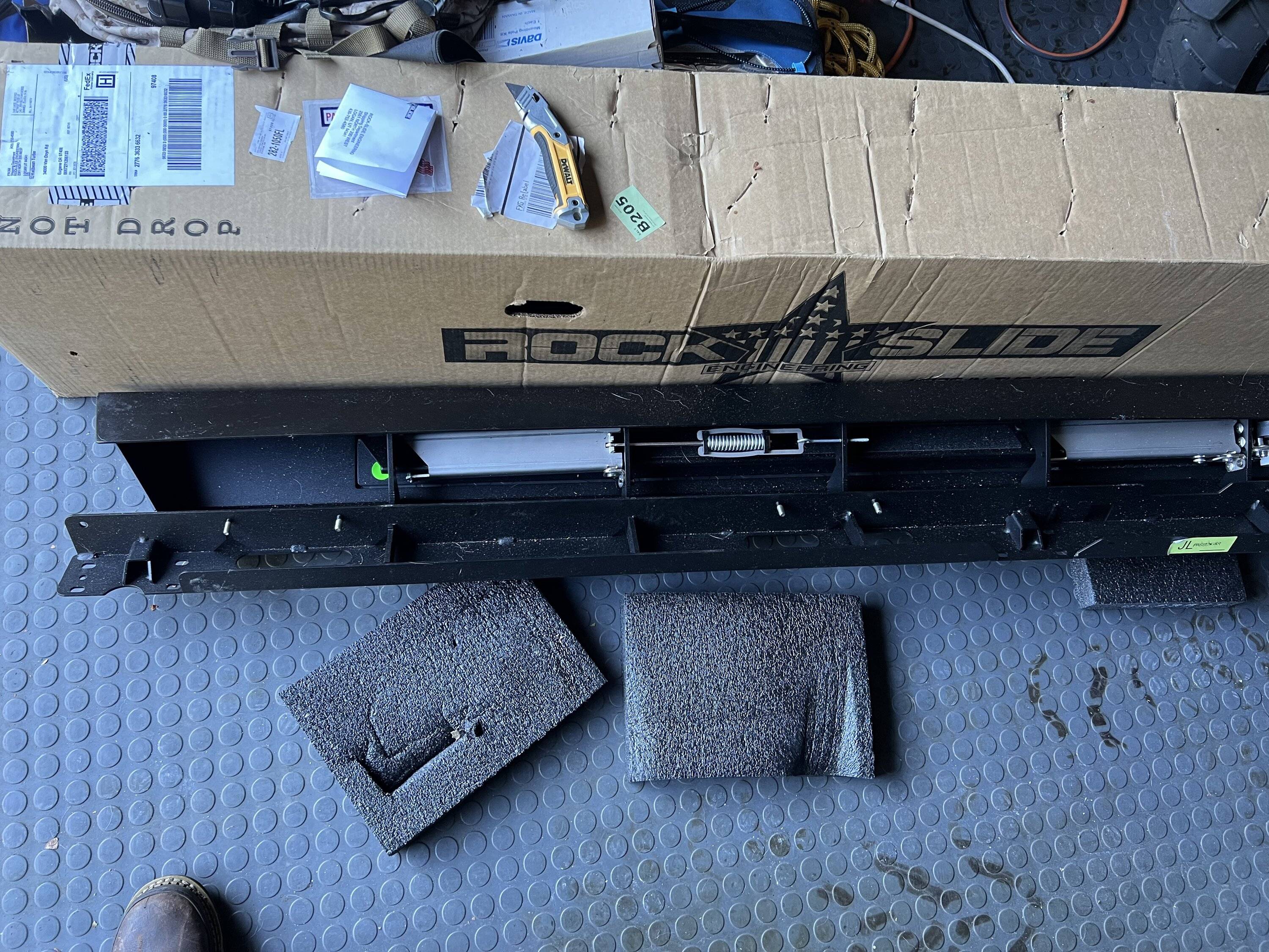

I ordered the Gen-3s with the lights, door off kit, and additional armor this summer. The boxes were deposited in my driveway by FedEx about three weeks ago, so I found them when I got home from work. Yesterday was my first chance to do the installation.
First, the box containing the armor says ā€œGen-2ā€ on it, and my steps are Gen-3, so I don’t plan to open that box unless/until I can confirm that the Gen-2 armor fits the Gen-3 steps.
Next, the driver’s side step was well packed, with multiple high-density foam collars surrounding the steps in several locations, all held in place with plastic wrapping. The box was a bit beat, but the step and bumper strap were fine. The passenger side box contained no foam collars at all. Instead, the step and the strap were loosely packed with a massive amount of brown packing paper, and nothing else. Since the step is extremely heavy, and the paper wasnā€˜t sufficient to secure it, the step and strap were able to slam back and forth during shipping. The step pulverized the box. (See photos below).

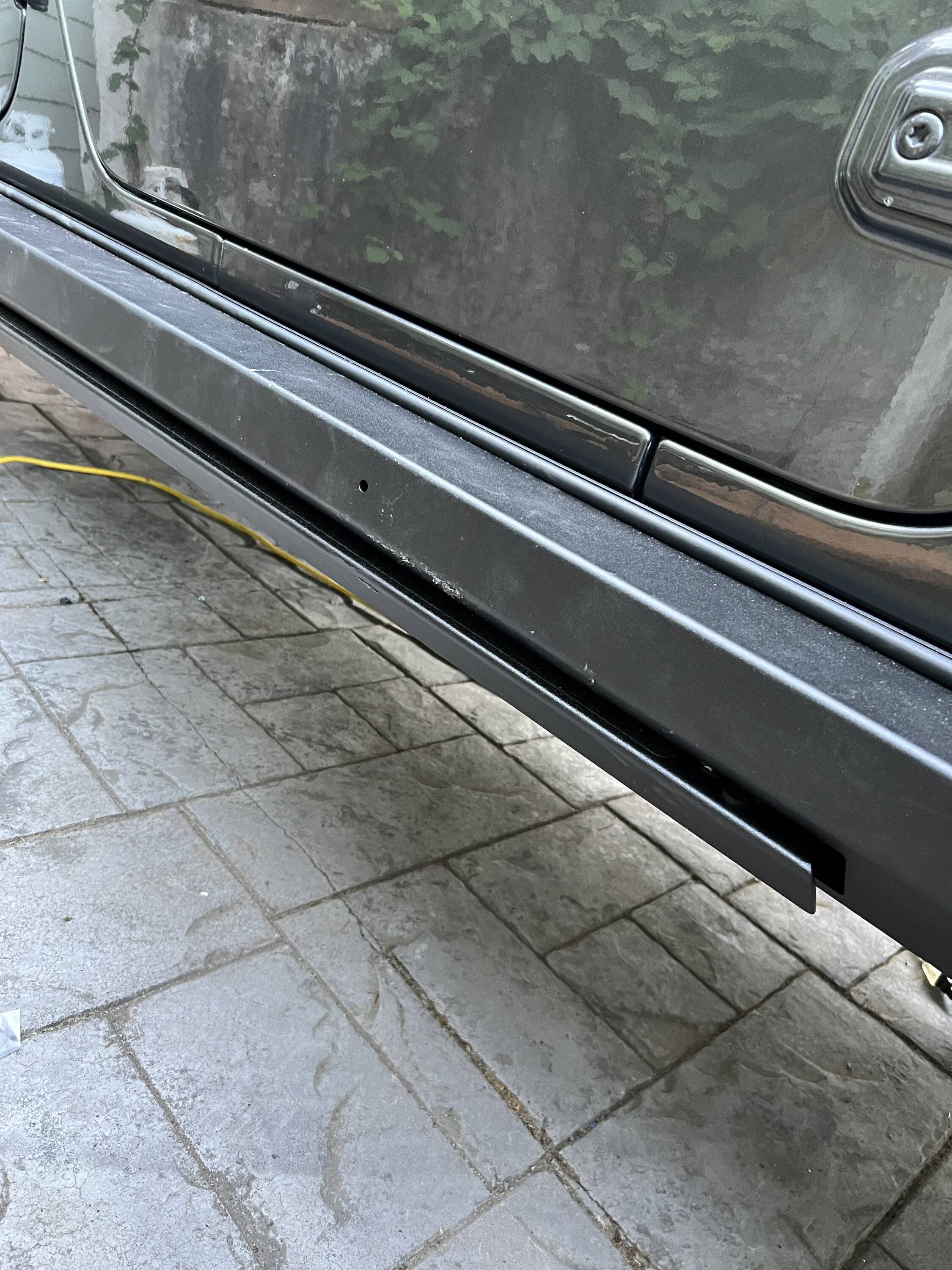

The step punched through the box, and there was some abrasion and paint loss, but returning an item that size is a HUGE pain in the ass, and I figured nothing FedEx could have done to it would equal even 5% of the abuse the step would take under the weight of the jeep, so I decided to straighten the bent strap and install the step as it was. Now, after reading this thread, I’m convinced the passenger side step was somebody else’s return…

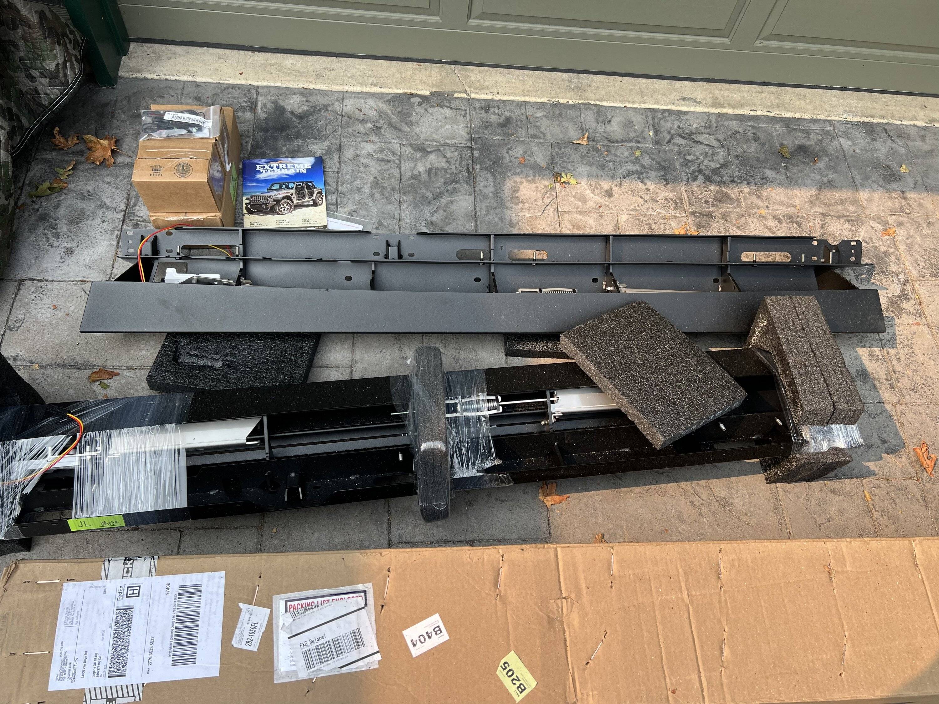

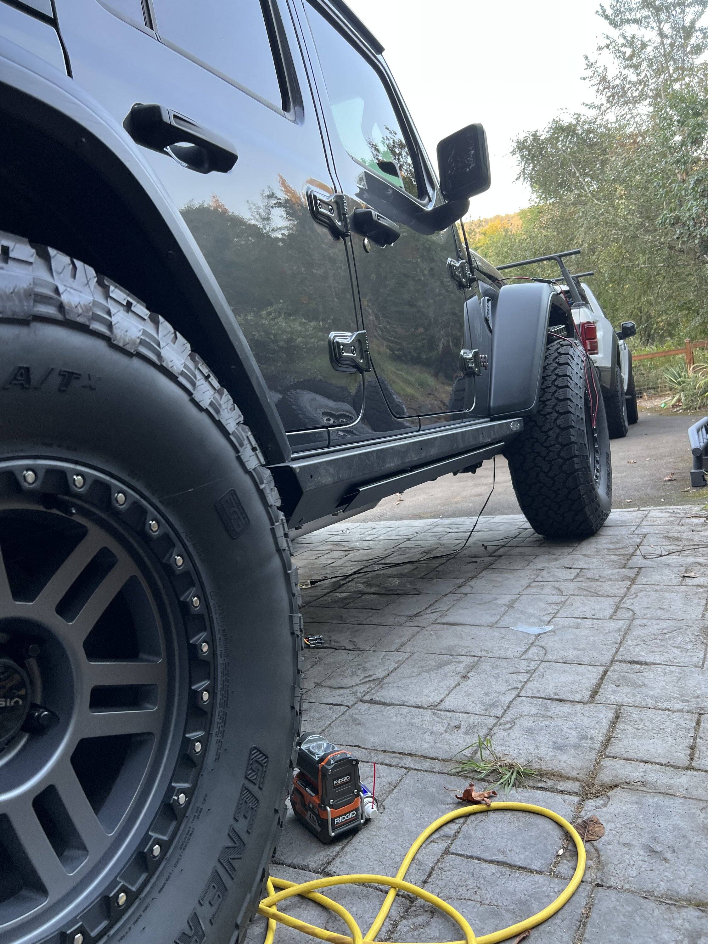

I couldn't install the wiring, as the module and wiring harness were not included, but since Iā€˜d set aside the morning to install the steps I decided to do what I could. I started with the strap repair. It took me about 40 minutes with a vice and adjustable wrenches to get the strap reasonably straight, but it’s spine was vertically stressed to an extent I couldn't fully correct… It works, but it doesn't look right, so Iā€˜m going to request a replacement strap and hope the strap adhesive is as faulty as the packing job.
The installation was a pain in the ass. There was insufficient room between the bolt-heads and the washers. No amount of prying or hammering in drivers or wedges would pry open space without striking the bolts hard enough to risk a break or bend in the bolts, so the bolts had to be fully removed and pounded in the vice to create space. There were lots of ways for that to go bad, but it worked and I eventually got the steps on. So far, so bad.
The passenger side step isn’t fully retracted. I dont know if powering it up and cycling the step will fix that, as I have no way to power it up, and no way to open the step.

Update: My RSE steps were purchased from Extreme Terrain. I used ET’s customer service chat feature to describe my situation. The customer service person asked, ā€œwould you like us to send you some new steps at no charge?ā€ I said, ā€œSureā€. They already had the photos from FedEx showing the package destruction, so they needed no further documentation from me.
I have no access to suitable packing materials for items that large and heavy, so I chose to purchase a new set, so I can use the materials that come with the new steps to ship the old ones, but so far, so good. Fingers crossed.

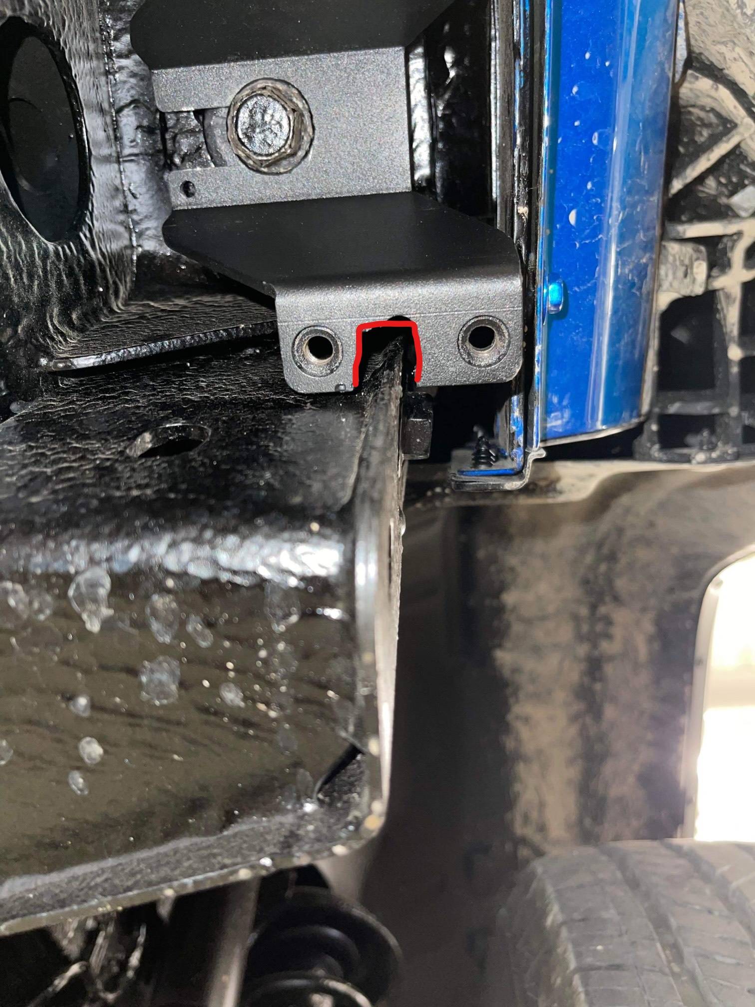

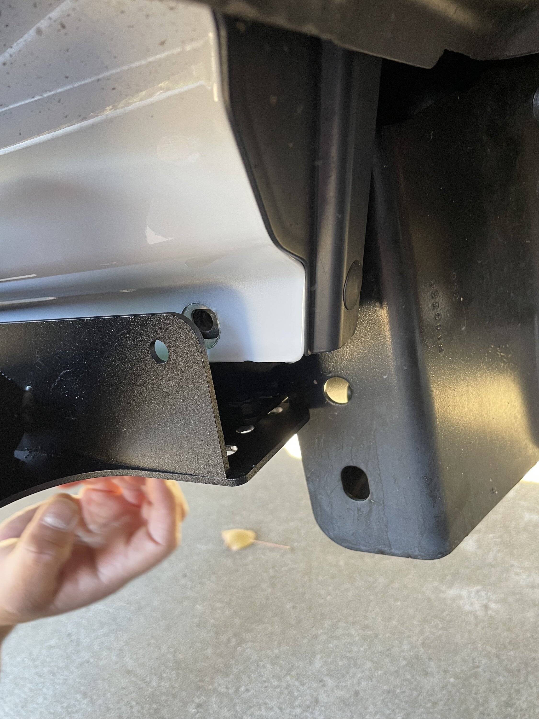

Anyone run into this issue? Not sure if I got the install wrong or what, and not sure what piece of the Jeep that’s preventing the RSE steps from installing. This is picture is of the front passenger side. Anyone with ideas or run into this? 22 JLU Rubicon XR, Gen III sliders.

Are you showing us that the holes don’t line up, or that youā€˜re unable to get the step snugged up to the jeep?
Thats the Jeep '22+ crash stop - I'm guessing that install will require a little material removed from either the step or a notch in the crash stop to install flush.
Sorry, I was attempting to show that it can’t snug up to Jeep because of the obstruction (the crash stop, I just learned).

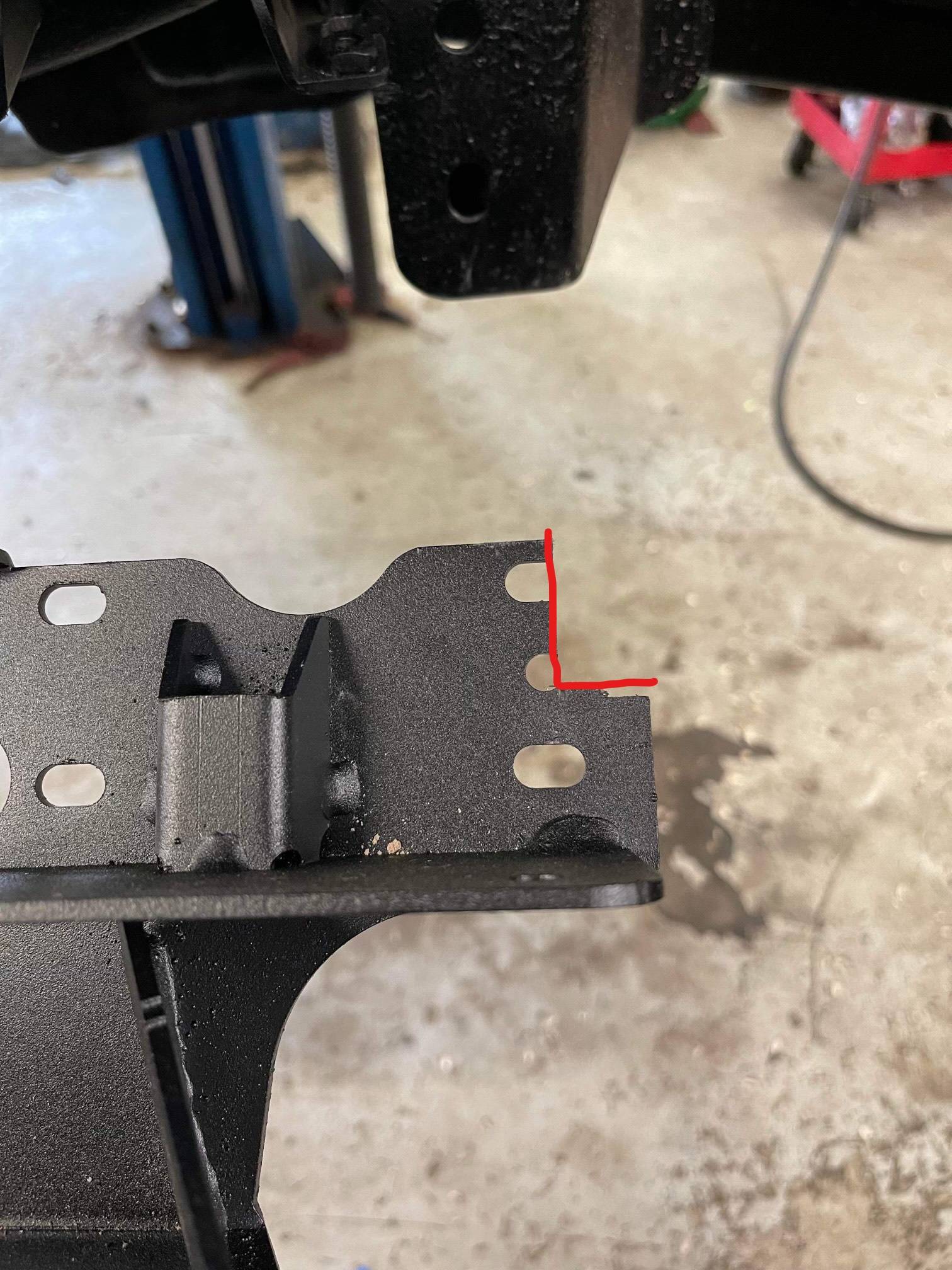

Thank you! I emailed their support, and they mentioned that they’ve made changes to design to account for the crash stop. These are the photos of the cuts I’ll need to make on the older design:
Good deal... my '21 doesn't have that but knew that new brace was going to cause problems for some of the rail/step install options. Glad it will work out.
Gotcha. Your picture made perfect sense after somebody else pointed it out to me. I was a little slow on the uptake.
