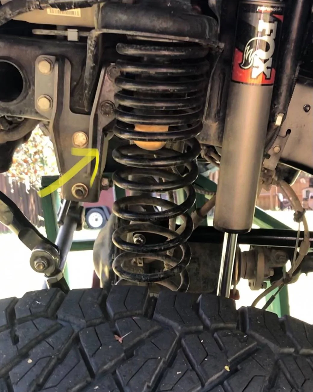

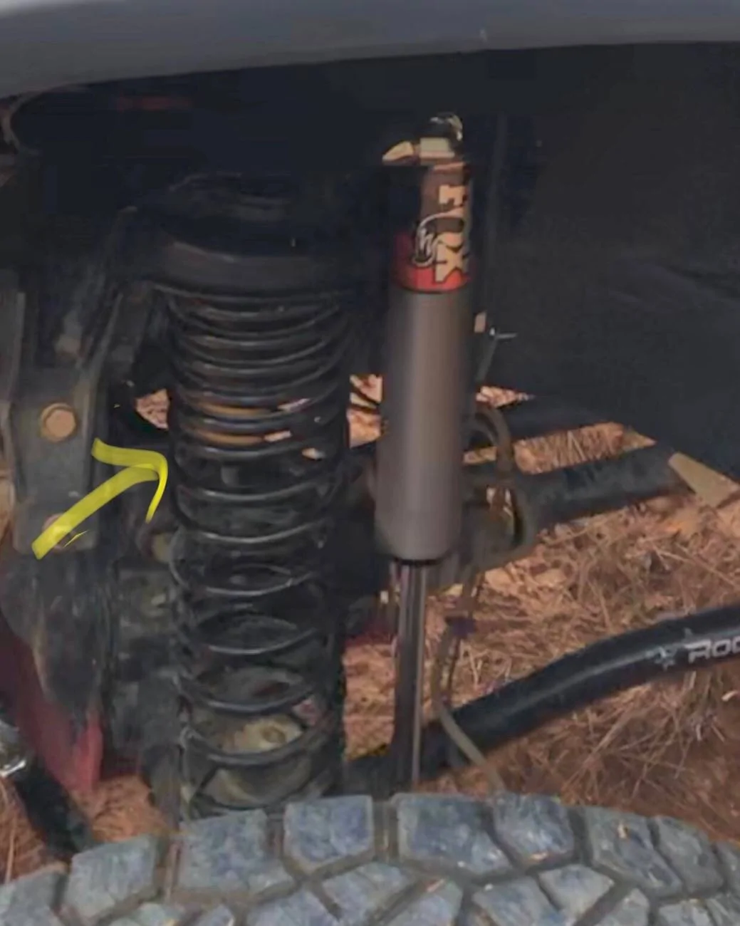

The long arm does not flex more than the short arm, the shocks are the limiting factor in articulation when comparing apples to apples (RK with RK)....In fact, some LA kits will hinder articulation in certain situations, (low hanging fruit), especially on lower lift rigs on smaller tires than 40s. Experience and 40s make running LA a non issue, and IMO, a no brainer…
What makes the LA better is that it articulates better, smoother, and quieter less binding at full flex….Also, the on road feel is smoother, more planted/stable…..when off road there’s no rear steer, or crab walking over obstacles…
Here’s examples:
Look at the white upper bump:
short arm
Jeep Wrangler JL Rock Krawler IMG_8171
long arm
Jeep Wrangler JL Rock Krawler IMG_8170

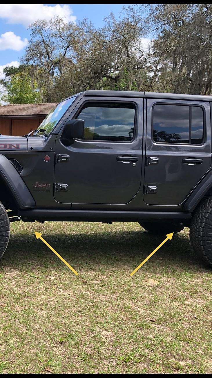

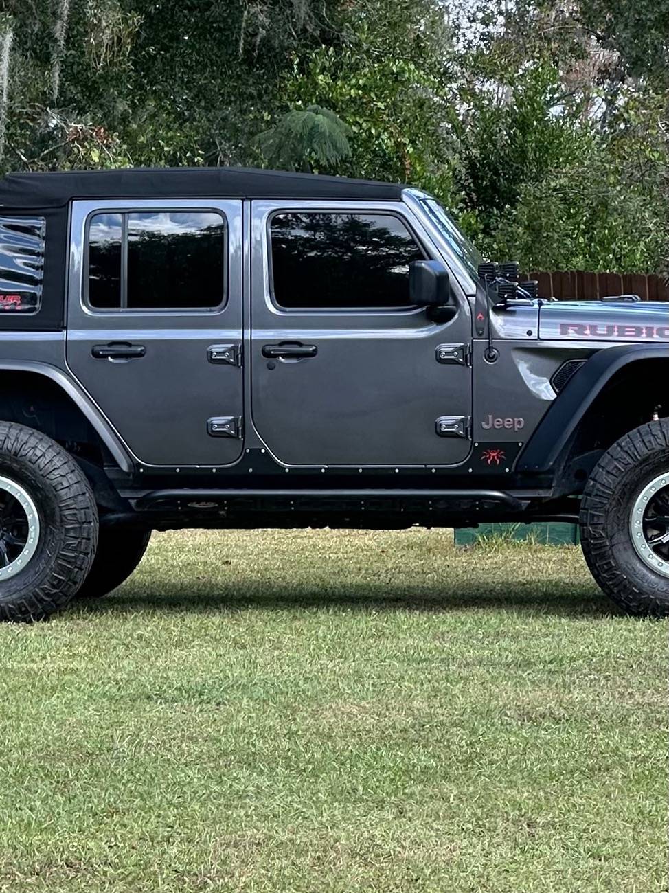

In my case, I didn’t want to run any larger tires than 38s (currently on 37s) on the D44s but I wanted to have as much articulation and ground clearance as possible on 3.5” lift….This is where RK shines above all the rest…..Their approach to ground clearance is exactly what I wanted….
Here’s pic of the difference:
Short:
Jeep Wrangler JL Rock Krawler IMG_8767
long:
Jeep Wrangler JL Rock Krawler IMG_0350
