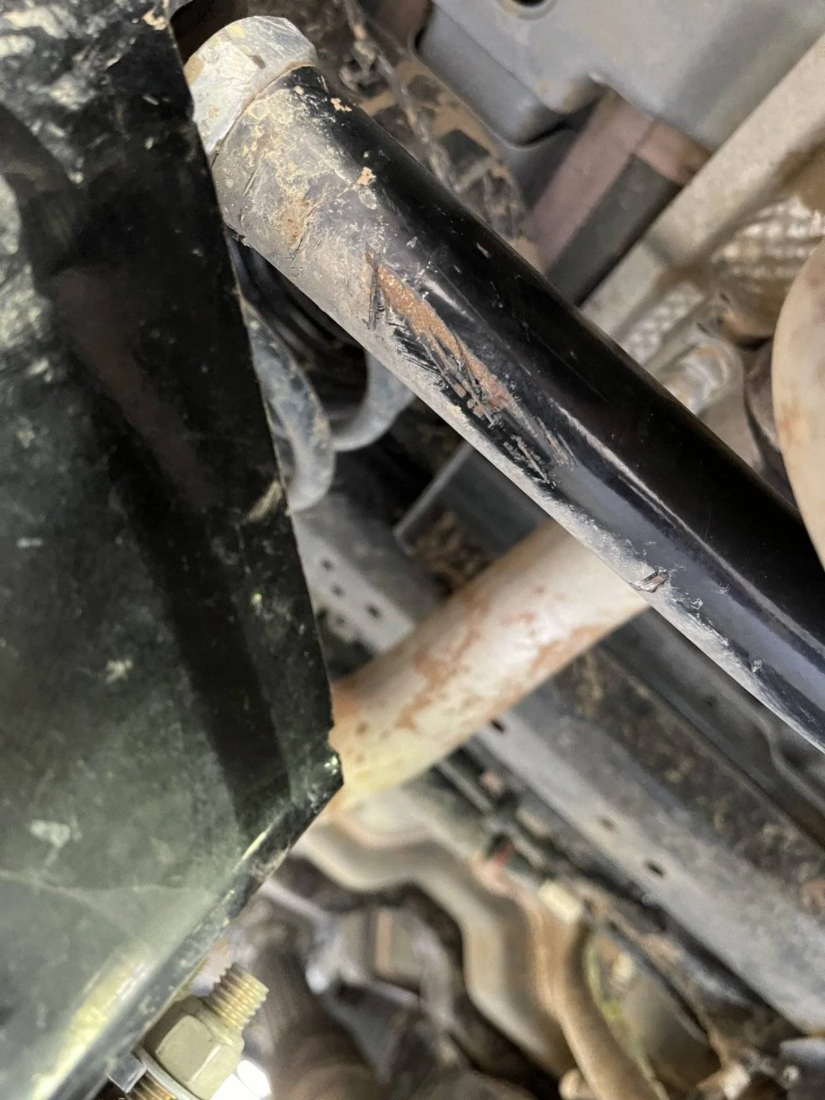

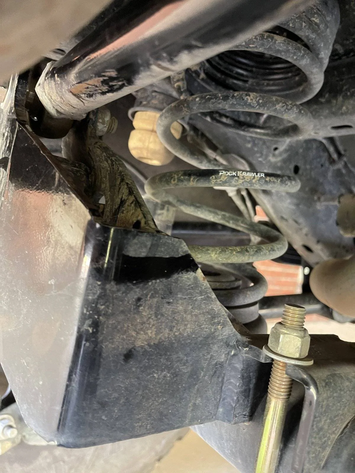

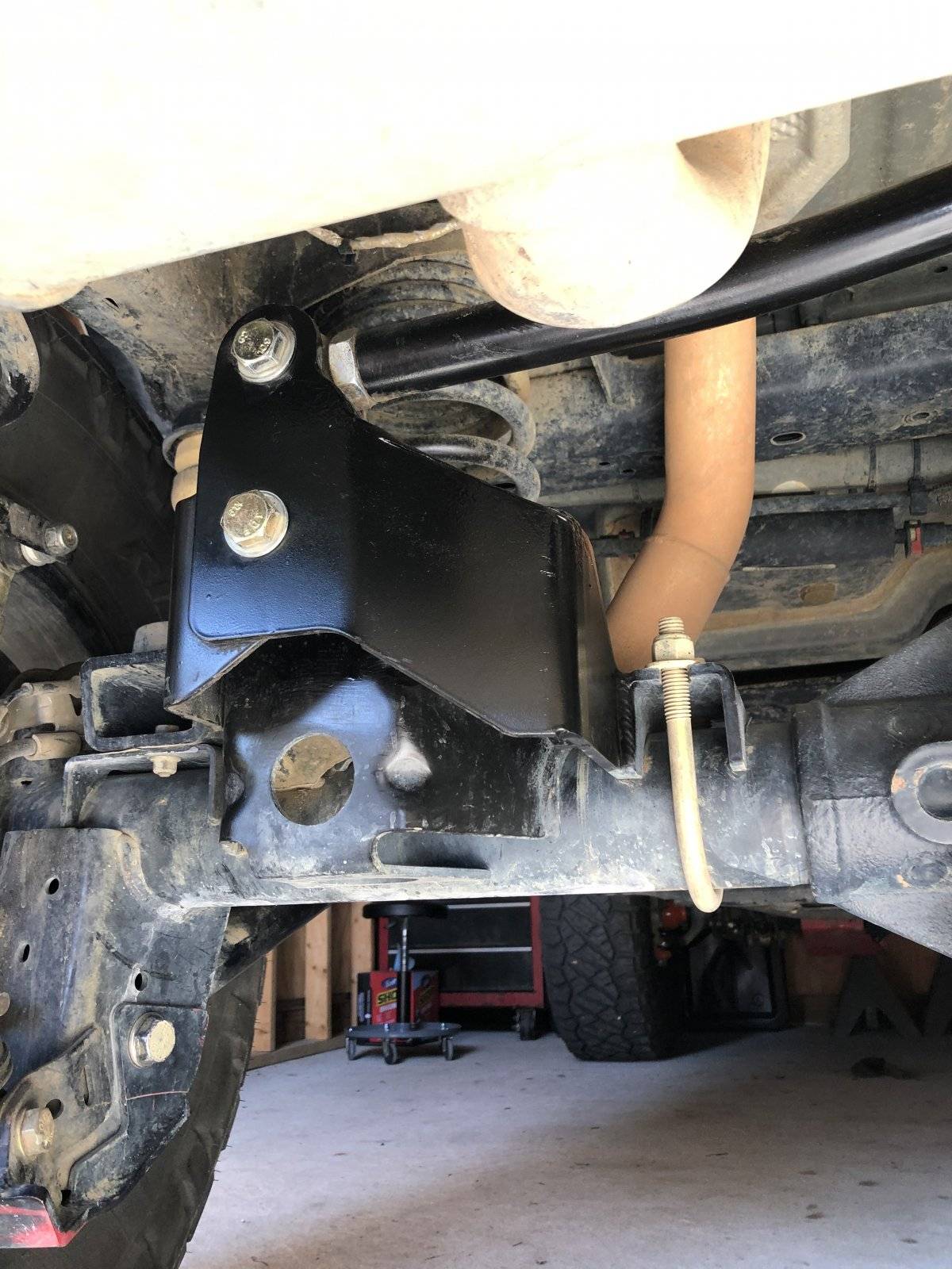

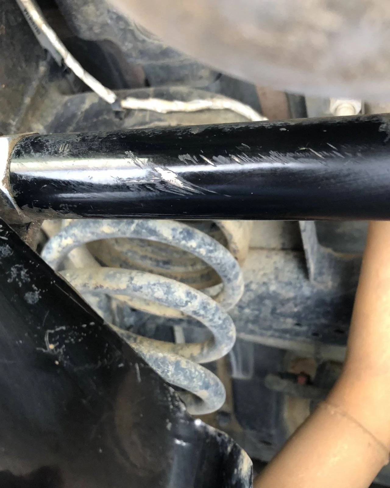

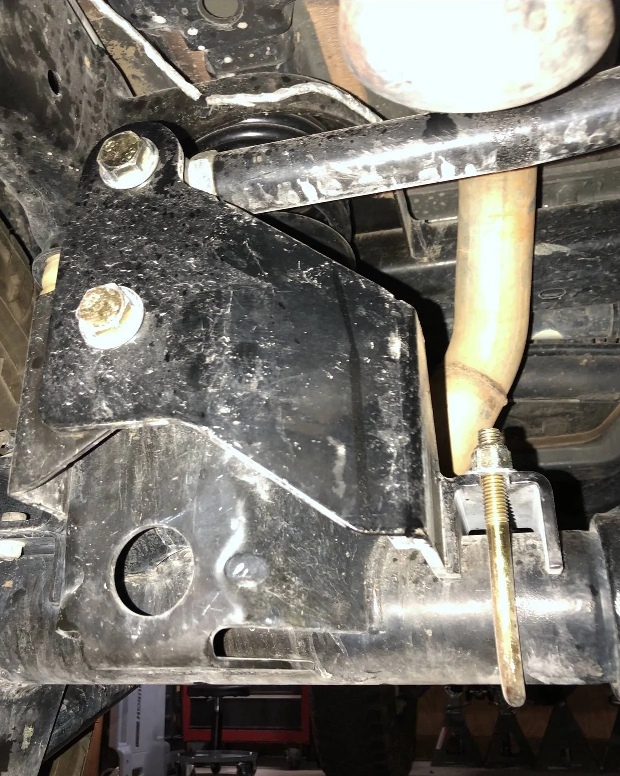

Got it done, not perfect but it’ll do.....?
before ....

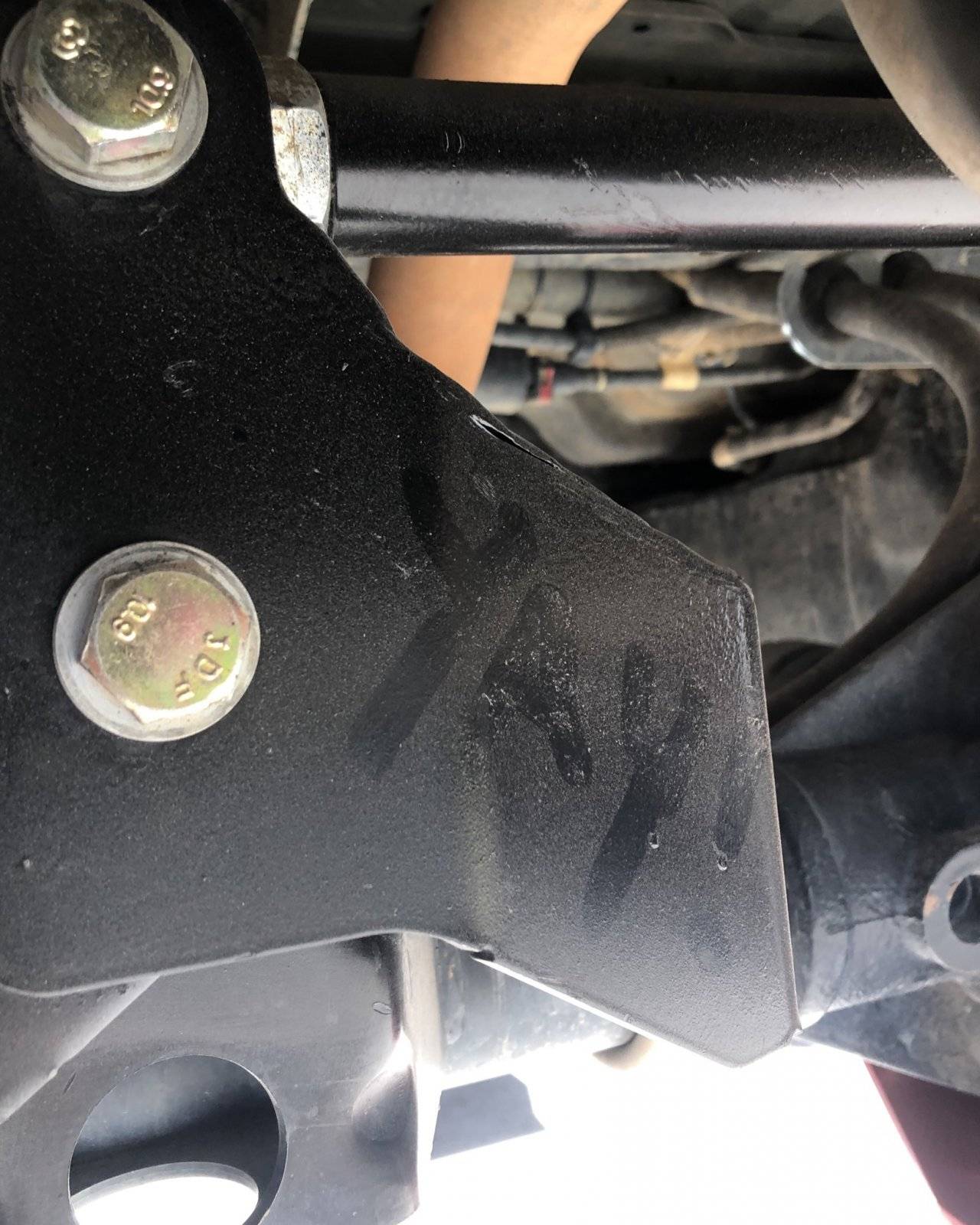

after.....
Looks good. Not sure where the “not perfect” statement coming from. That looks how they should have made it to begin with. Even touched up paint in TB. :like:

Thanks, yeah I thought I’d paint the track bar to make sure it’s cleared. I couldn’t get it to hit no matter how I flexed it, so it’s hitting when both wheels are stuffing, through whoops, and washboards and the like. So I just guessed on how much to do, hopefully it’s enough...?

Took it out and flexed it out pretty good, track bar never hit...:clap: .... I really didn’t want to cut it again.....:whew:.
Glad that did it. Plus has a new shiny coat of paint. Also - I see you used your finger again LOL

Did you cut both sides for clearance or just the bumper side?
