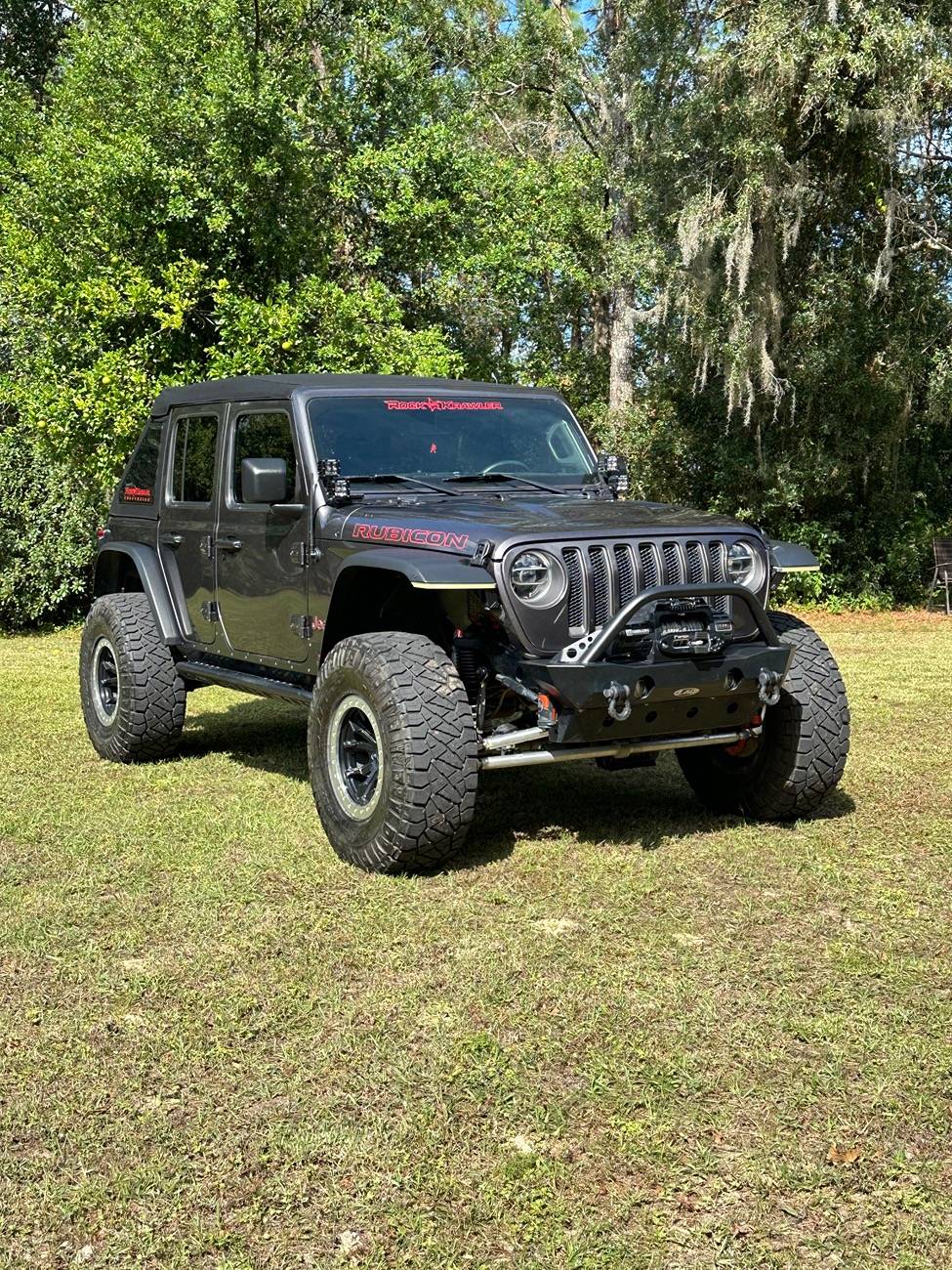

The RK springs handle weight pretty well… my 6 year old springs for every 100 lbs, they drop 3/8” ish…. I’m not familiar with that bumper, but with my LOD bumper & winch I needed a 1/2” spacer…. No spacers needed in the rear with heavy 37 on beadlock spare….she sits pretty level….

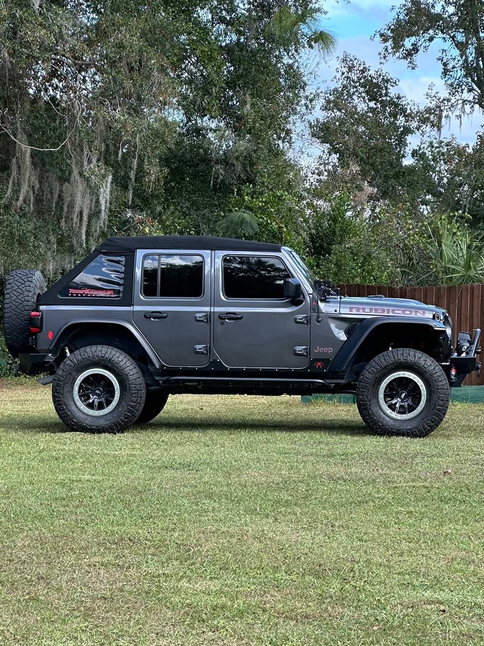

Do you still have a slight rake in the front, or is it just the angle of the ground? If it still has some rake I may need to go with a 3/4 inch front spacer.

There’s no rake, here’s different angle….
